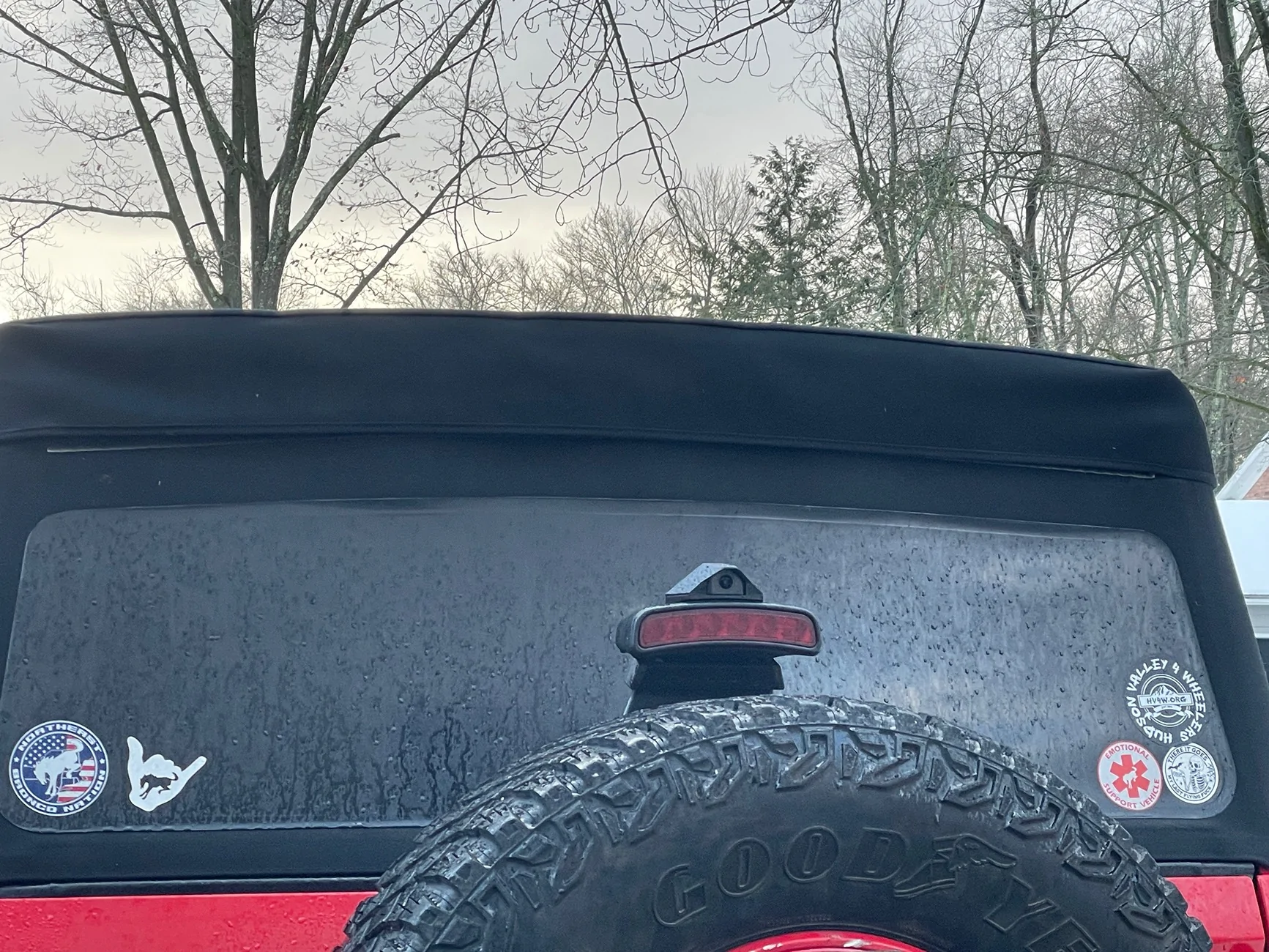

That's an interesting mount, but unfortunately the 3rd brake light shakes quite a bit. Every little bump and the camera is all over the place. It drove me nuts, which is why I mounted it inside my wheel.

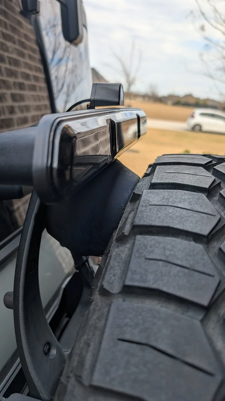

I have the same problem. I shoved a dog toy between the bracket and the tire with the intention of going back with a permanent solution...that was 2 years ago. 🤦‍♂️

At one point I had a foam block in there which helped a little. Eventually just put it inside the spare.

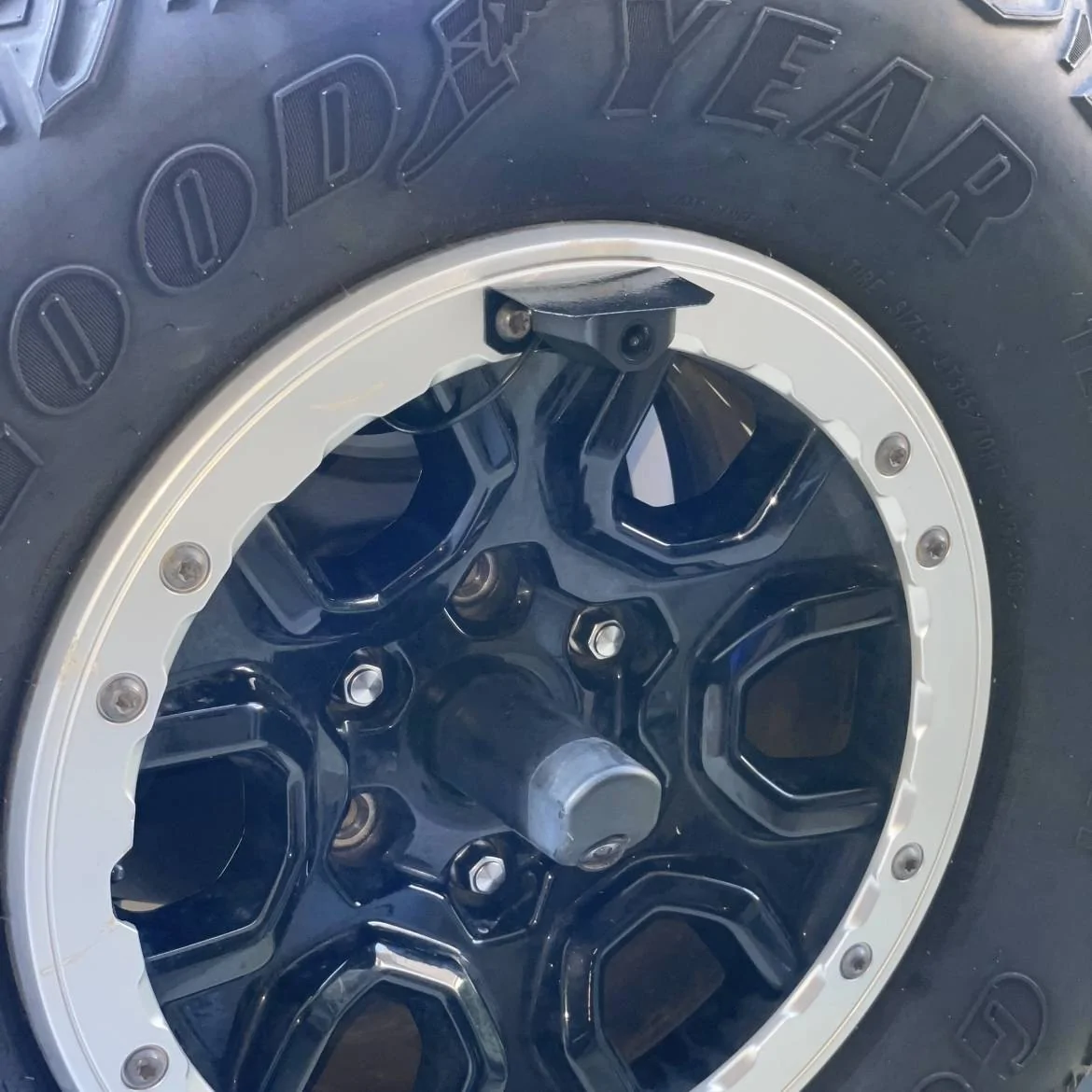

Brake light was too much vibration for me, so I used some thin metal to make a simple mount attached to the beauty ring bolts. I like this for the wide angle helping with blind spot vs tucking it between wheel spokes.
