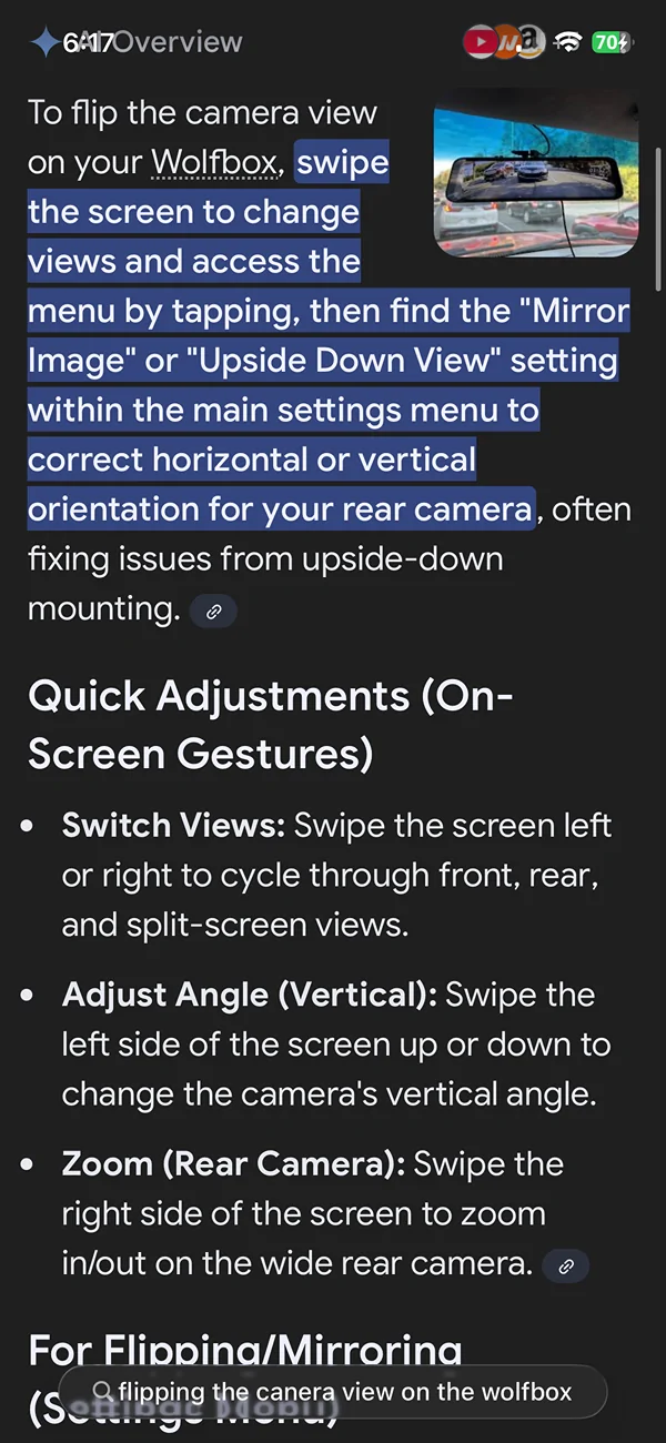

Yes you can flip the view if mounting upside down
You can flip the live camera feed but for some inexplainable reason they will not flip the recorded version so your recorded video will show upside down. And if you flip it the time stamp is upside down. I confirmed this through Wolfbox and they said basically, wow, yeah...
