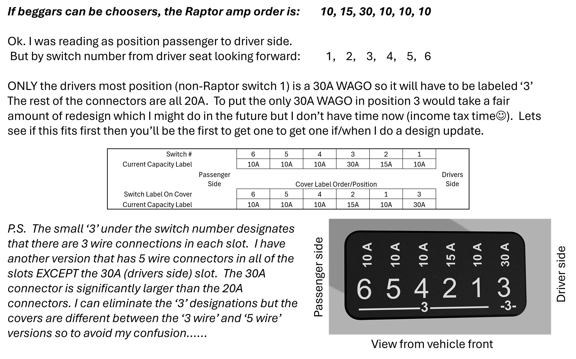

Picture of the order. Only the 1st slot is a 30A WAGO, the rest are 20A
Hmmm, not sure we're on the same page here...
The order I listed is different comparing the Raptor and non Raptor. Those I listed above are in numerical order from switch #1 to switch #6 (also drivers side to passengers side) as to the capacity and fuse size of each switch/circuit. So for example switch #3 is fused & rated at 30 A.
If you are printing in two colors, I was asking (looking the gift horse in the mouth, technically 🤣) if you could make the numbers and amp labels match the Raptor.
Just to clarify, my comments have nothing to do with the size/capacity of the Wagos. I would just assume they are sized to match. If for some packaging/design reason the number labels on the junction box are not in numerical order, no problem.
Dirtrider
Bruce
Sep 29, 2021
186
147
St. Louis
Honda Ridgeline, Super-C Motorhome
Hopefully this comes through OK. The only 30A WAGO is in the drivers most slot. The rest are all 20A capable. I totally misinterpreted your numbering, I took it as position on the cover (left to right, switch 6 to 1). See if the picture explains it and is correct as far as switch number labeling and switch current. They aren't sequential drivers side to passenger side but the best I can do right now.
Weird that Ford would change the current capacity/order on the Raptor (maybe not so weird). I actually have my lights wired with the least offensive on the left to most offensive on the right (except that the accent lights are the rightmost).
If this is OK, can you send me a direct message with your mailing address and perhaps your e-mail address?

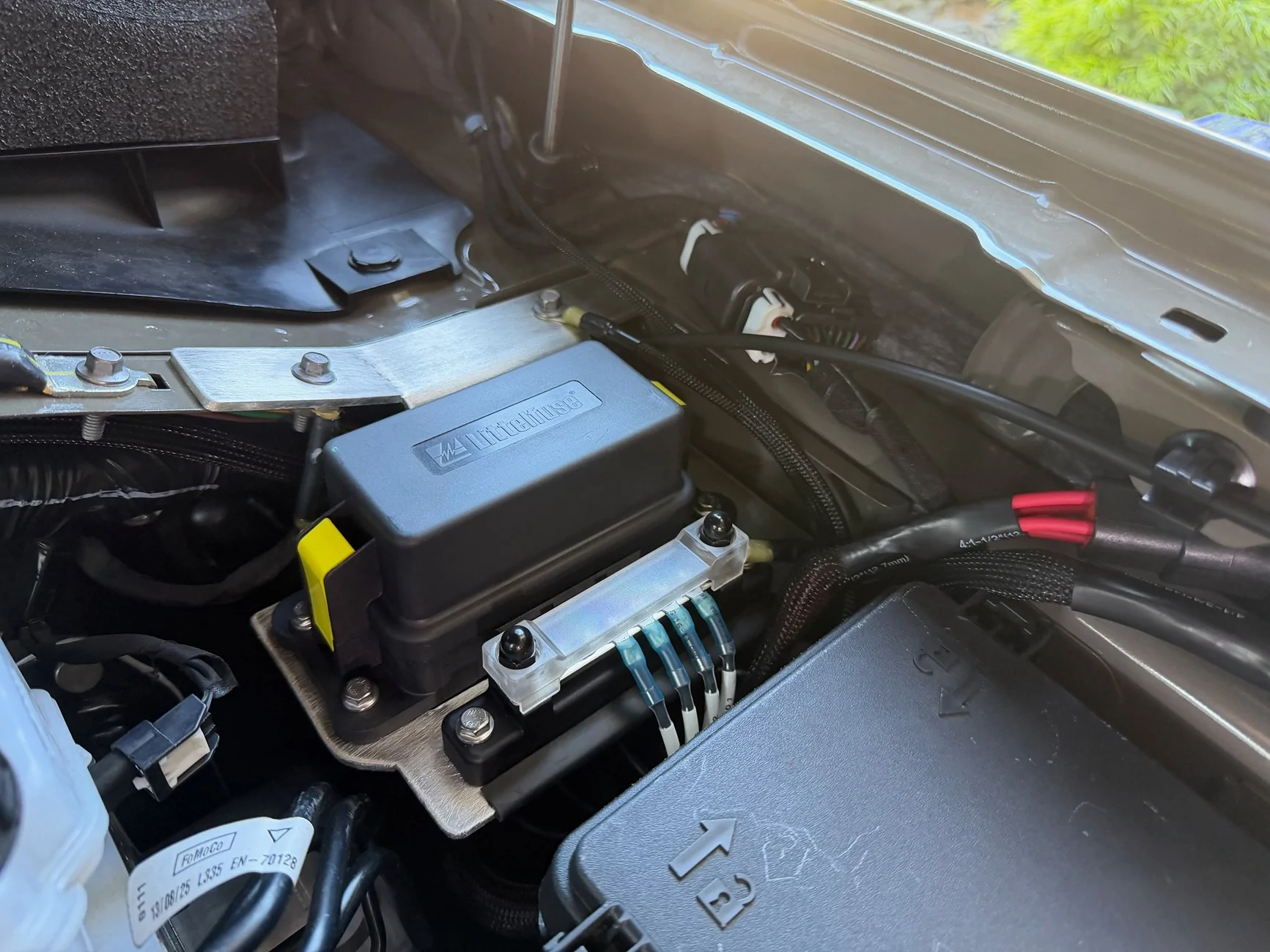

Stillwater35
Jan 3, 2026
73
169
Stillwater MN
25 Green Badlands Sasquatch

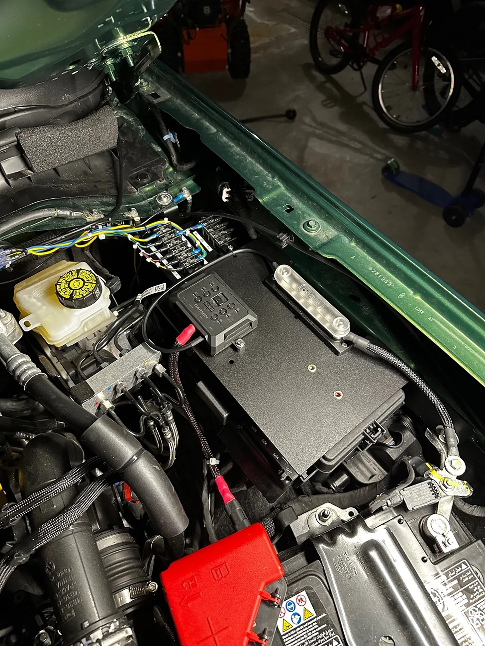

I did finally get the Genesis Off-road panel installed. Liking where I’m at now and also put in two rivnuts to secure relays in the future.
Ford Bronco Wire management tips/suggestions? IMG_5598

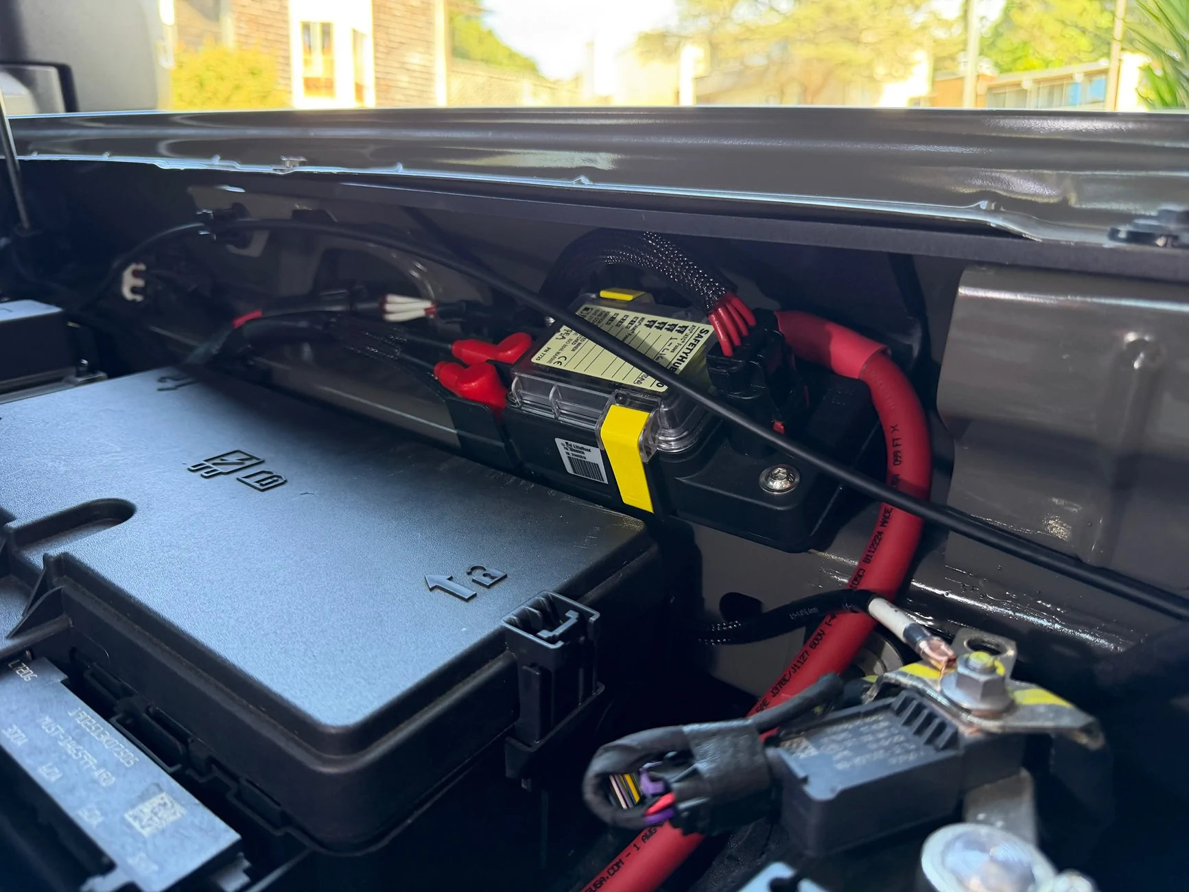

swamp2
Dec 19, 2022
156
4,161
4,296
Finally got @Dirtriders custom (Raptor) upfitter jbox installed. It's a nice, functional and well designed solution. Great attention to detail. Although my wiriing isn't exactly the cleanest, it's all safe/secured/sheathed/etc.
Ford Bronco Wire management tips/suggestions? PXL_20260315_014413789

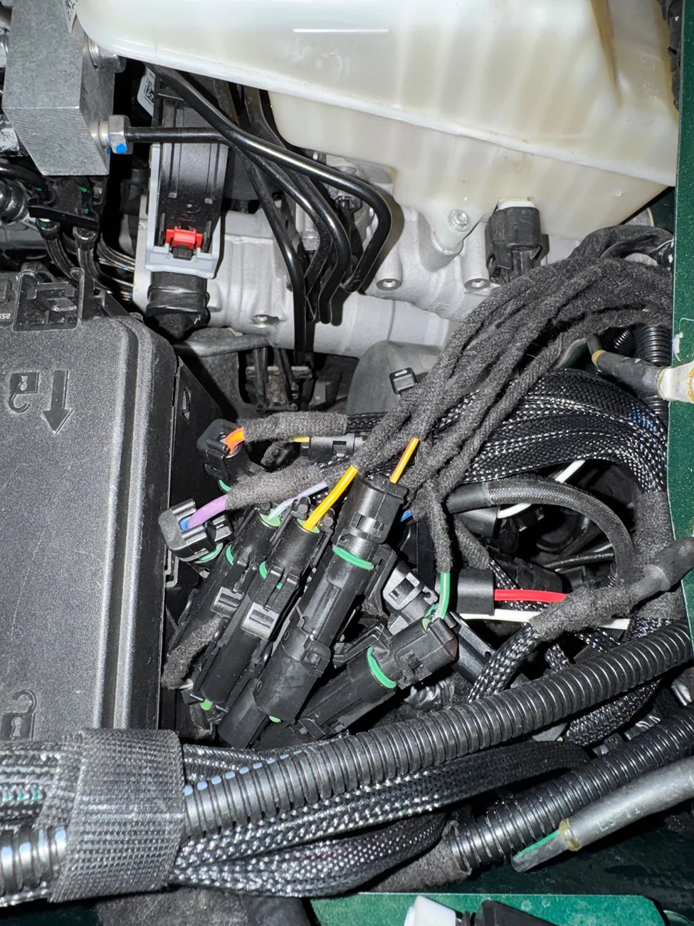

Prior, I had used some single pin Deutsch connectors to have the same quick change feature I now have in a much cleaner way. There wasn't really any good way to keep this prior "rats nest" tidy. Here is all the crap I got rid of.

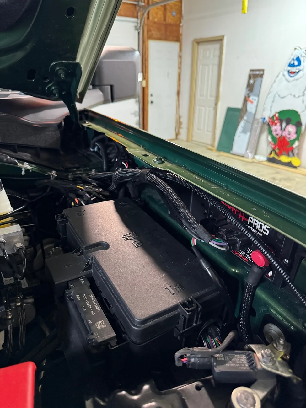

Squirrel13
Brad
Sep 24, 2023
272
440
KY
I feel your pain but having everything weatherpak’d make it so easy to switch things around. I terminated the switchpro harness and this is the result.
Ford Bronco Wire management tips/suggestions? IMG_4421
Ford Bronco Wire management tips/suggestions? IMG_4422
