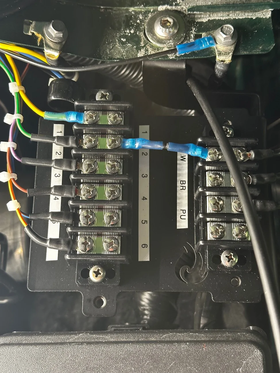

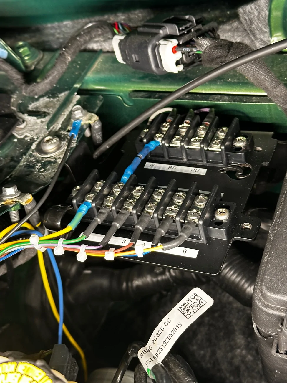

I have the blaze bracket. 2 bus bars , one for six and one for the unpowered wires.
I also like to use rubberized hose routing clamps as they give soft circles to run wires through and on.

Thanks - I really didn't want to have to look up what color belongs to what up fitter anymore. I guess this solves that problem. I have the Genesis Offroad plate coming for over the fuse box and that's where a ground bar and Garmin power switch are going to go.

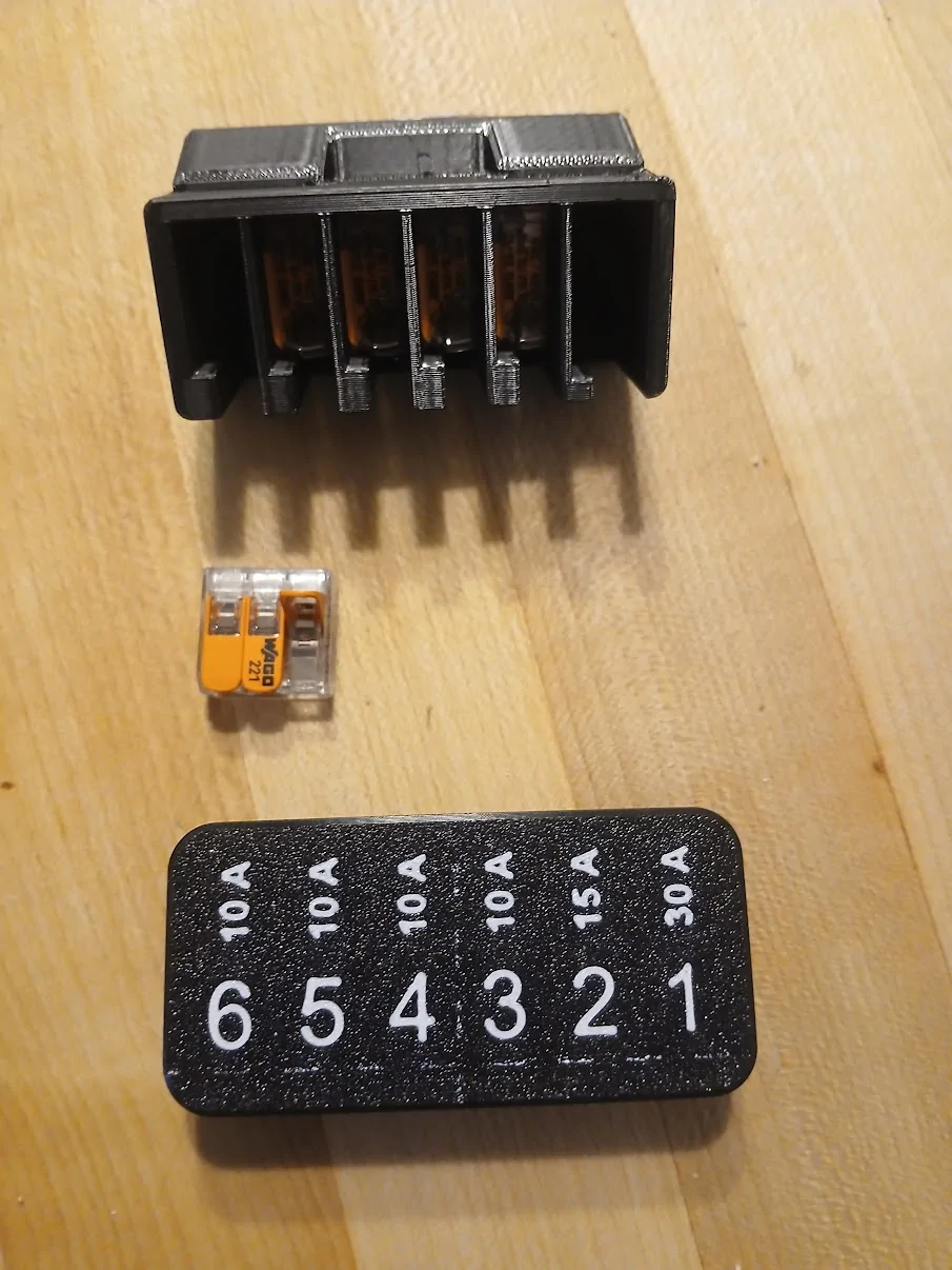

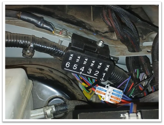

I currently have four light pods on my bumper, and four light pods on my a pillars (two on each side). While I feel like I've done a decent job routing the wires over to the up fitter switch wires in the engine bay, but I currently have what looks like a rat's nest of wires in that area. This is mainly due to the wiring harnesses being longer than necessary, but I don't really want to cut and shorten them. I was wondering if anyone here had any tips or suggestions on how they've organized their wiring. Right now I have everything bundled as much as possible and zip tied, but it still doesn't look pretty.
I make a Junction Box for the Upfitter Switch Connections. It uses WAGO 20A lever connectors for switches 2-6 and a 30A for Switch 1. I mounted to an unused ground wire Rivnut (apparently used on Lux package unfortunately) so I'm working on a version that mounts using the 'racetrack' hole to the right. Still a bit in development but I've been using it for several months.
Some folks don't like wagos on automotive applications, but I think this is well done, and I admit to using them all over the place (wrapped in tape to keep the levers locked)

These are well protected and the levers can't open when in the slots. I used the exposed lever connectors (4 into 2 orange and blue in the picture) because I cut the wires too short when I initially wired it and before I made the junction box. (I hated the rats nest, that's why I designed the junction box) I've just been too lazy to extend the wires directly to the Junction box and get rid of the 4 into 2 lever connectors. I made two models of the junction box, one that has 3 wire WAGOs for switches 2-6 and one that has 5 wire WAGOs for switches 2-6. Both have 3 wire, 30A WAGOs for Switch 1.
I used Wagos on the Engineered Off Road Systems Potable Water System. I read up on them significantly especially the vibration testing and it's thorough and convincing that they can take the abuse and be reliable.
