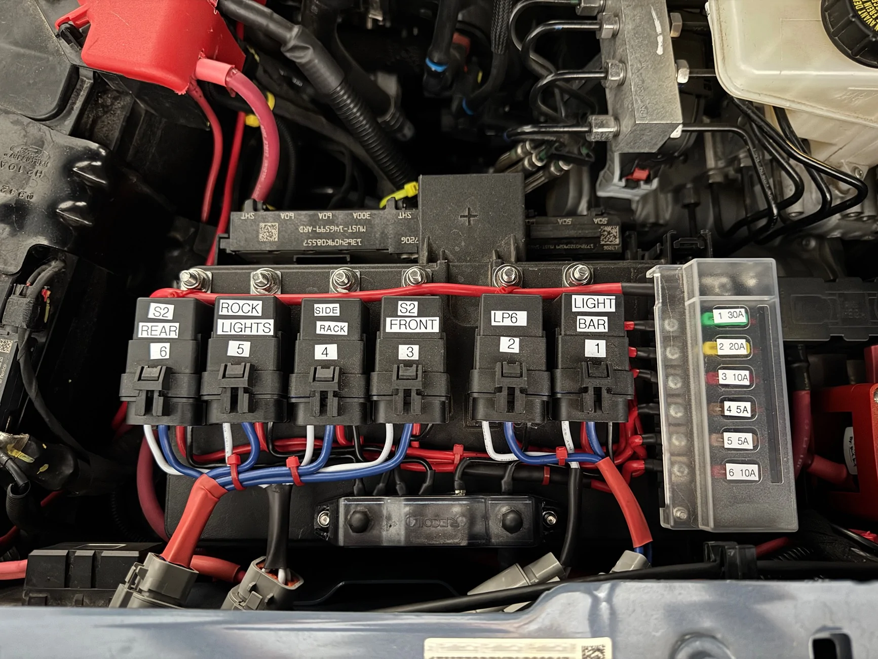

1: there is a nice big empty pocket in the fender by the fuse box for tucking wire bundles out of sight
2: better to have extra length if you ever need to redo things
3: quick disconnects are a wonderful thing. I have one for my bumper lights and I wired it up to sit right next to the oem harness quick disconnect on the bumpers so it would be easy to find when I need to drop the bumper
4: wire labels! Trust me this will be a lifesaver later on. All the black and red wires start to look the same after a few months and having labels (or different colored wires) will make trouble shooting so much easier if a light fails or you’re redoing your wires
if you want to go full ocd, you could build a relay and fuse board like I did. I only needed one relay but I was bored
