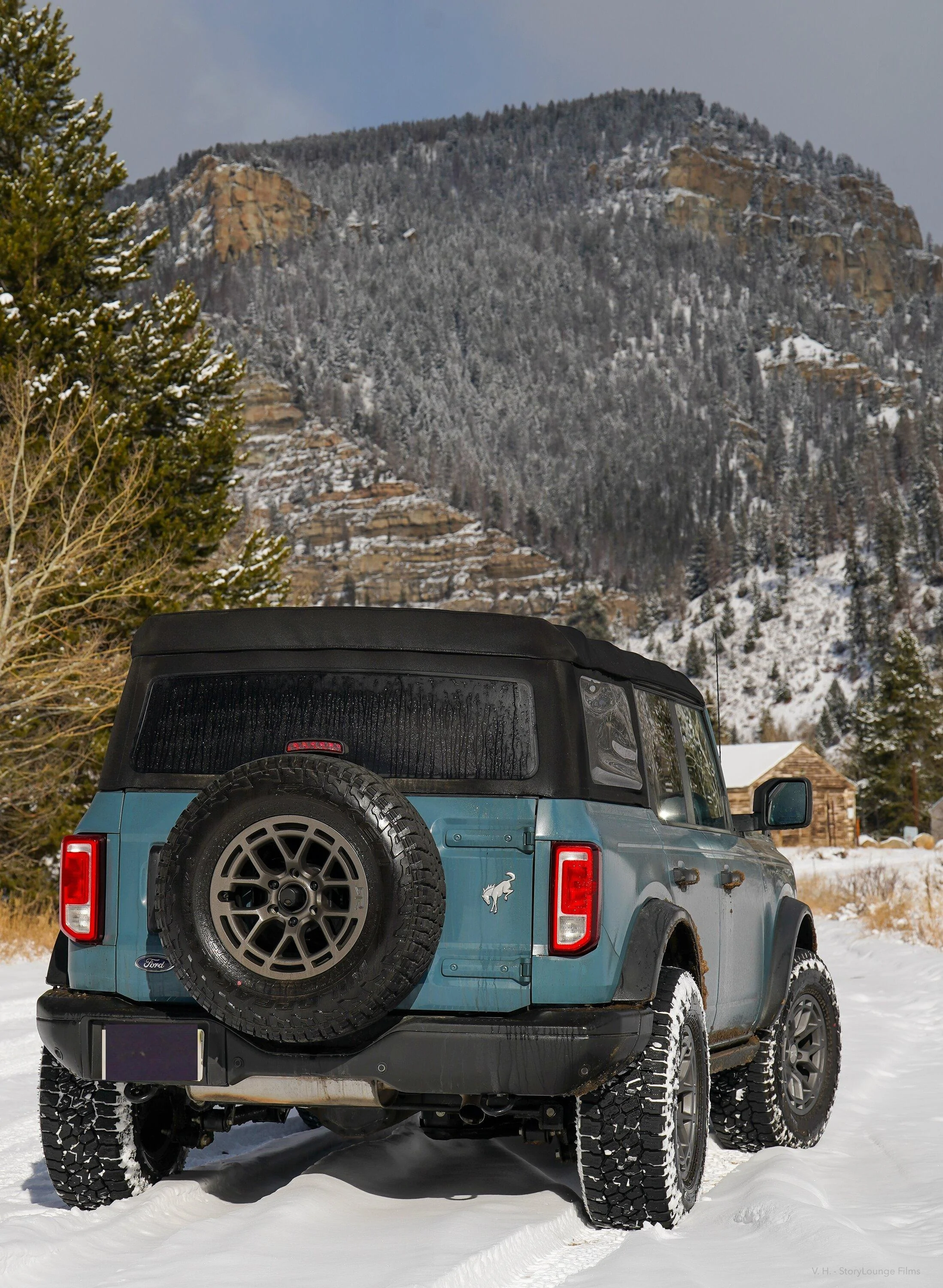

We have about 62k flawless miles driving snowy and icy roads daily in Colorado during the winter. We change Tranny and transfer case fluids every 7K
Here are some "How we Roll" insights and habits. We have had zero Transfer or transmission issues. Caveat, we do quite a bit of off-road trail driving on crusty mountain roads for work, but never heavy rock crawling. Most of our 4-Wheeling is on dirt and mountain roads with nominally steep grades but we do venture onto quite a few snowy mountain and ranch roads so we use the full range of GOAT and 2H/4H combinations daily.
4H GOAT Slippery is our go to on generally icy and snowy pavement above 40-60MPH
2H When we are on Dry Pavement
2H GOAT Slippery on variable pavement with icy patches has been an excellent go to.
We always keep a finger near ready to tap the 4H button.
Dont be afraid to play the GOAT modes like a piano. The road is a symphony.
Sometimes it's quiet interlude and sometimes it will try to kill you with cowbells and cymbals.
The buttons and dial are there for a reason and work pretty well when used appropriately.
Us Old folk off-roaders from the days of early Bronco's and CJ's are familiar with the routine.
As multiple previous posters have indicated, without 4A, never run 4H on Dry Pavement.
Non-4A equipped Bronco 6Gs function like classic old school 4WD vehicles.
Only difference is you don't have to get out and lock the hubs
4H is meant to be used solely in low traction environments.
Previous posters are also correct that use of 4H in high-traction environments will lead to excessive binding of transfer case and axles, guaranteed to deliver your 6G to the medic.
No Slippy/No Sloppy/No 4H
