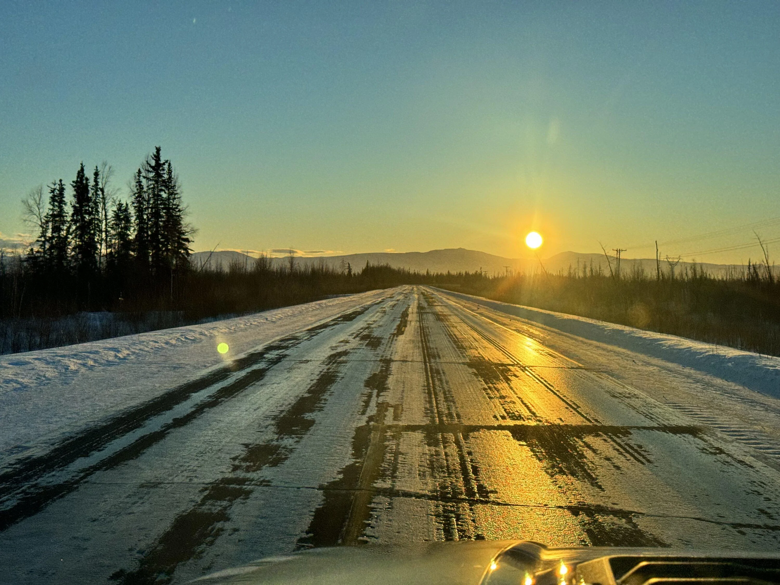

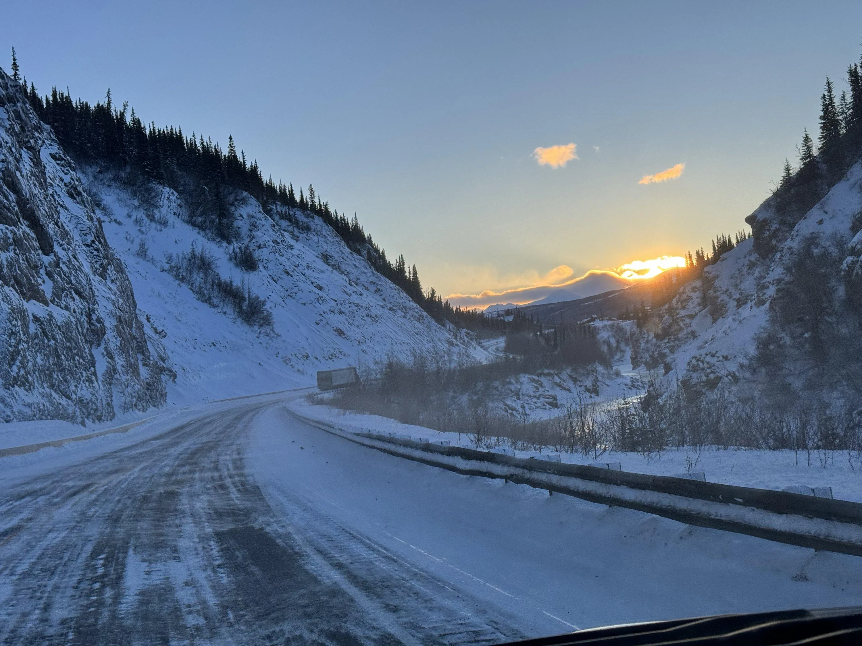

In the conditions you are showing I would agree use 4H... there is enough slippage to create differentiation. on dry pavement you are dead wrong!
On dry pavement you are forcing the differentiation to happen between fully engaged clutches!
The OP said………
“What best mode for high way driving at speed of 45 to 55 highway in snow is 4 wheel high good I don’t have 4 wheel automatic”
Since the OP said “in snow” I’d say the road is no longer dry as there in now a layer of contamination on the road. So 4A or 4H.
If NO snow and roads are dry, bare pavement , and no black ice…………… right on 2H.
And I’d take it the OP is referring to a new mostly stock Bronco without a solid axel or lockers on.
