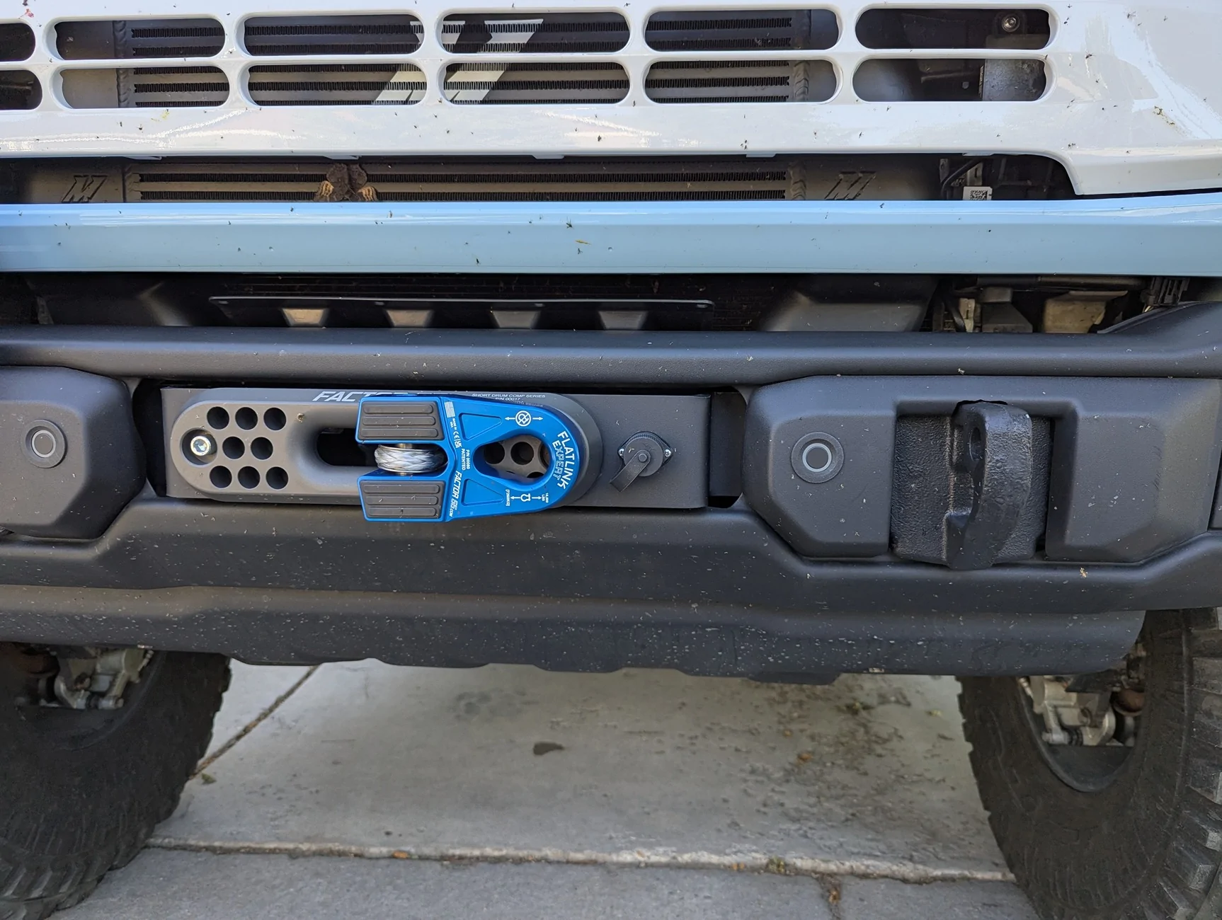

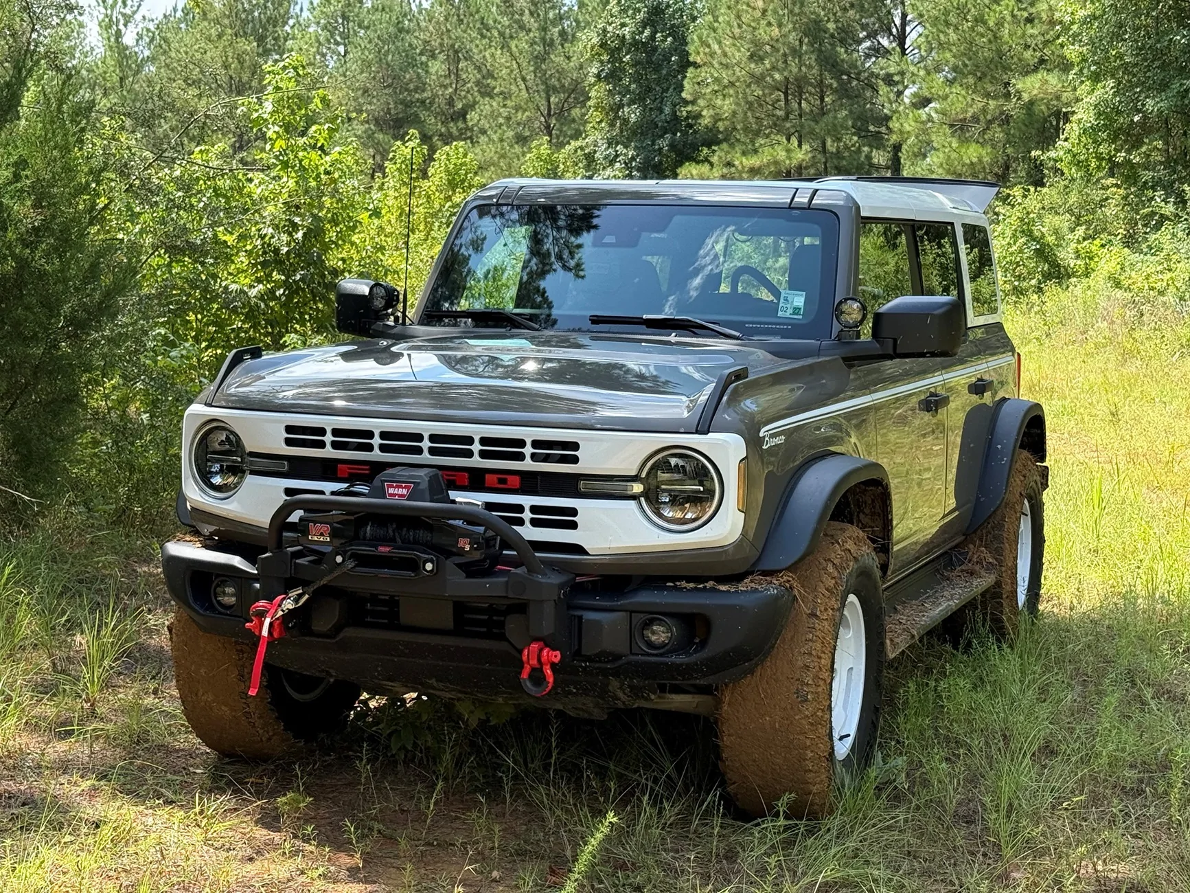

I did the Buckle-up Offroad Winch Mount with a Warn 10K EVO. Very easy to install.
Ford Bronco Winch recommendations for capable bumper Bronco Winch 8-8-26
One of the best looking options I've seen. Puts it in a decent spot where it's not going to get damaged.

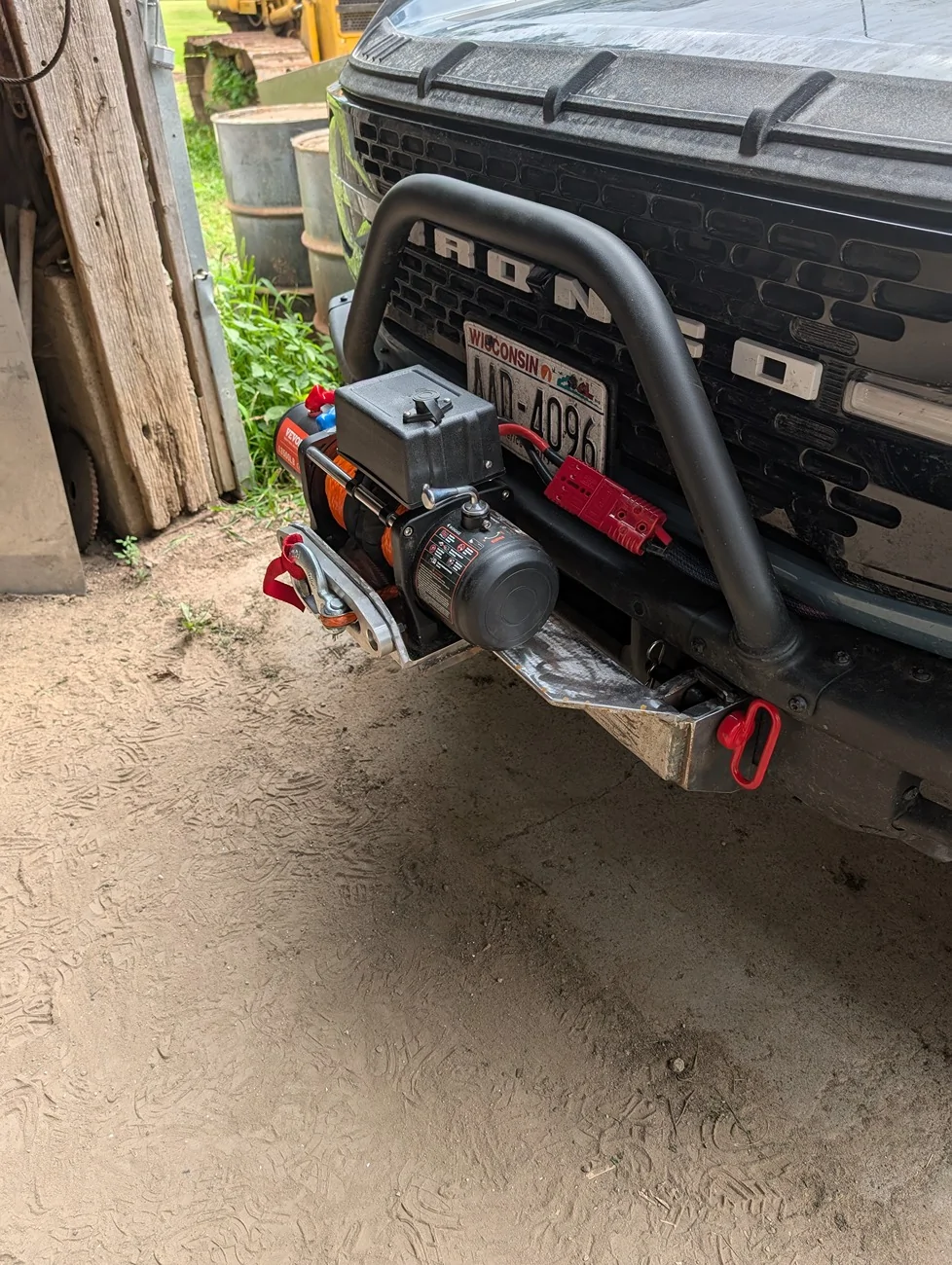

Ford Bronco Winch recommendations for capable bumper PXL_20250830_143243666
Made my own removable. Easy enough to put on by myself. Two pins and a plug. Yes, that's a Vevor 13,000# winch. I have less than $300 into the entire setup, and it's saved my bacon a dozen times now. Biggest reason I went removable is our great winter roads. Regardless of how well sealed anything is, the salt tends to reek havoc on everything.

Nice, but you must have installed a different intercooler?
