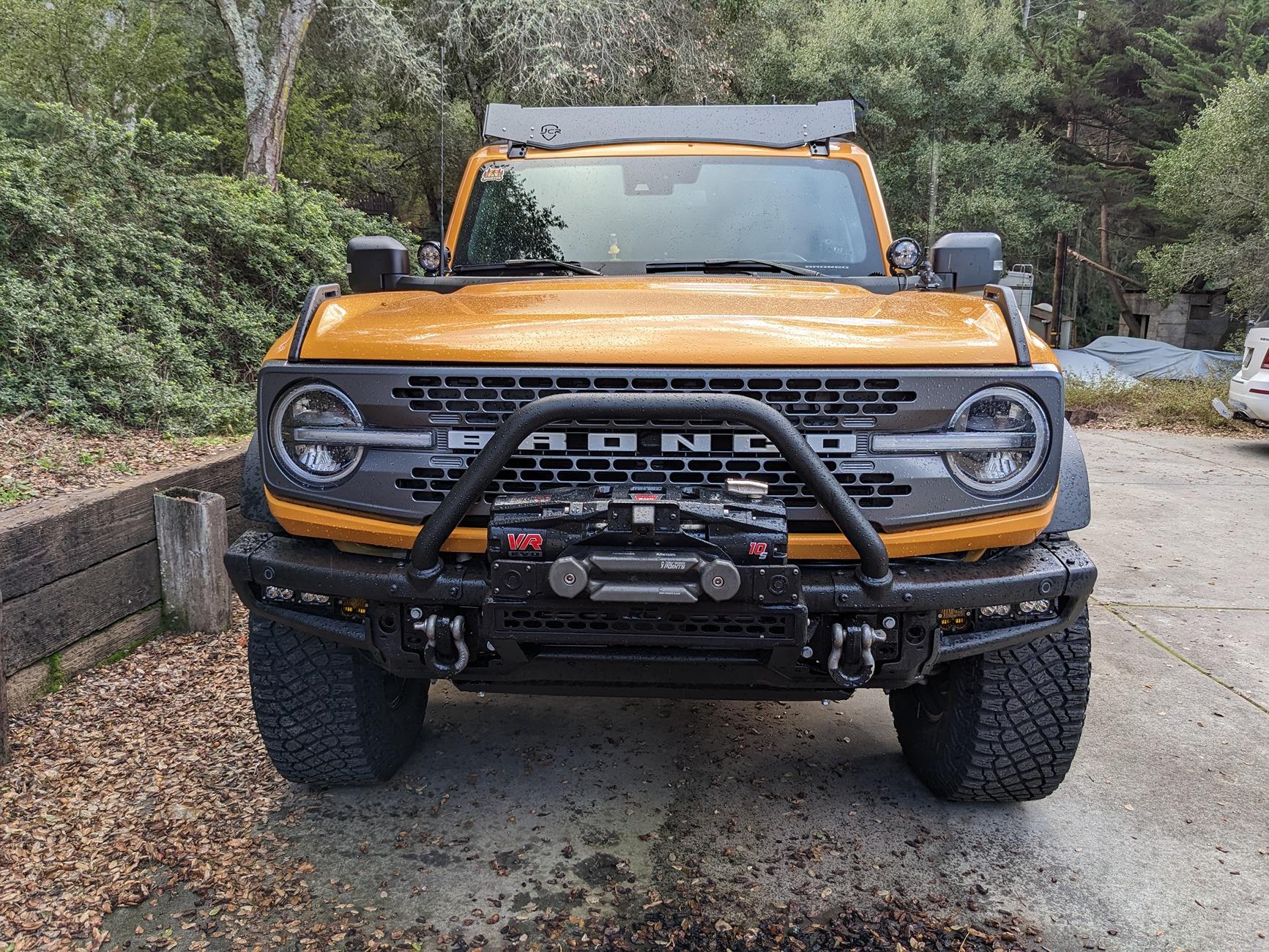

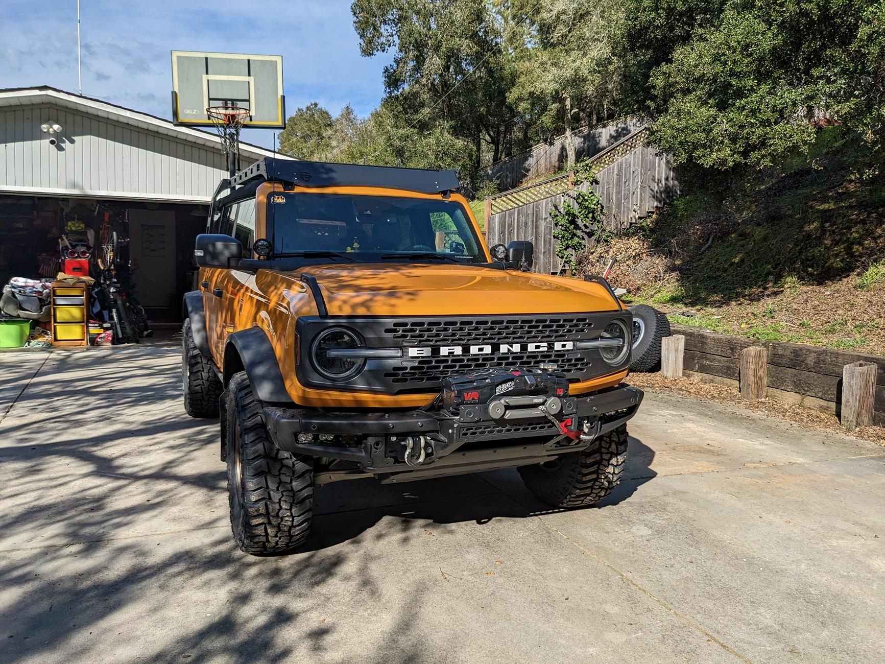

I have the RC mount with a Warn EVO 10S winch on factory Mod bumper, with factory bull-bar (it doesn't protect the winch, just there to protect the grille if a deer is hit). I've used this setup a number of times without issues on Level 7/8 wheeling trips and similar circumstances. Pros - so far holding up, strength-wise; excellent approach angle; retains factory ACC and proximity sensor operation; does not block Bronco lettering; compatible with factory bull-bar. Cons - requirement of a JCR (or similar) camera relocation kit, installed on the winch fairlead.
Photos below with/without bull-bar. Yankum farilead. RCI skid plate beneath Mod bumper.
The pro of the RC is that I can re-use my 20" light bar.
I also just noticed you relocated your control box - can you share details on that and where you put it?
Warn sells a control box extension kit - longer electrical cables that are just long enough to snake under the grille and extend into the engine compartment, connecting to the control box just behind the driver-side headlight. Another vendor (I don't recall the name) sells a bracket that bolts to the battery bracket, but for some reason it didn't fit for me, so my control box simply rests in that crevice, in front of the battery; it's pretty secure there, despite all the wheeling.

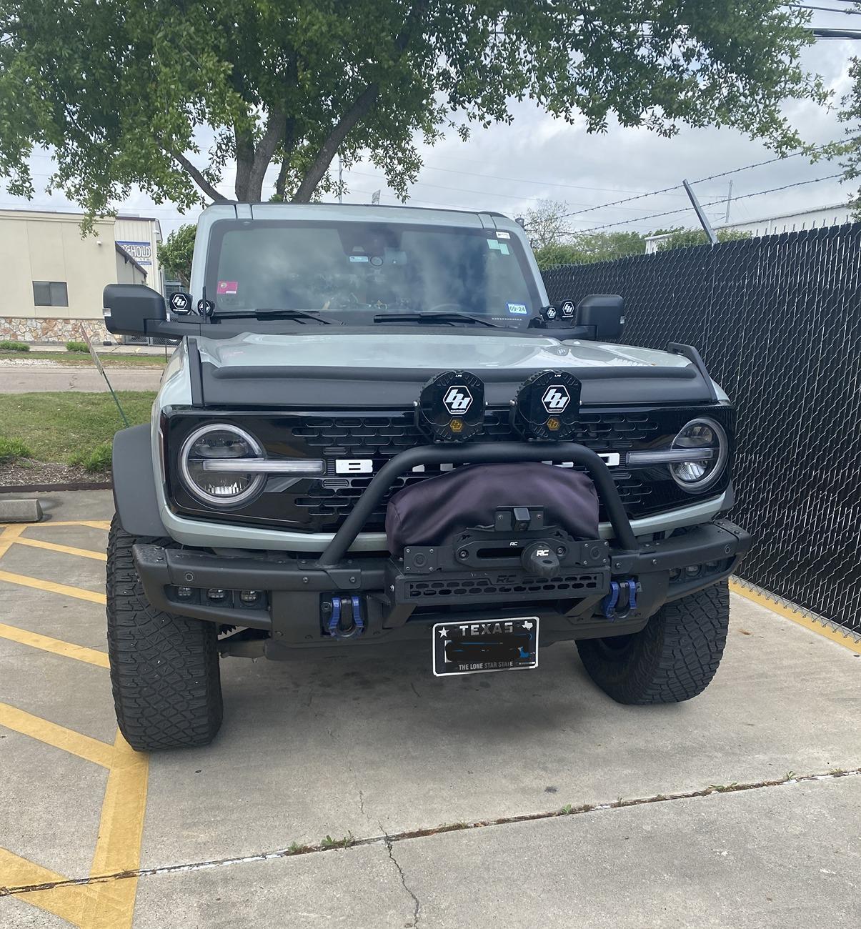

RC High Winch Mount with RC winch. I've checked all your boxes except for hiding the Bronco lettering. I went this route because when I get stuck, I don't won't to be wallering around in the mud, sleet, snow trying to pull out my line!
How is adaptive cruise?
I use ACC every day and absolutely cannot have its performance diminished.
I use mine daily also and the mods I have don't interfere with the adaptive cruise. If your state requires a front license plate just get the right relocation bracket so you don't cover up the sensor box. The ACC sensor is between the license plate and the bottom of the winch mount.

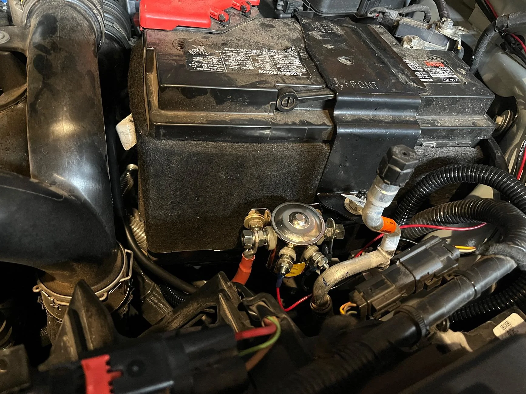

Just a quick comment on 2. - I used an isolator solenoid mounted on the battery bracket and used the #6 10A upfitter switch. Just curious why you don't want to use an upfitter switch? Have you already used all 6?

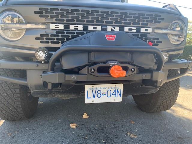

I have the JCR mount > I love it. IT has an aggressive look. I have not noted an approach angle issue on my runs. It does not block the letters, and you could add a bull bar if needed.
It has sensor holes to allow for relocation. I use a camera relocation kit and an ACC relocation kit as well > no issues with them at all.

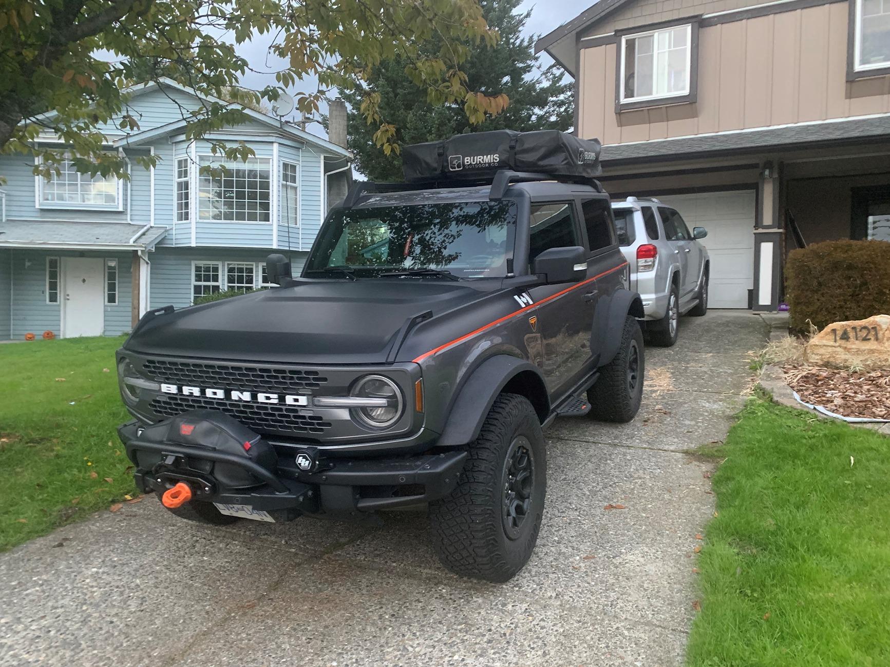

I went with a Chinese solution, worked out perfectly for me.
Ford Bronco Winch mount recommendations for mod bumper with LUX package bronco at home
