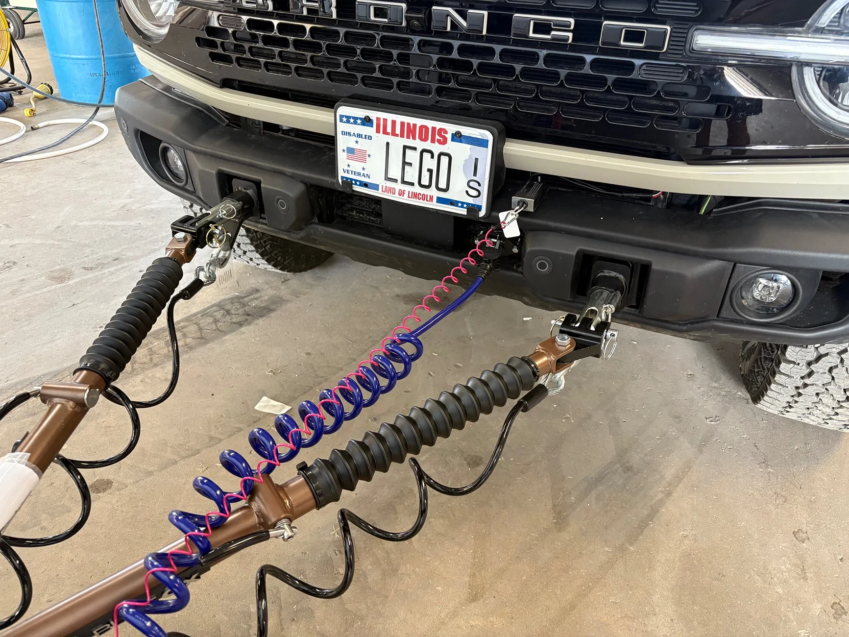

I have a capable bumper that is hooked up for flat towing. The adapters are welded into where the front D rings used to be. In hindsight, I should have gotten an aftermarket bumper that could accommodate a winch and the flat towing set up, but it already cost me thousands to set it up for towing and I don’t have the means to get a new bumper, and pay for flat towing installation again. Anyway, I digress. Are there any winch mounts compatible with my set up, or am I SOL? Photo attached for reference. Thanks in advance.

You would have to custom fabricate one. Looks easier than the D hooks that were there to attach on.

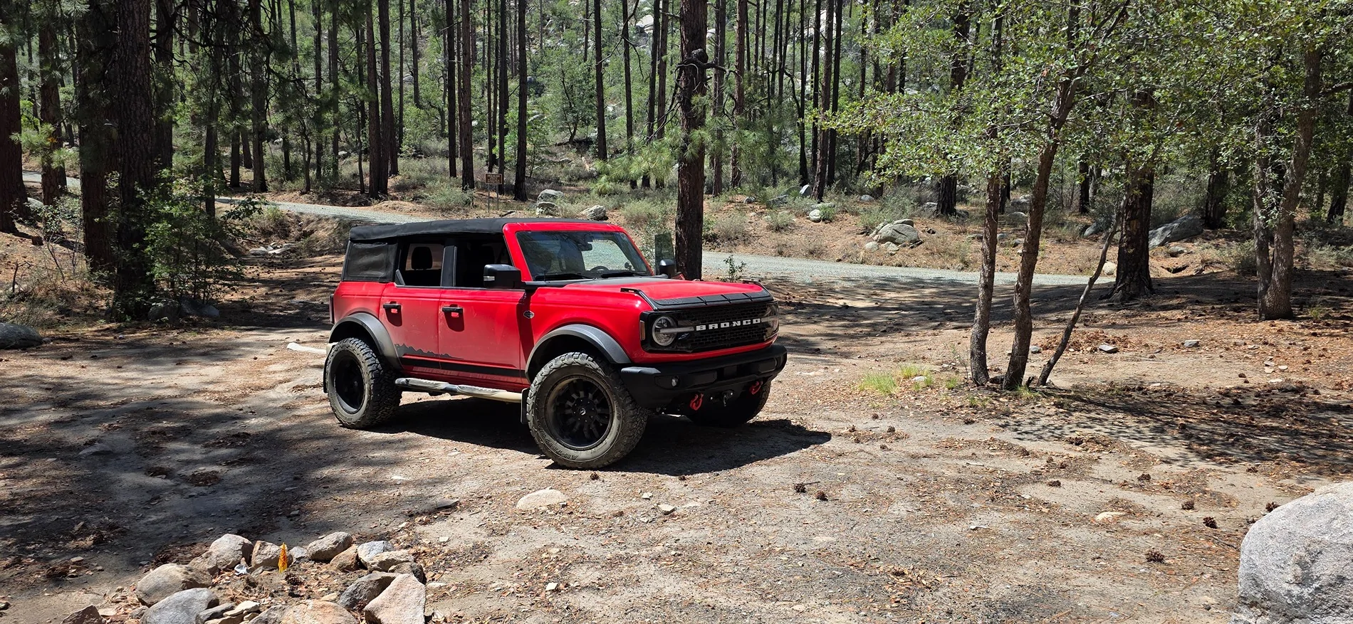

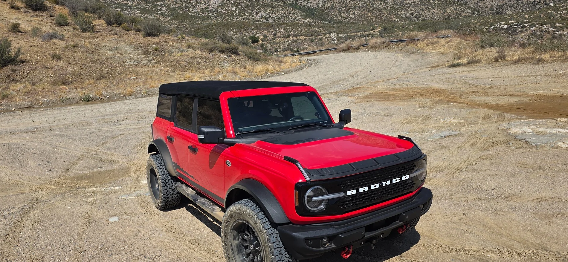

I had a 12k rc hidden bumper winch installed, on my 22 wildtrak non modular bumper, think it would work with your tow system. I think you can see the hidden winch under the stock bumper. Hope this helps

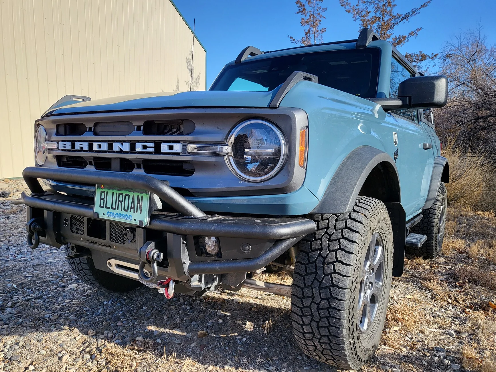

I would recommend the RC Hidden if you have the 2.3 anyway. Installation is more challenging with the 2.7. Mine currently has an aftermarket bumper and different tow sxet up, but it should work for you.
