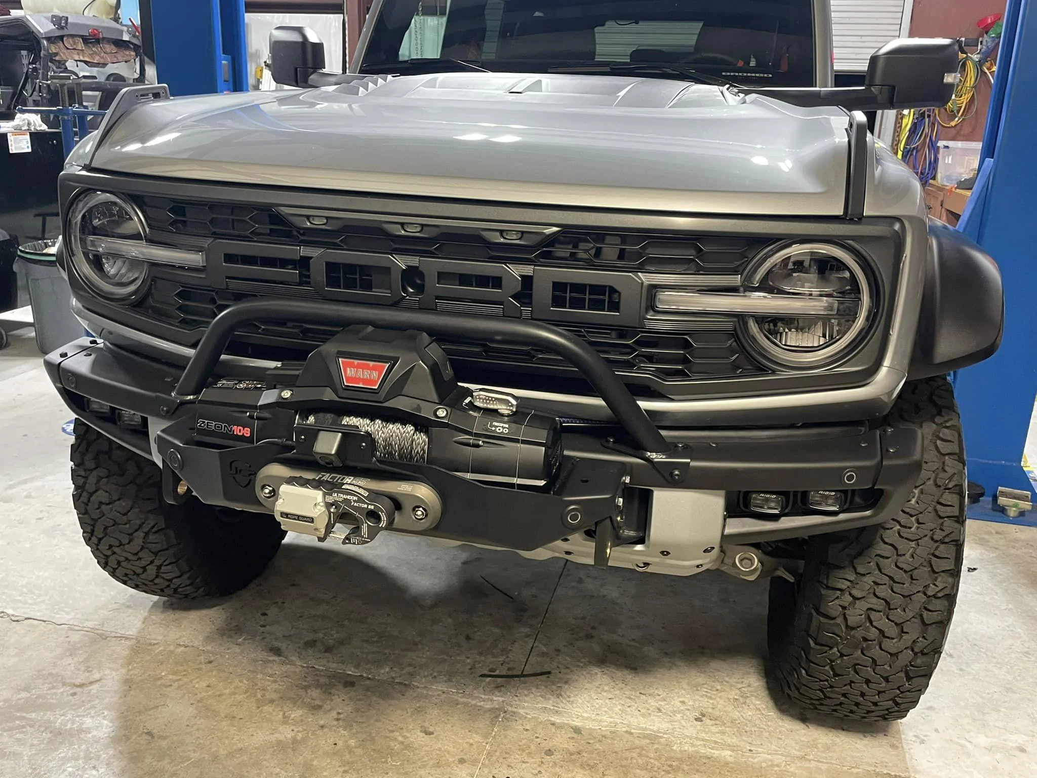

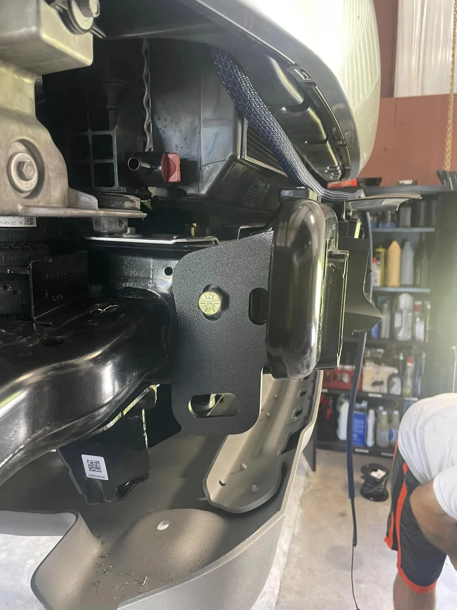

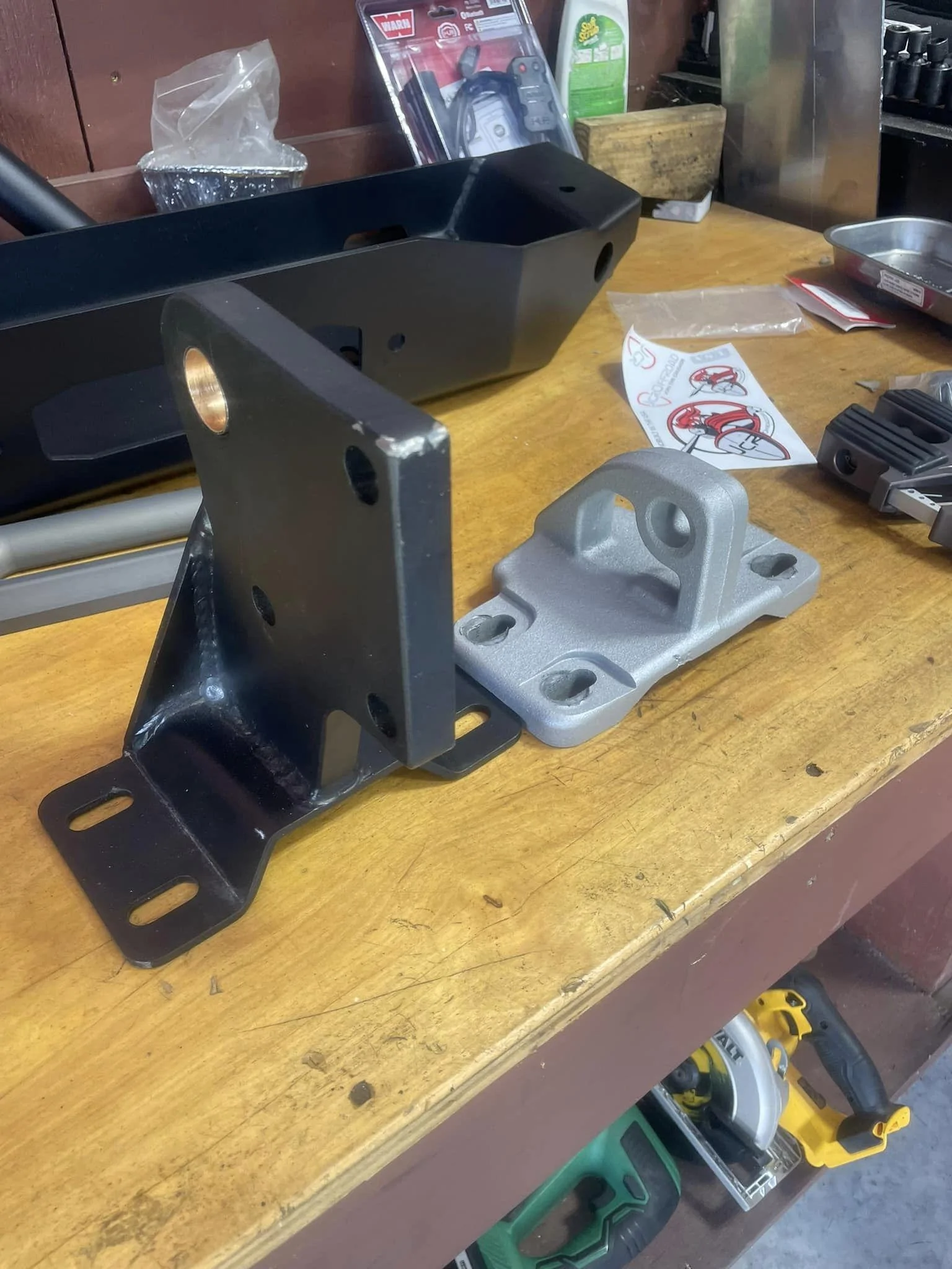

Just got Braptor and installed winch today, JCR mount is spot on for flat towing along with LOD rear bumper support. Have give all credit to folks had posted this for Bronco on here but it does fit the Rator just fine, I did elect to put oilite bushings in the tow holes as they were 1 1/8 i have 1 inch pins but i am aviation mechanic so I am kind anal about clearances alo have to clearnace the LOD brackets a little for skid plate only grinder action lol. Now for brakes and lights.
