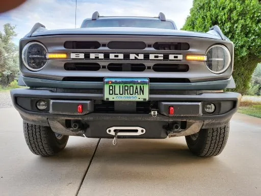

I have a BlueOx flat tow setup that I do not want to change. The flat tow adapters are in the place of the front tow hooks. Are there any recent options for a winch mount that works with this type of setup? I think the RC high bumper winch mount will work, but I was looking for other options.

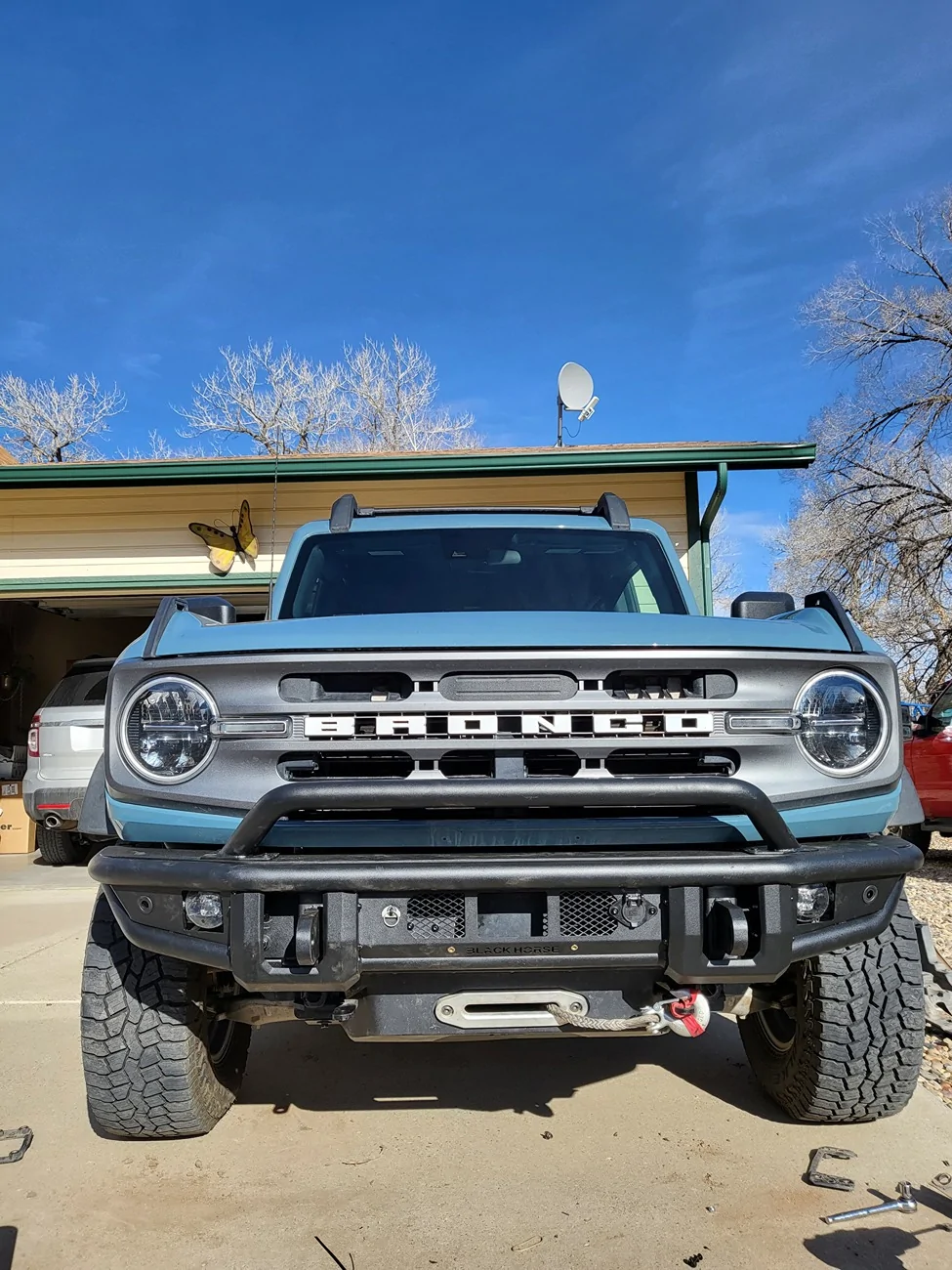

I run the RC Hidden with Blue Ox. The only issue was I had to trim the supplied RC bash plate to fit around the base plate on the drivers side. The RC comes with spacers for the intercooler mount which you use with or without a flat tow set up. I originally had it with the stock bumper I now have an aftermarket bumper,

Yep, I knew that one would work. I just don't think I want to do that install on a 2.7L. Gotta believe it would mess up a bit of warranty and too many modifications for myself. I previously installed the RC hidden on 2.3L and it was a very clean install.
