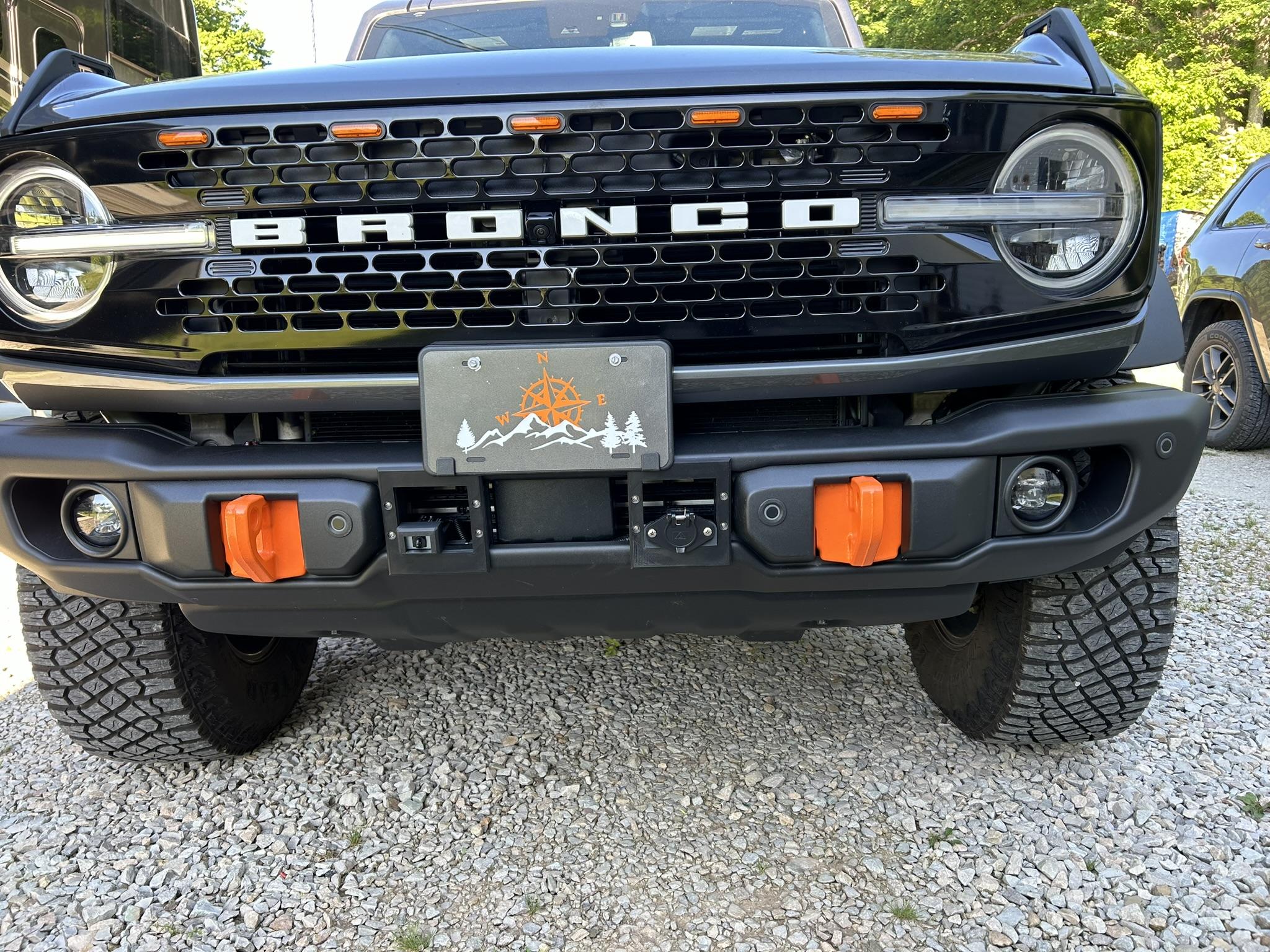

After several months of getting our Bronco with Capable Bumper ready to flat tow behind our RV, I think we are finally getting close.
Here's our setup:
Roadmaster Nighthawk Tow Bar
Ford Performance Tow Hooks
Demco Stay-In-Play Duo Braking System
Curt Custom Towed-Vehicle RV Wiring Harness 58992
I also plan to add the LOD Black Op Front Bumper Tie in Brackets
Ford Bronco Flat Towing W/ Capable Bumper IMG_7029.JPEG
Ford Bronco Flat Towing W/ Capable Bumper IMG_7030.JPEG
Ford Bronco Flat Towing W/ Capable Bumper Duo Installed 3
Ford Bronco Flat Towing W/ Capable Bumper Duo Installed 1

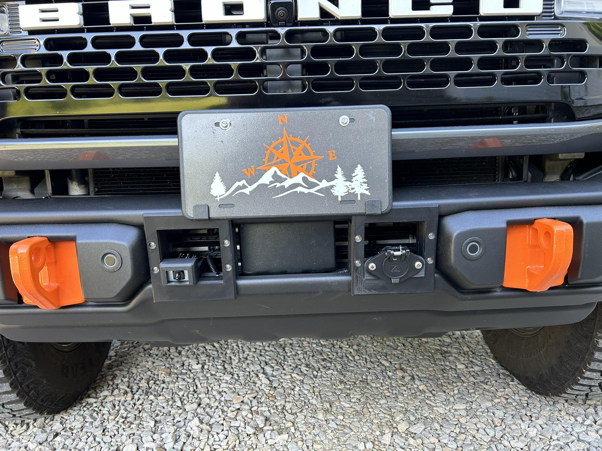

For those looking for a clean way to install breakaway switch and 6-pin socket in the Capable Bumper:
Mounts for Breakaway Switch and 6-Pin Socket

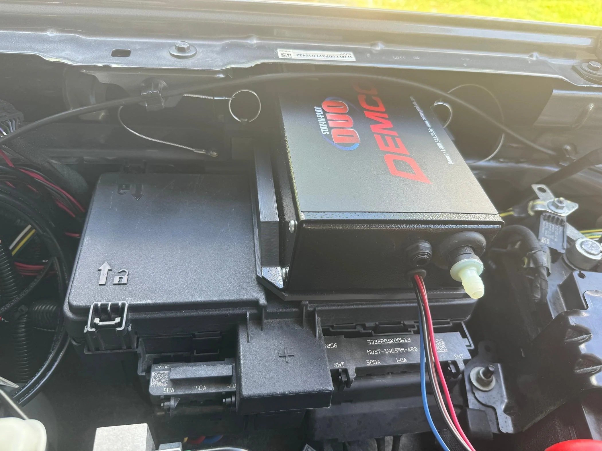

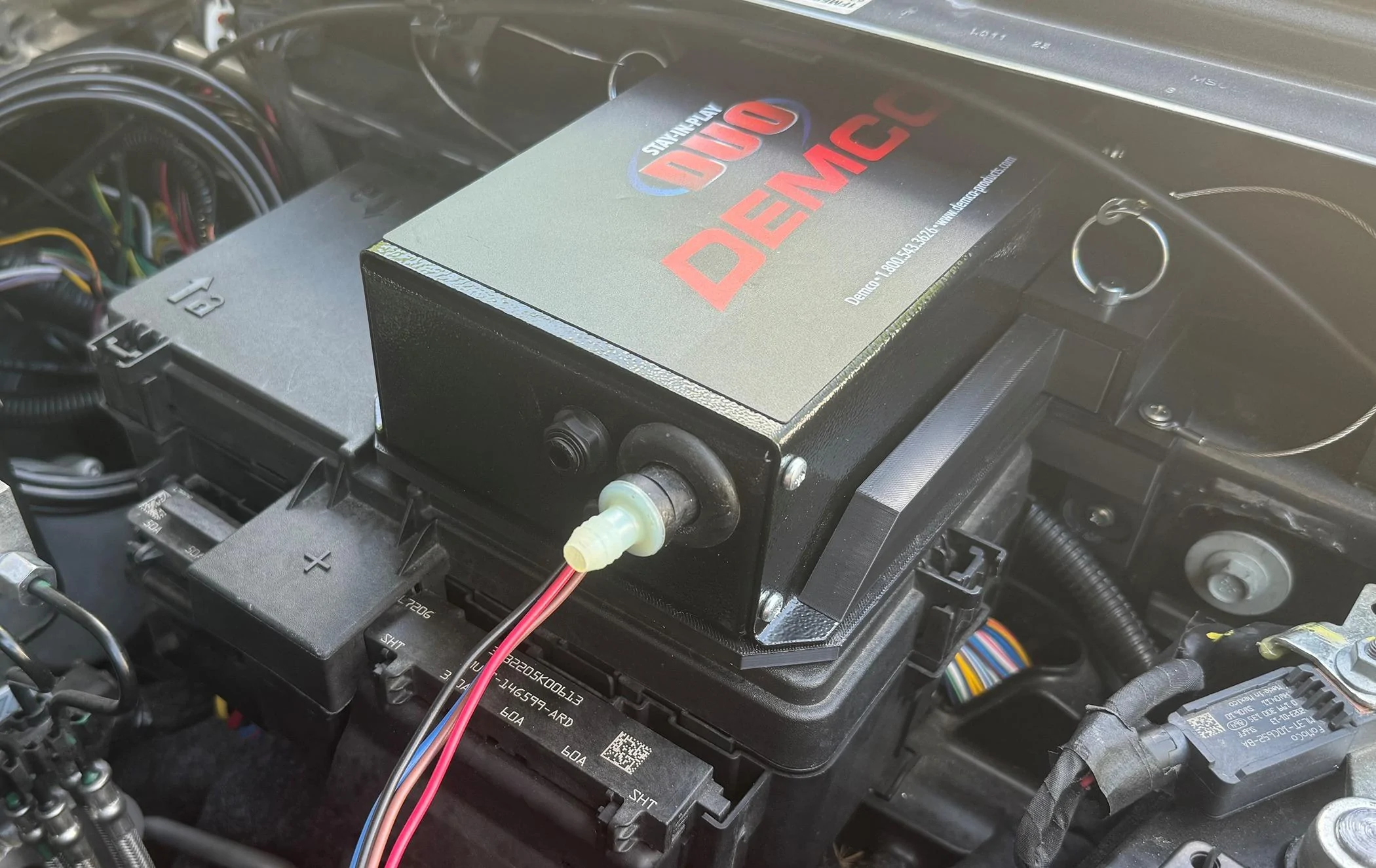

Also, here's a clean way to install the Demco Stay-In-Play Duo under the hood of the Bronco:
Mount for Stay-In-Play Duo for Bronco 6G
Here's our setup:
Here's our setup:
