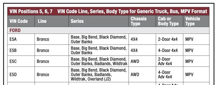

Positions 5,6,7 are the the ones to note. Need to be either E5C or E5D. C is two door, D is four door.
This is from the 2022 VIN guide. But the numbers should still apply for all current years.
