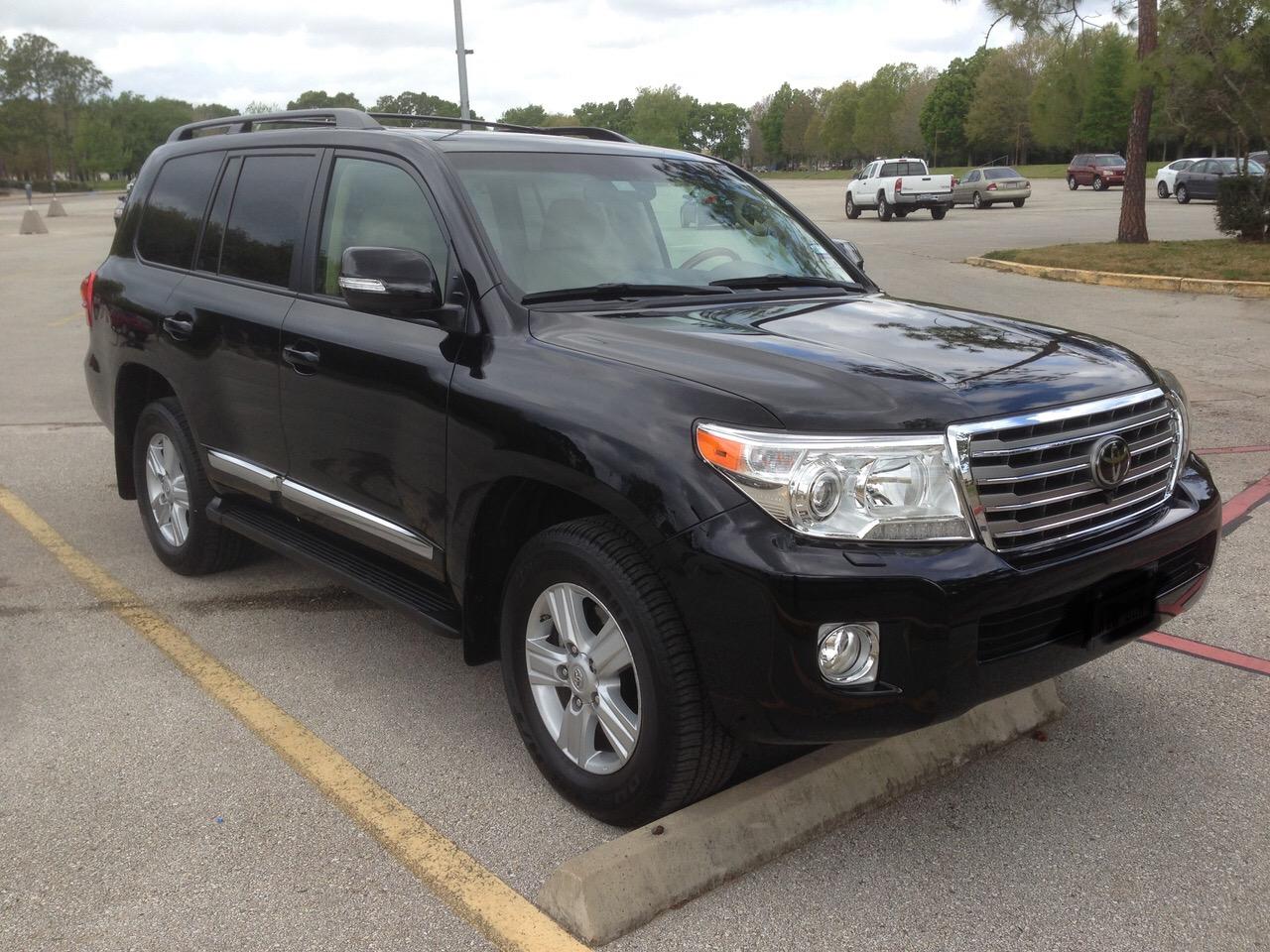

The land cruiser is great on and off road. The ride on the road is supple. The big SUV is isolated very nicely from noise and vibration. The suspension is heavy duty and very rugged and it goes over ruts and pot holes almost as if they did not exist. Remember that these LCs are used over the globe dealing like champs with the worst terrain for decades.
The steering is numb compared to sports cars or even the average sedan or SUV but it also keeps the rough and harsh action the front wheels are dealing with from your hands. The LC is so well put together that even after decades of use their is little or no creaking or squealing or other signs of things coming loose.
The Bronco is essentially an off road vehicle and its claim to fame is exactly that...off road prowess. It will deal with the paved roads and highways and the mall parking lot duty but the suspension is not built or tuned for that. The isolation from noise and vibration is also unlikely to be to the standard of a LC, certainly not over the long haul of years or miles. The Bronco's fun factor with removables doors and roof and ability to navigate narrower paths between rocks and such will be higher but for overloading say from Alaska to the southern tip of South America or across Australia or Africa or Central Asia no vehicle can compete with the Landcruiser. I drove all over the US in my first 1992 Landcruiser and when I sold it it was still solid and going strong.
Picture is that of my 2013 LC.
