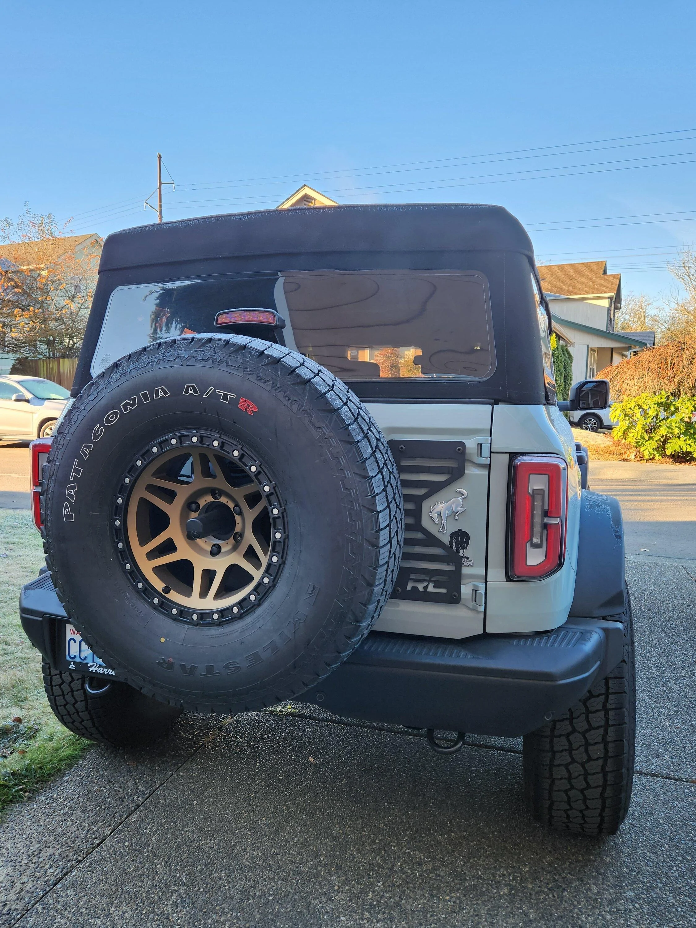

I went with the rough country. My 37s and methods weight is 16lbs more than factory. Seems like it will hold up fine.
