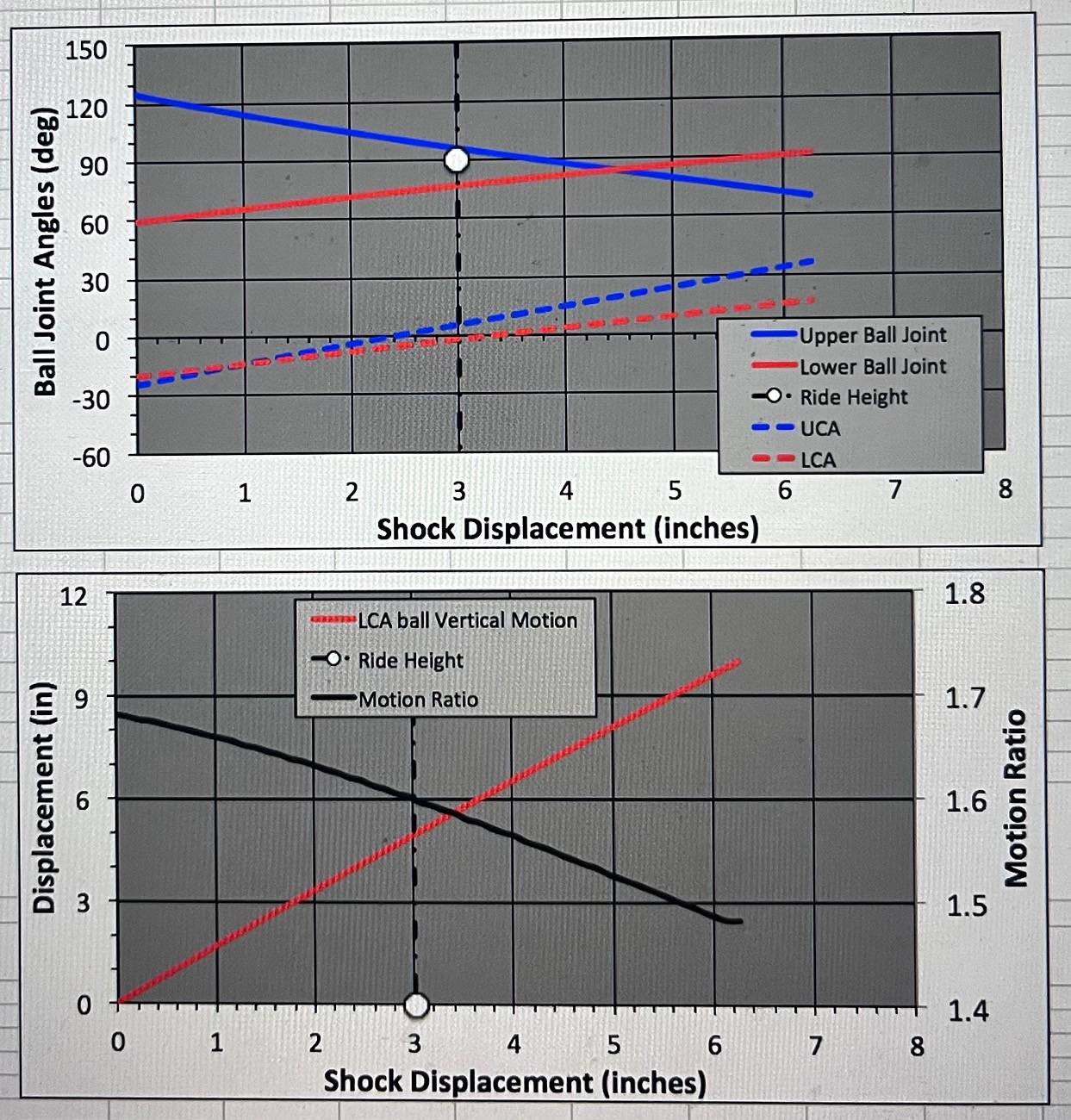

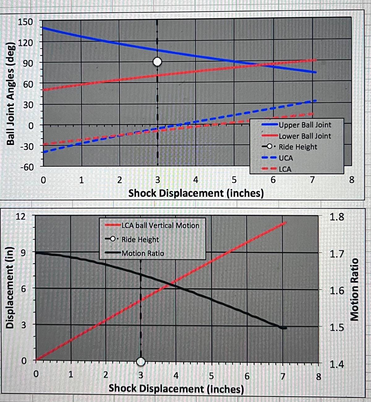

The oem kinematics of the front control arms results in the following plots. Most struts will fall between these limits.
first plot is with oem SAS struts: 17.06” and 23.31” compressed and extended lengths.
second plot is for RK struts (which offer the most travel I have come across): 17.5” and 24.5”.
for UCA, the max ball joint angle occurs at full rebound, and only varies from 125 to 140 degrees. Upper ball joint should be designed to handle at least 150 degrees.
The decisions on ball joint mostly depend on strength, ride quality, noise, maintenance, serviceability. Some of these factors are at odds with each other.
perhaps most importantly the ability to dial in the kingpin axis for alignment, which depends completely on location of ball joint and your ride height. It is important to know what lift height the uca was designed for and what your ride height lift is.
Or just choose based on color.
