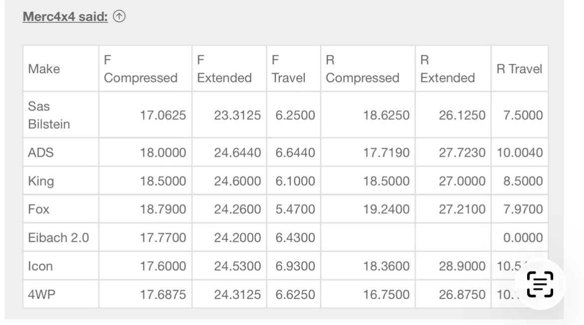

For front OEM LCA geometry the max shock extended length is 24.3”. After that you get some binding in stock CVs at full rebound. Most aftermarket struts do not exceed 24.3”. The stock struts have an extended length of 23.3” so it is not wise to add a spacer that is more than 1”. That gives about 1.6” lift at the wheel due to MR.
A lift of 2-3” at the wheel is best achieved with only 1” shock length extension and the remaining from the spring via a combination of rate, free length, and preload. Goal being to get static ride height near shock mid stroke. A 3.2” wheel lift only requires 1” from shock length and 1” from spring, due to motion ratio. Most of the aftermarket coilovers accomplish exactly this to get 2-3” of lift (ride, king, fox).
