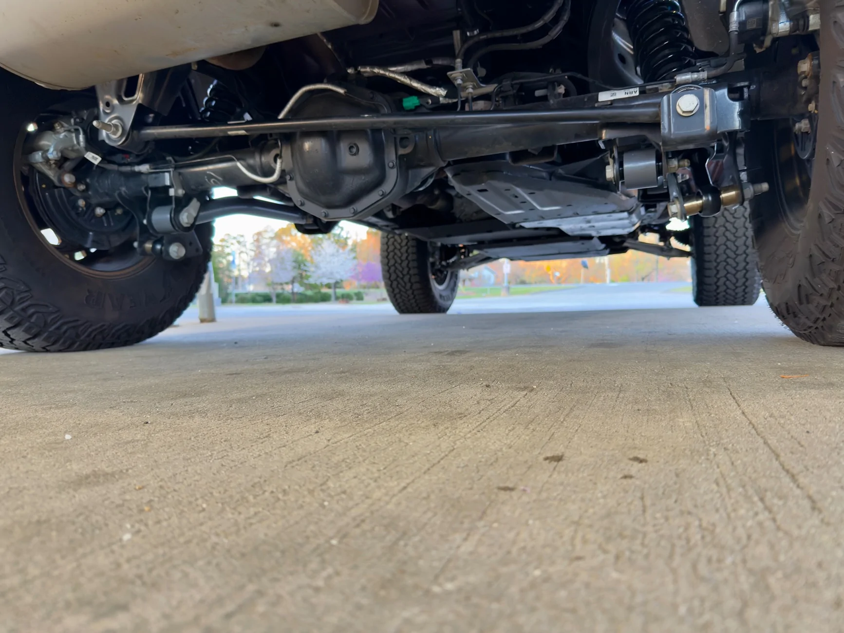

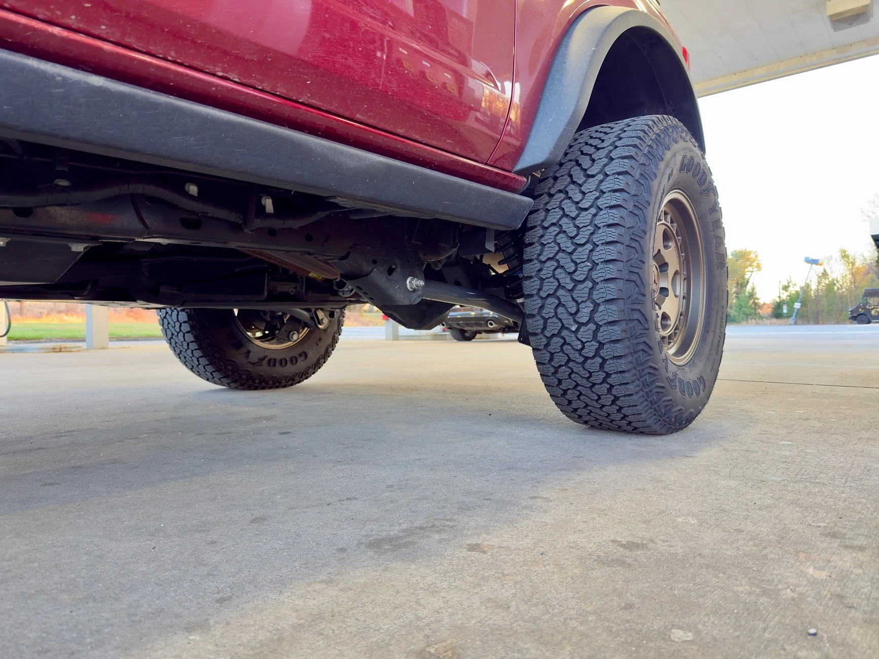

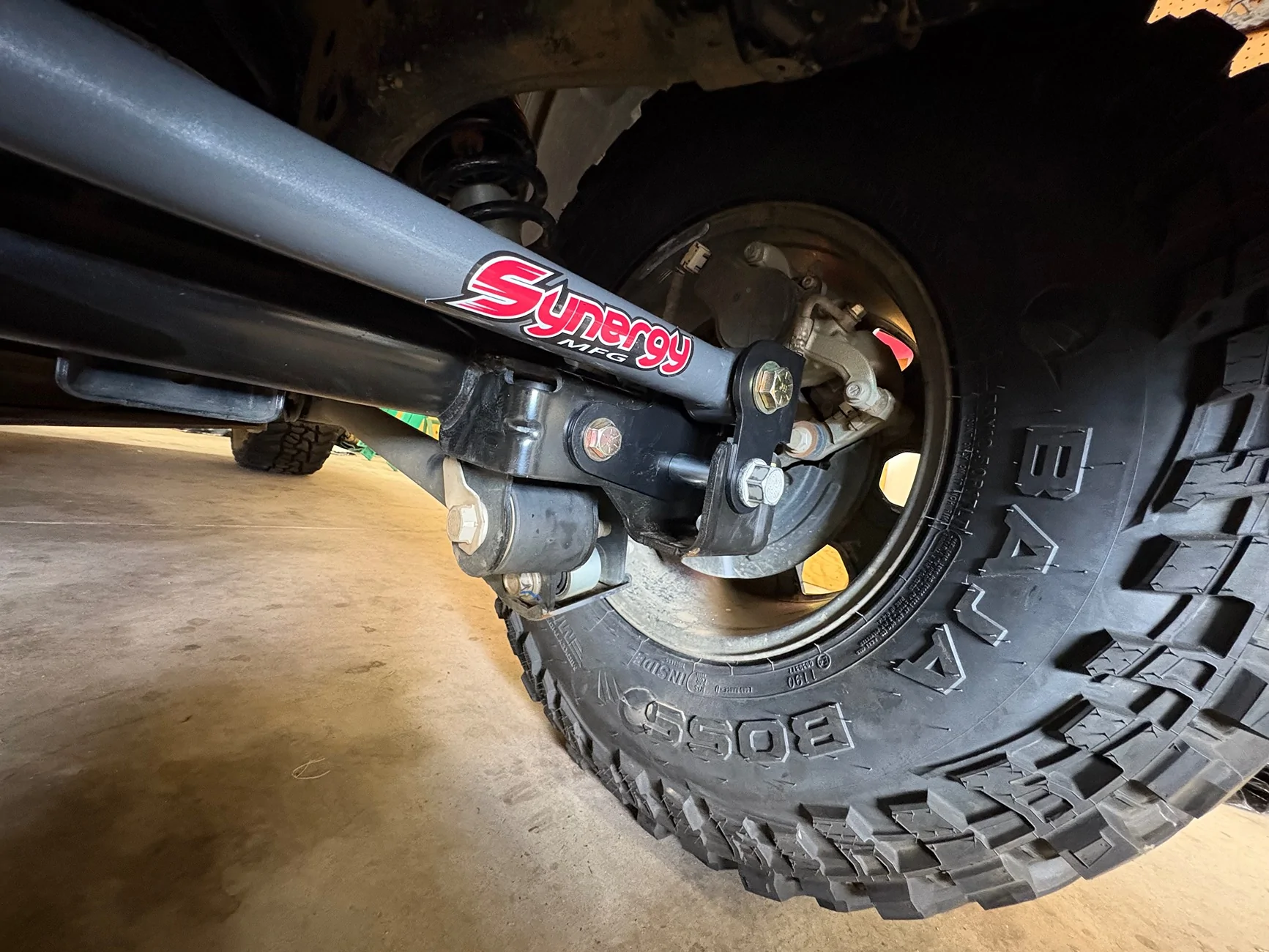

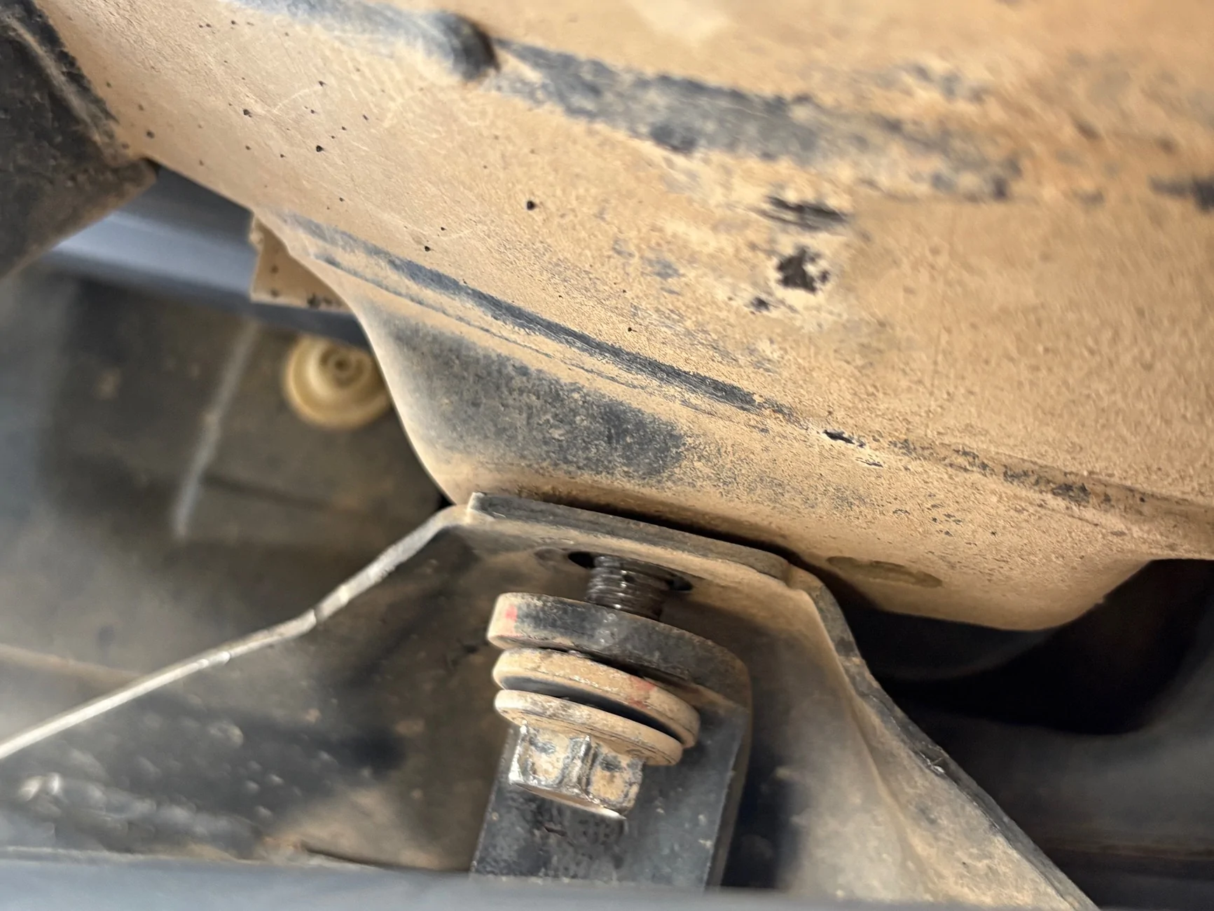

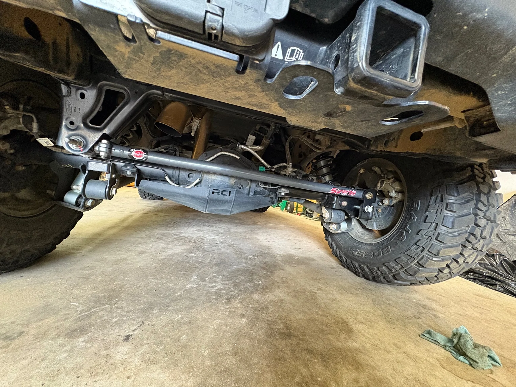

Got the lowers on, should have just went ahead with the uppers also but it’s not too bad of a job to drop the tank out. Taking my time in my garage on the ground took me about 1.5hrs. The arms are flat and about the height of the tank skid. Still awaiting the panhard bar and relocation bracket.

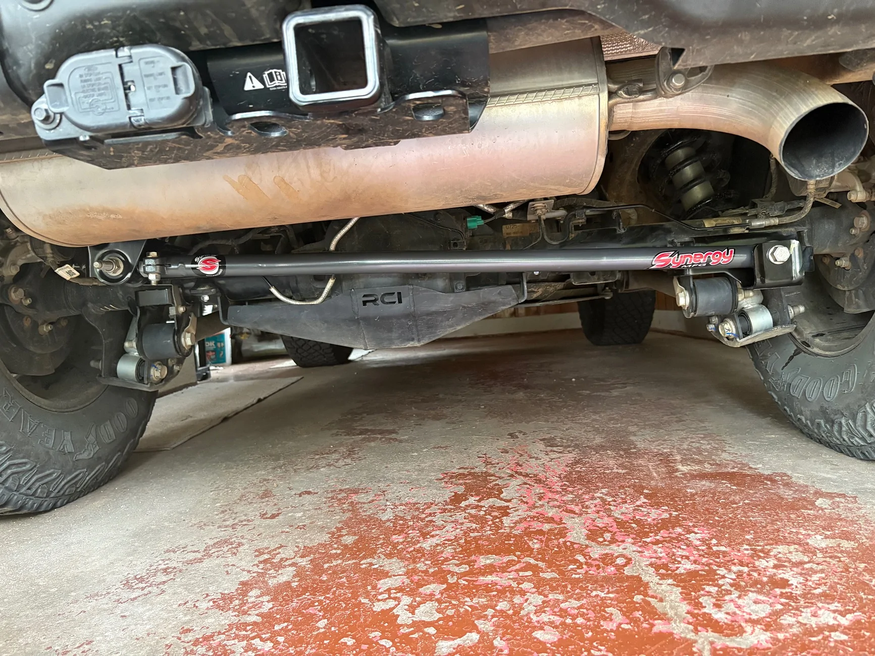

Nice. I got the Synergy Track bar. Made a difference in ride. What track bar and relocation bracket did you get?

Synergy for the bar, rock jock for the relocation bracket. Im a tad OCD so the matchy match itches the odd spot in my brain.

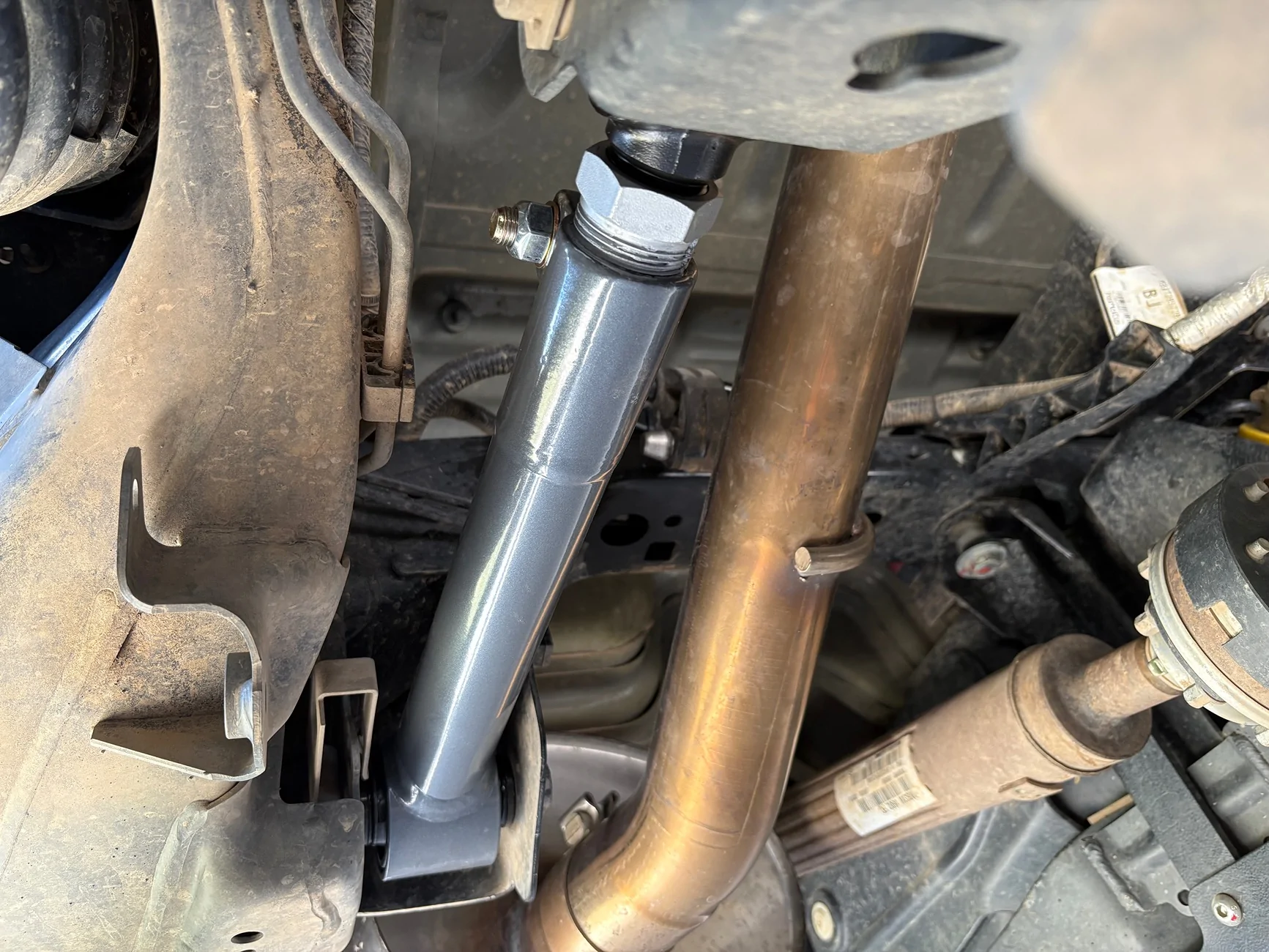

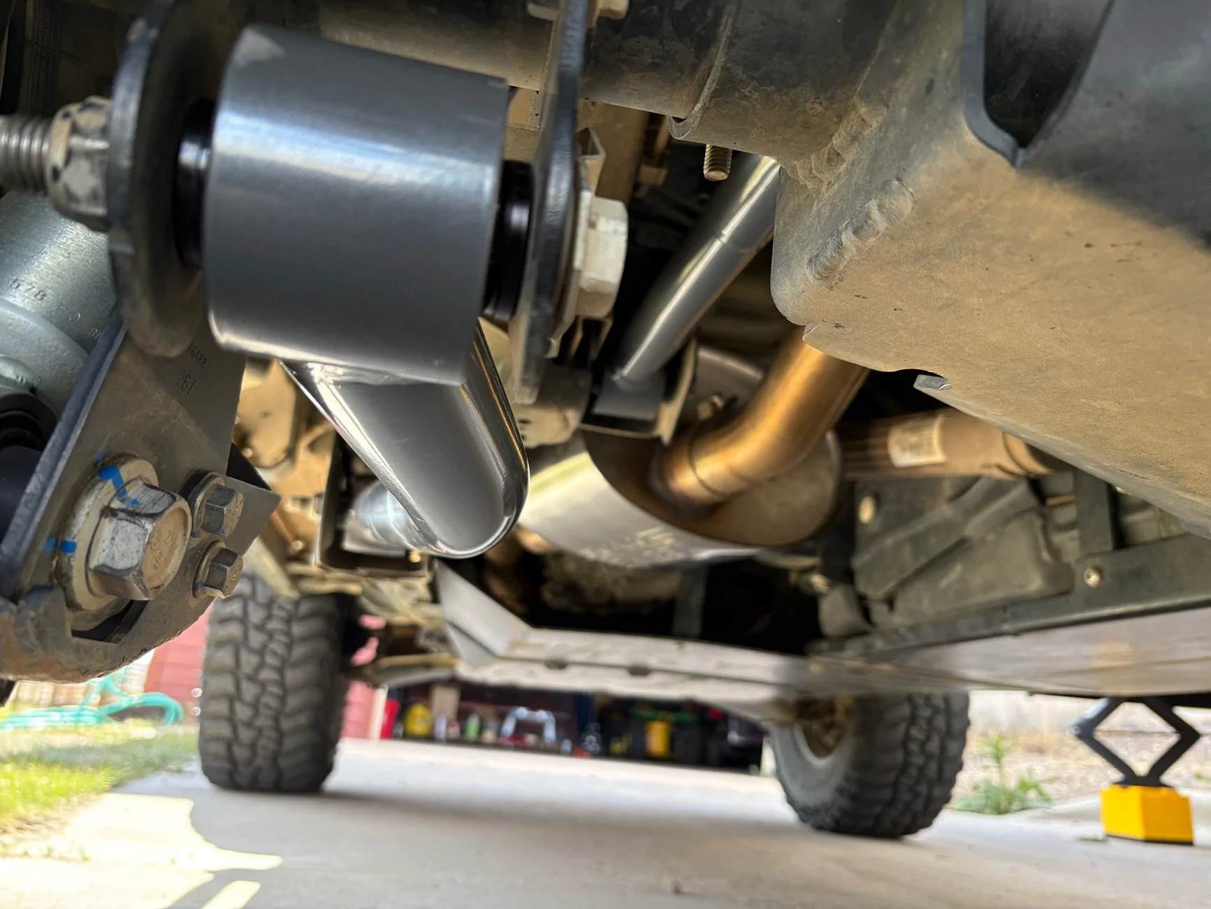

Well I got my control arms installed however have to take my Bronco back to the shop Monday! They installed the uppers in reverse! Then failed to torque the gas tank bolts. One was hanging down flapping in the wind and could have came off driving. Then they didn’t adjust the sleeves properly with the slots in the arms. I should have just done the work my self and got it aligned. It’s very difficult to find a good shop! At least they are giving me money back on portion of labor.
Besides the poor install job, the Bronco rides great especially with the alignment! It seems to soak up expansion joints better in the rear on the highway and rear end feels more muted if you know what I mean. Rear seems a bit softer too. Excited to take it off road!

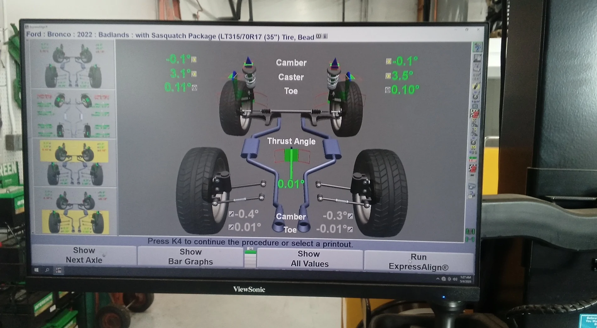

They set the alignment specs to the following. How’s this look? Bronco rear end seems to soak up bumps better, but the alignment feels different than what I am used to. Steering feels heavier at slow and high speeds. Might be because of the higher caster and slightly negative camber? Should I take it back for another alignment? I was thinking of trying my local Ford dealer to see how well they do for alignments rather than 4x4 shop.
