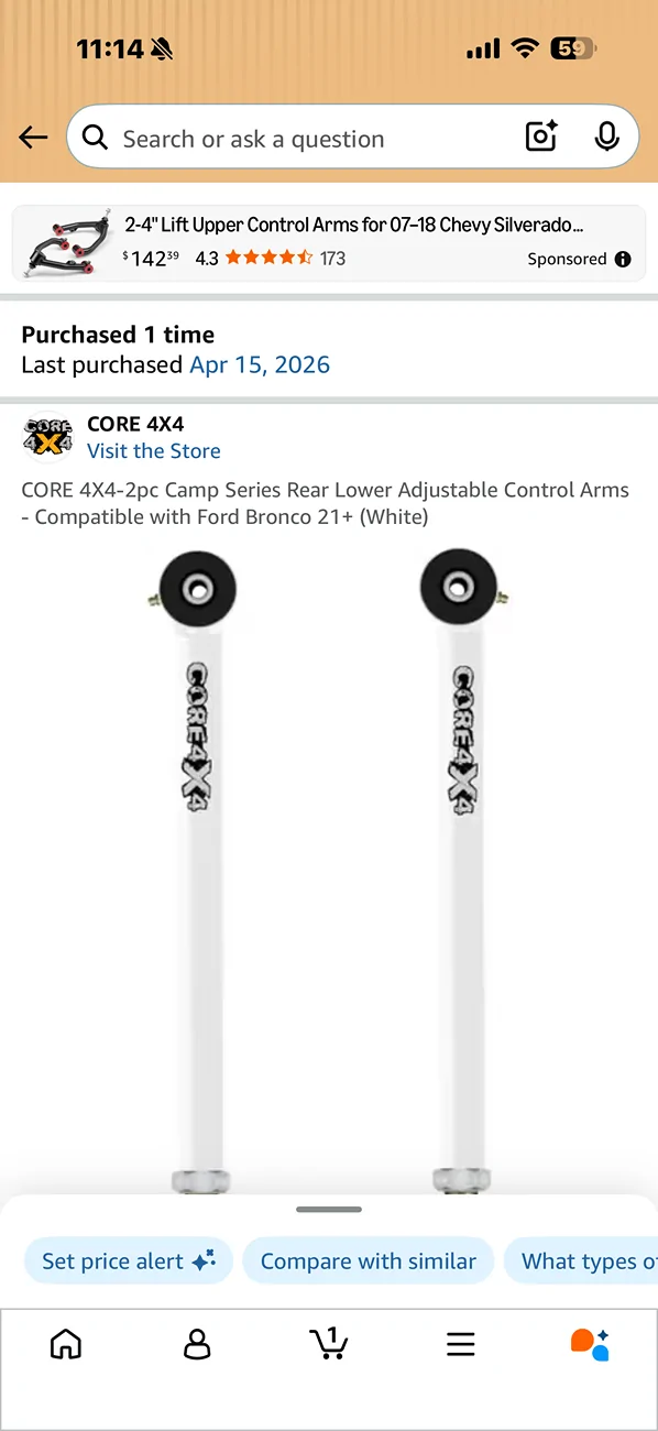

Has anyone upgraded to the core 4x4 rear lower control arms camp series with the Johny joints on both ends ? I recieved mine the other day, went to install the first one on the drivers side, put in the bracket with the bolt and the amount of space between the joint and the bracket was crazy ! Out the nut on and started to tighten it and got uncomfortable going to far as I felt like I would start bending the bracket. Even significantly tight there was still a lot of movement.
Ford Bronco Core 4x4 rear lower control arms IMG_0961

I have the core “crawl” rear arms…fit nice, no problems …might want to call them?… I guess washers are easily available…

they supplied washers and I researched some use those as shims but I could only fit one inside to use as a ship on one side Inside the bracket then I went to tighten again and still felt that if I continued tightening I would make the bracket a V ? I did reach out to them and they are researching it but even they didn’t have an answer but was still looking into it. I also noticed I ordered the camp series but got the crawler series cause it’s Johny joints on both ends and the camo series is Johny on one end and the poly on the other !?
