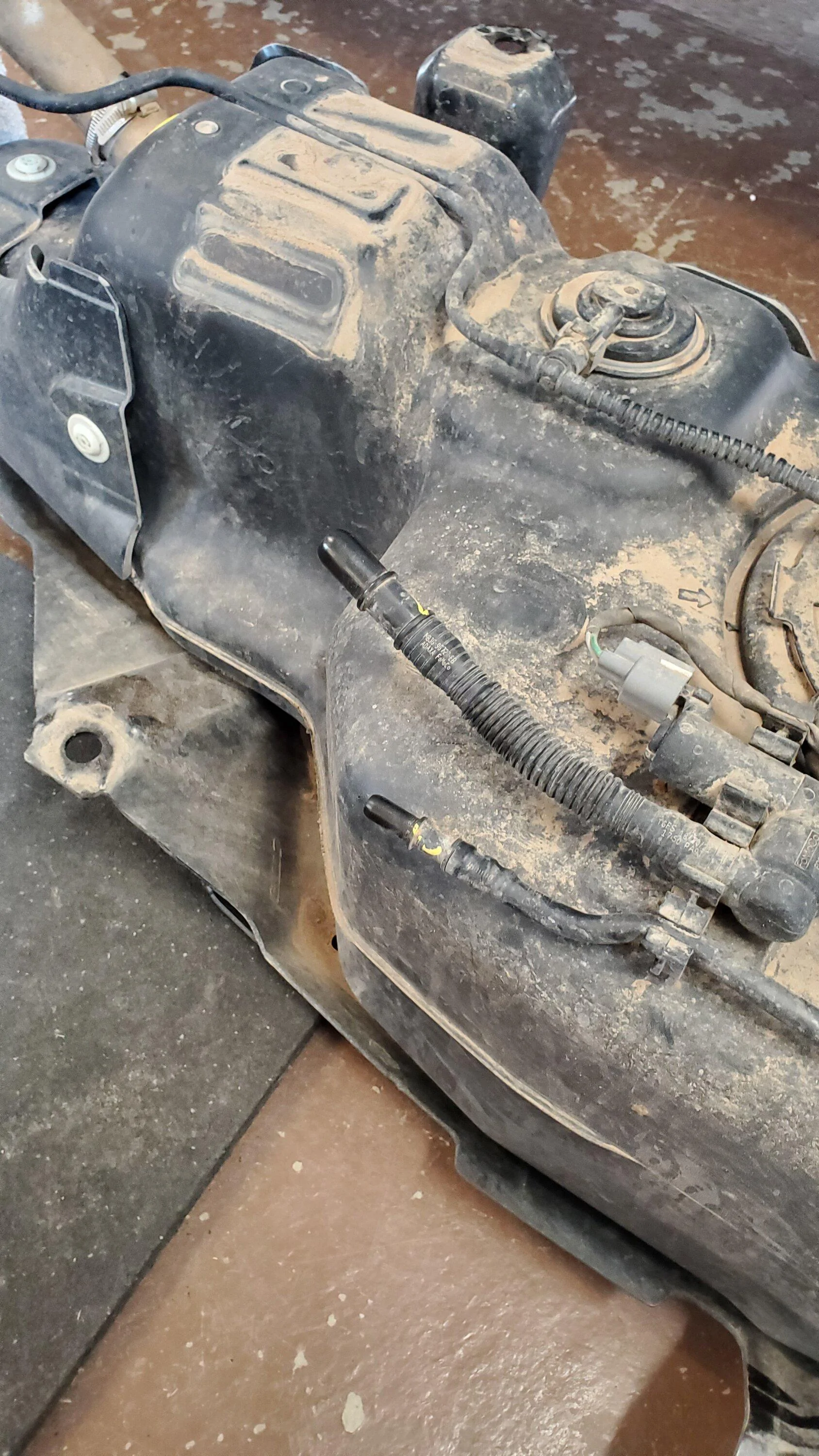

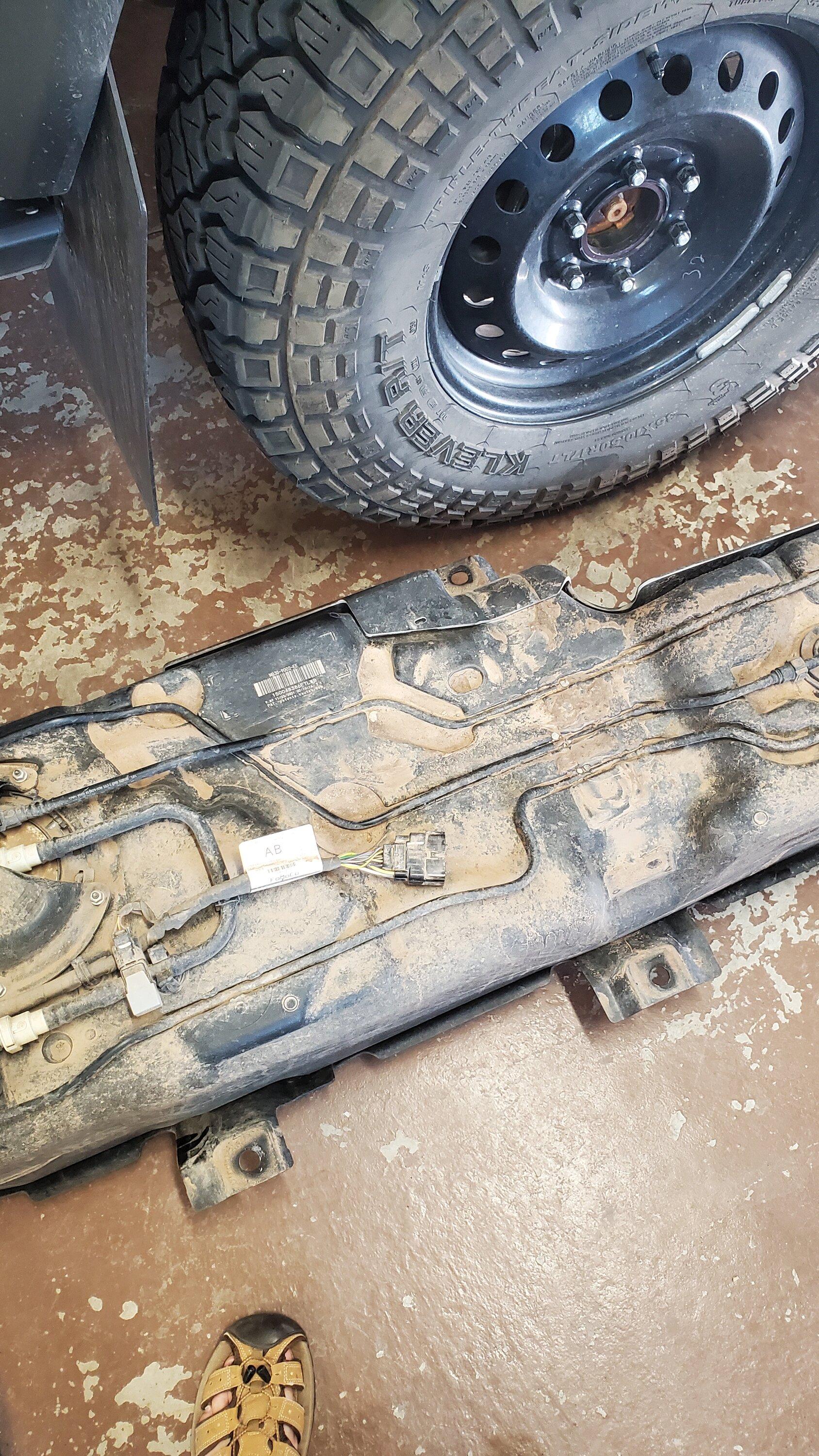

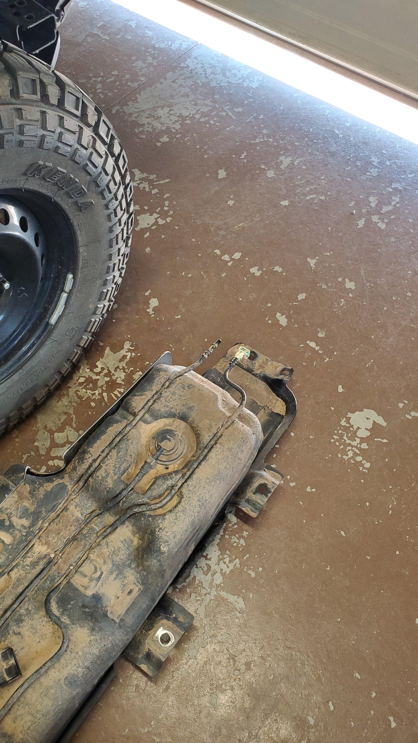

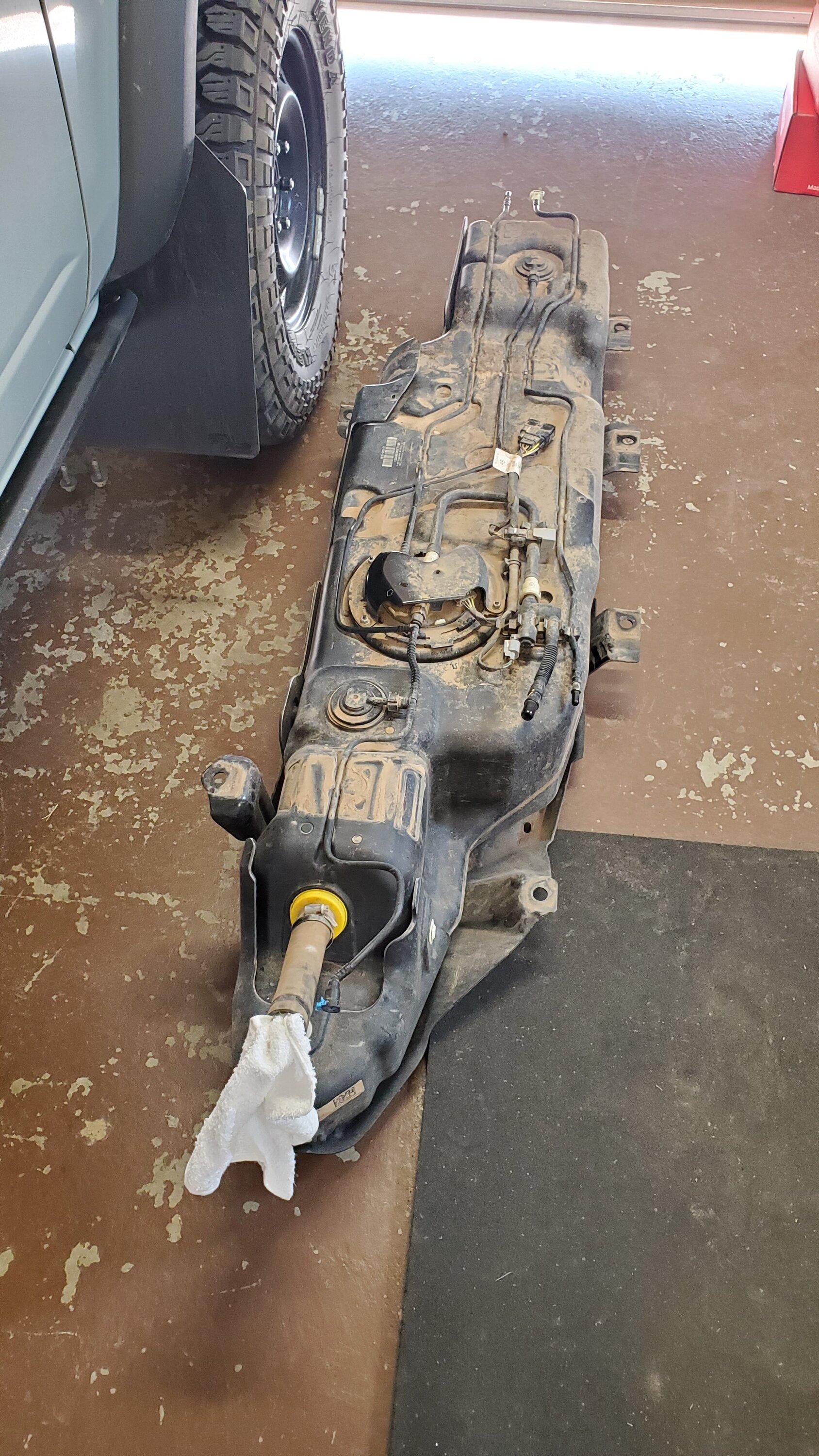

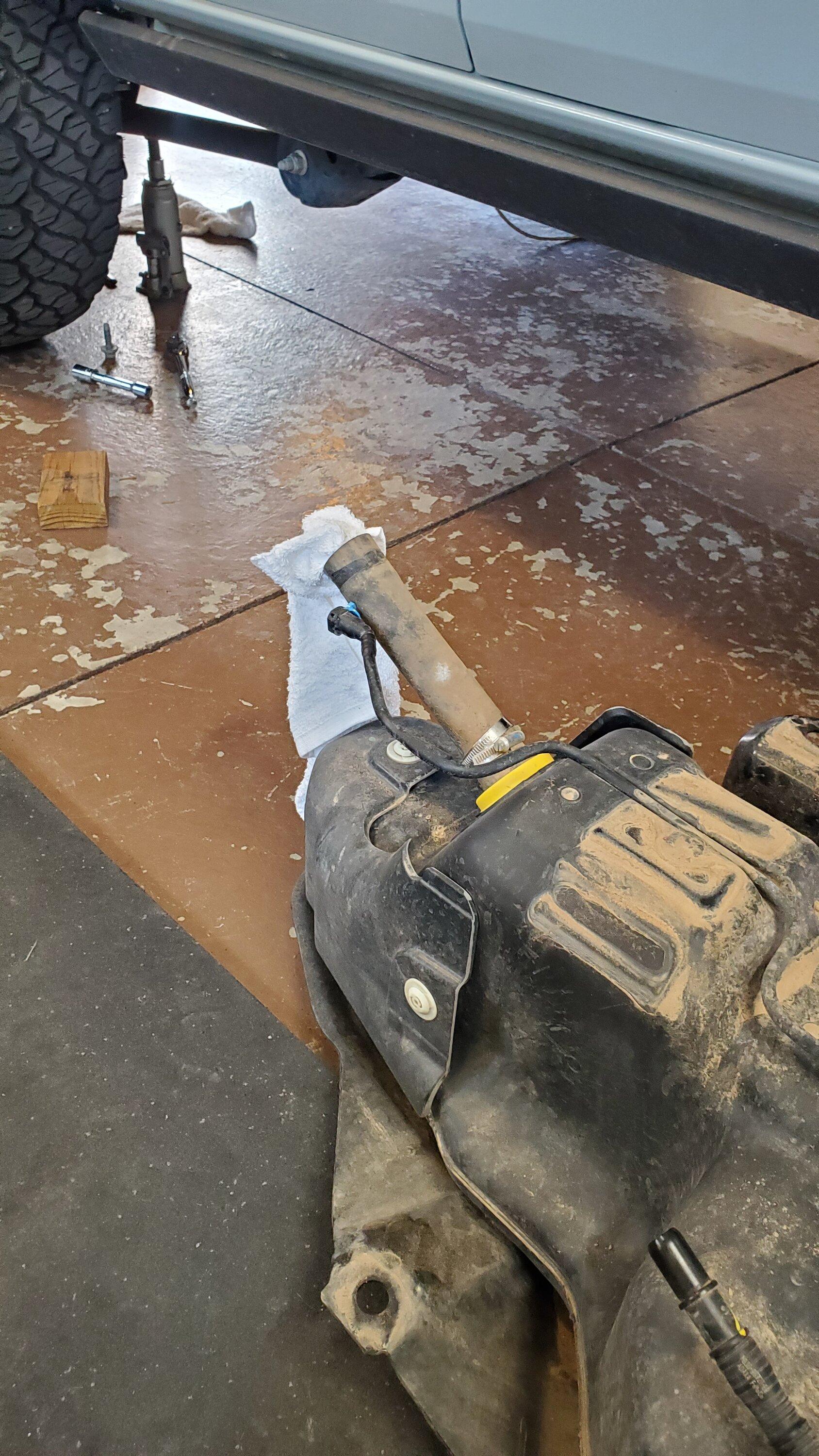

If you have question on dropping the tank, let me know.
Above center of fuel tank is driver for fuel pump. Disconnect and start Bronco till it dies to bleed fuel pressure.
At front of tank is two fuel line disconnects.
Center top of tank is fuel pump connector.
Rear of tank is filler hose and vent connection.
Evap cannister is above rear of tank, pull passenger side connectors, 2 by frame.
Lower tank a few inches to get fuel pump electrical connector, mentioned earlier, and other side of evap hoses.
Drop tank and here are a few pics...
You removed the whole tank?? Couldn't just lower a little to reach the bolt?
You could try it, but think the tank would still be in the way.
