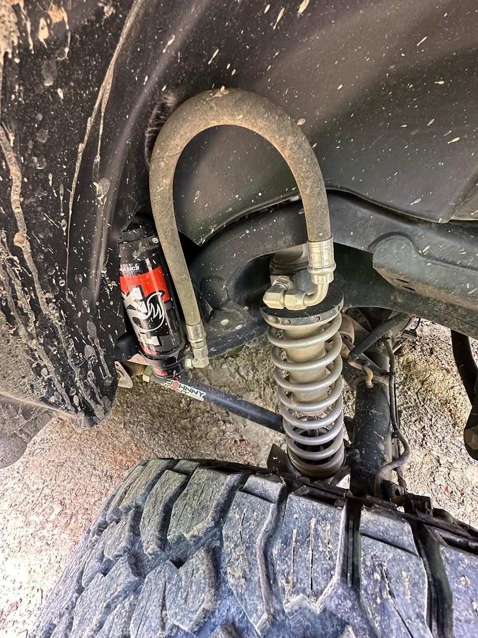

I’m running RJ upper& lower links with RJ track bar also have fox 2.5 elite coilovers. The oem control bushings flex pretty good. Like already mentioned your shock length will always be the limiting factor. I’d wait on those links and put the money into other parts. I’d only upgrade the links if you plan to get extended length coilovers or you’re not going to get the full benefits from them.
Like on that RK four link everyone says it adds more flex. I’d like to see an actual measurement that it does. Unless you lengthen the shocks it’s not going down any further. Might get there easier and keep the pinion angle perfect but not go down any farther then the shock stroke will let it.
