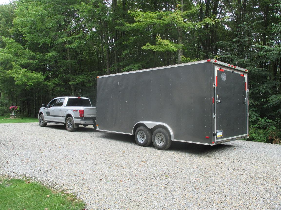

I have an '18 F-150 with the Coyote and other than it being a noisy engine at times I have zero complaints. I bought a left-over at the end of '18 but it has all the options I wanted plus. The main things were crew-cab, 4x4, 3.73 gears and E-locker. I pulled my 18 foot enclosed trailer loaded with about 4500 lbs of my sister's furniture and clothing (~8000 lbs total weight) from southern Georgia to central PA last September and it never broke a sweat, even in 101° heat coming through S. Carolina and climbing the mountains on I-81 in Virginia. Awesome powertrain.

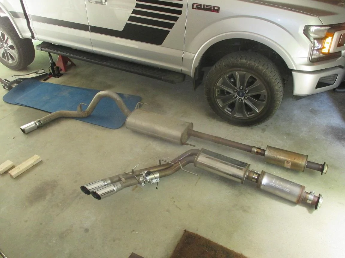

As far as exhaust sound, I did install a Magnaflow dual side exit exhaust system along with a Magnaflow straight through resonator which, by the way, made surprisingly little or no difference in sound volume or quality over the system without the resonator. I eventually modified that to make it into an "active" exhaust by installing an electric flapper valve in one of the outlet pipes. With the push of a button on the remote control I can go from reasonably quiet to all the hell-raising noise I want.

It's not actually a dump valve. All I did was close off one of the two outlet or "tailpipes" that exit the back of the Magnaflow Muffler. The exhaust still has to go through the muffler regardless of whether the valve is open or not. When the valve is open, both tailpipes are being used. When the valve is closed, only one tailpipe is used. It really does reduce the sound level as well as reduce the drone at around 2000 RPM.

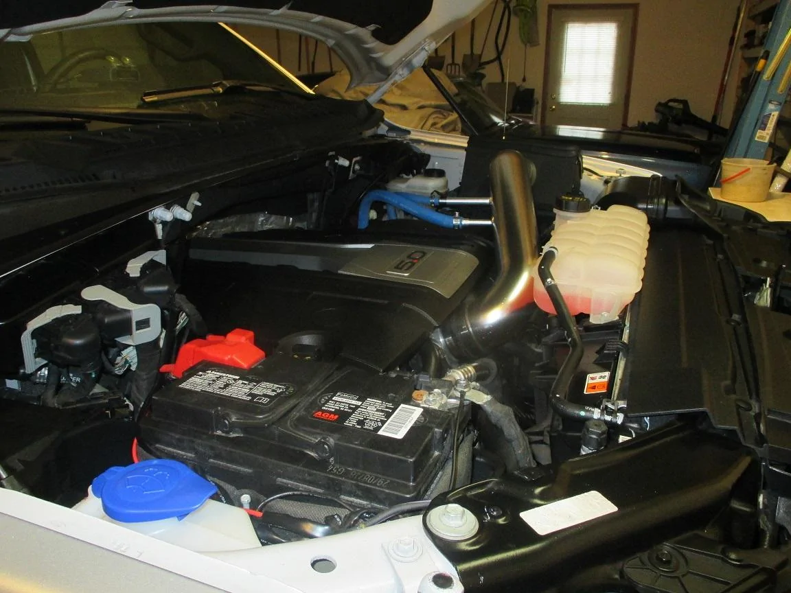

I think it's actually a combination of things. You are correct that some of it is coming from the injectors since there are sixteen of them on the gen 3 now that it has both port and direct injection. The gen 3 also went to PTWA which is a sprayed on cylinder liner in lieu of a steel cylinder sleeve as on the previous gen Coyote's. Add in the bump from 11:1 to 12:1 compression ratio and I think you are getting less sound deadening and more noise transfer through those thinner liners in the aluminum block. Some people also claim the cam phasers rattle as well. That complaint is also common on the 3.5L EB. The cam phaser theory has some merit since the Coyote does use a variable displacement oil pump and because the cam phasers operate on oil pressure there could be insufficient oil pressure at low RPM's to cushion the action of the phasers. Lots of theories and Ford just says "It's normal".
I actually installed a Mustang GT engine cover on my truck in the hopes that it would quiet down the injector noise. I even added Dynaliner on the underside. To be honest, it didn't make much difference at all but it does look a little better than stock.

Here's a comparison of the stock exhaust and the modified Magnaflow system.

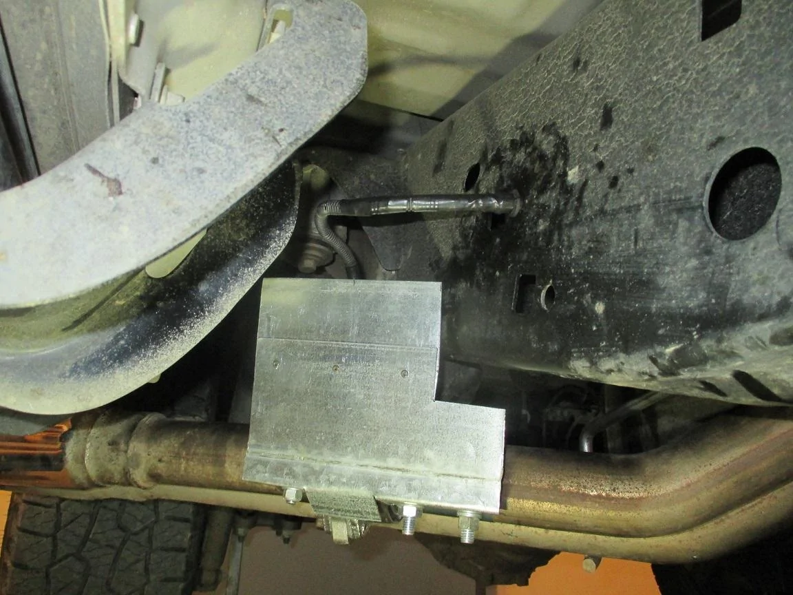

Here's the system installed on the truck with a stone shield.
