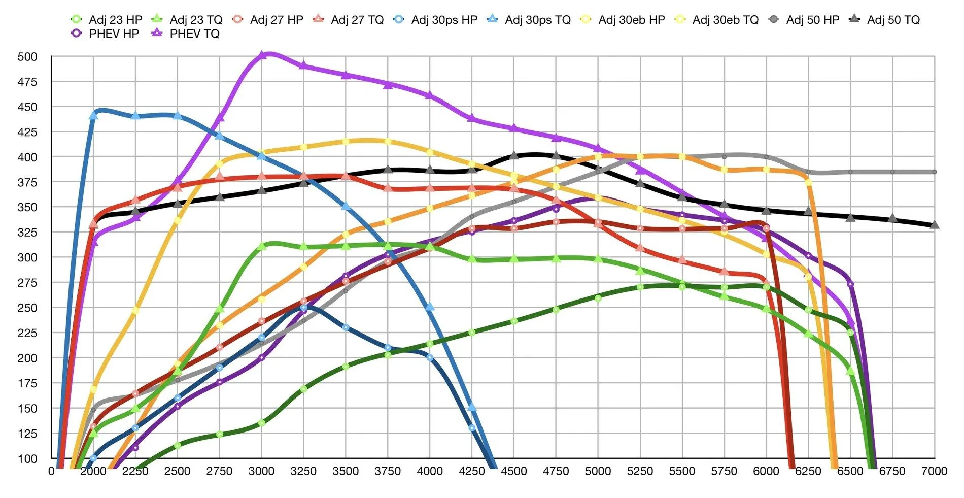

Ford Bronco 2.7 vs coyote power curve 60DBCBC8-AF8A-4E2B-BF05-587831CB4EBB
updated

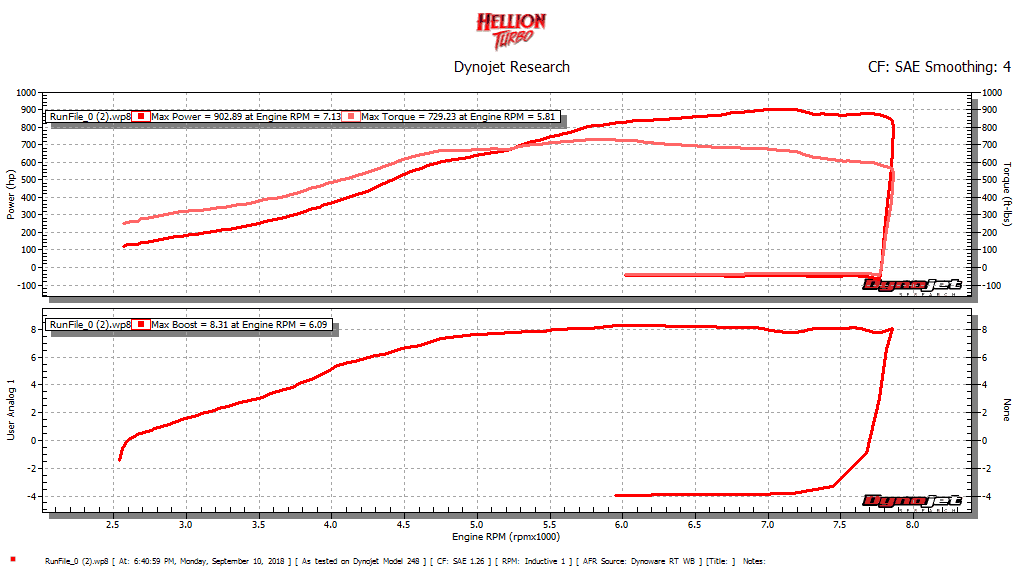

If I had a choice I'd pick the PHEV or the Coyote for them sweet sweet 7000rpm+ pulls.
The dyno graph for my F-150 looks like that hellion one^^
Fun, but absolutely useless and comical on the street.

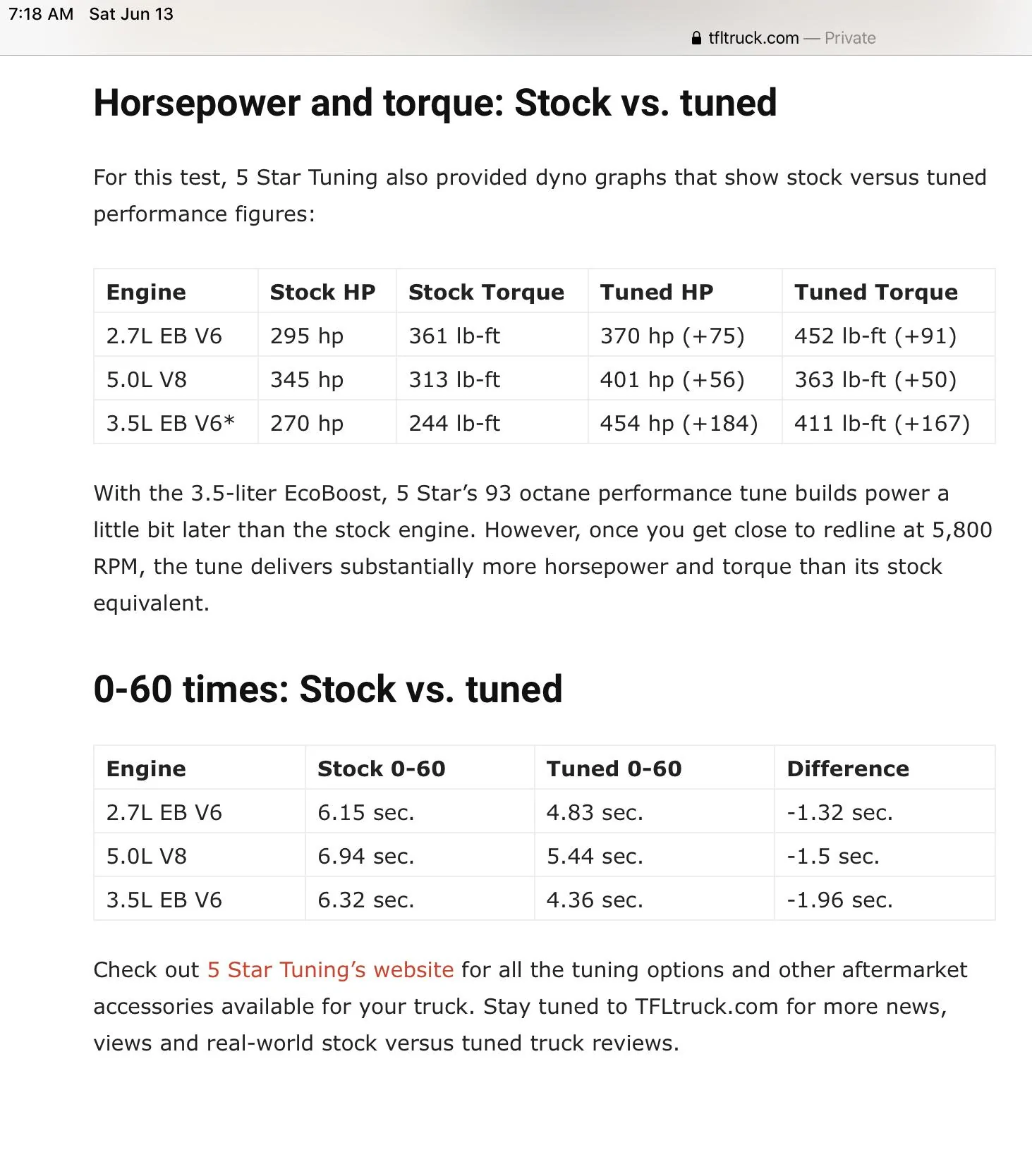

interesting comparison of different engines in F150 stock vs tuned. As far as the 2.3 goes, yes, it’s hard for people to grasp a 4cyl in their truck but that 2.3 has more hp and almost as much torque as any Previous V8 Bronco and with a tune it’s game over for any competitors in its class. Below is not the 2.3 but good comparison of the EBs vs V8
Ford Bronco 2.7 vs coyote power curve 6F119CA1-F52E-467A-8446-B1D0D05A0CAC

I’ve seen 2.3 ecoboosts running almost 400whp on e85 and bolt ons
