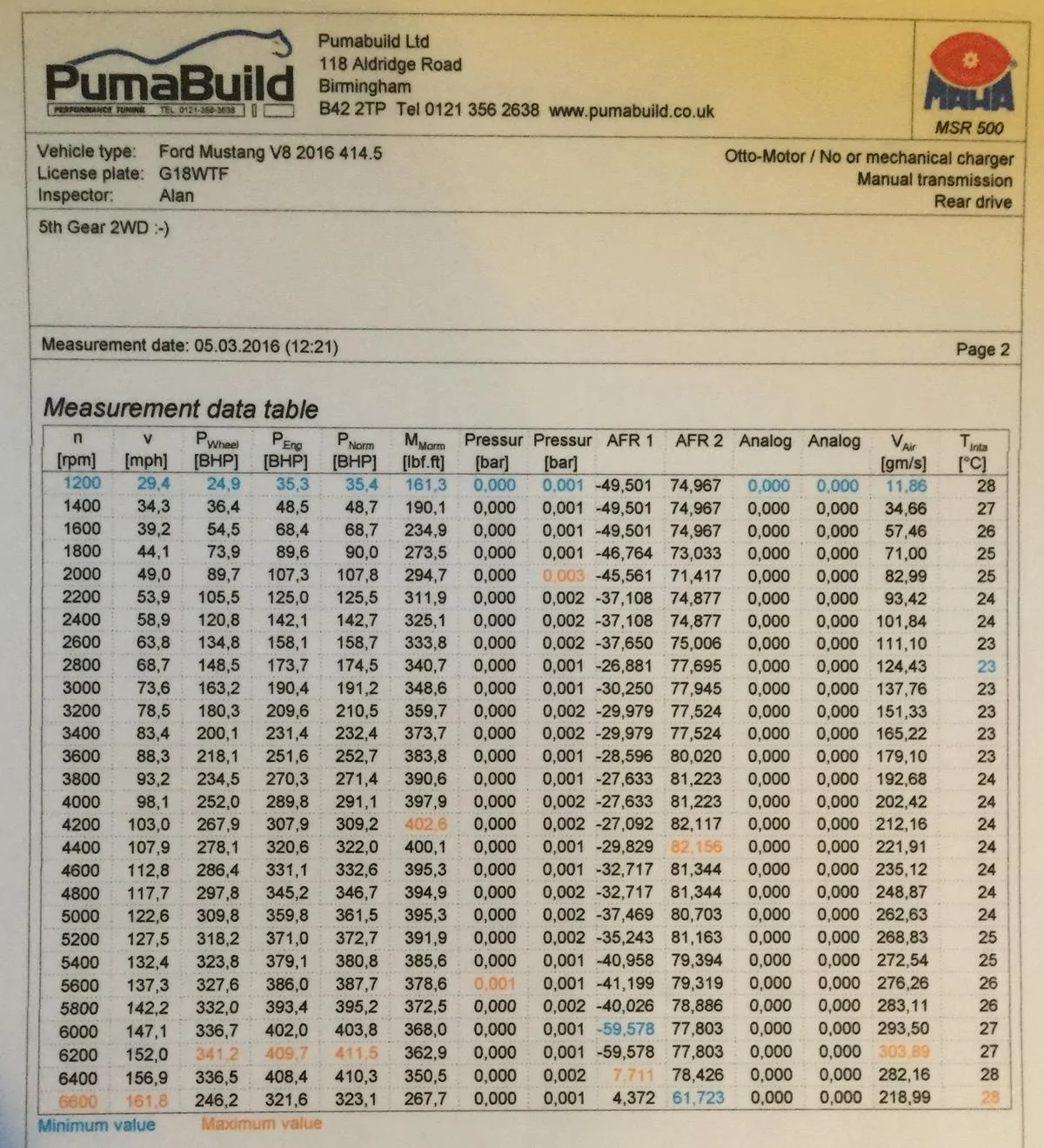

1. 2.7 is great motor and will put out more peak torque than a 5.0 tuned.
2. 5.0 is almost definitely not going in the new bronco (at least not any time soon).
That said, what you don't get with the 2.7 is shown @ 1200 RPM.
And that torque is available instantly, on and off the throttle consistently,
and will vary very little, even in really high temps.
And that is mustang cam/tune, truck will be even better.
Ford Bronco 2.7 vs coyote power curve img_6147-jpg

This is what I’m trying to figure out short of getting some test vehicles dirty. I expect the v8 to provide me a level of power early that it consistently growing but steady. I’m assuming the turbo will feel like a dirt bike with a power band, Im approaching something that needs a steady power source, then a little more throttle should do it, then Wamo, and that usually turns out ugly, or physically painful.
Is this typical of turbo vehicles, when trailing.

I've datalogged my 2.7 and it takes about 1 second to reach full boost, at speed already. Very quick compared to turbo setups of old. But an eternity if, lets say, you were trying to reverse gears and stop an endo. Overall most are going to be very happy with the spool times on the 2,7. Many will say there is no lag at all.
One thing I don't like though, and it doesn't happen that often, is part of Fords strategy to build boost, is to close the throttle (especially when you command a high throttle) to pre-spool the turbo. So if you are stopped, and get into it hard, but for whatever reason, you have to get out of it and then you get right back in it hard again. You can catch it sleeping, and get nothing. I've had this happen once in a while I was moving at say 35, I think I see an opening to pass and hammer down, but at last split second, you thought you saw something in mirror and back out. You realize quick it was your imagination and get back into it. And THUD, the thing feels like my low compression EVO out of boost.
Big balancing act trying to balance MAP/TIP/BPV/Wastgate, and throttle. Most of the time though, Ford does great job on that programming.
Great article on some of that here.
http://stratifiedauto.com/blog/ecoboost-tech-are-throttle-closures-bad/

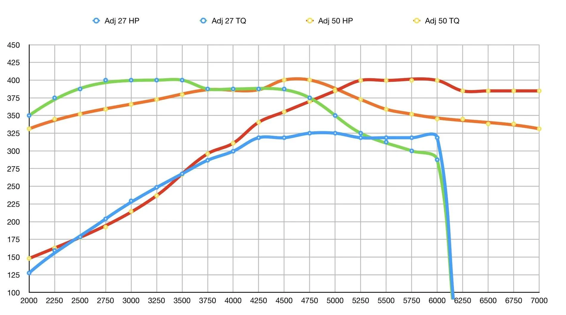

Adjusted Dynos based on crank peak power and torque (both off of 2018+ f150)
Ford Bronco 2.7 vs coyote power curve D9F5257D-D02A-4593-AC28-802CBA07F727
once those turbos spool you get a good amount of torque

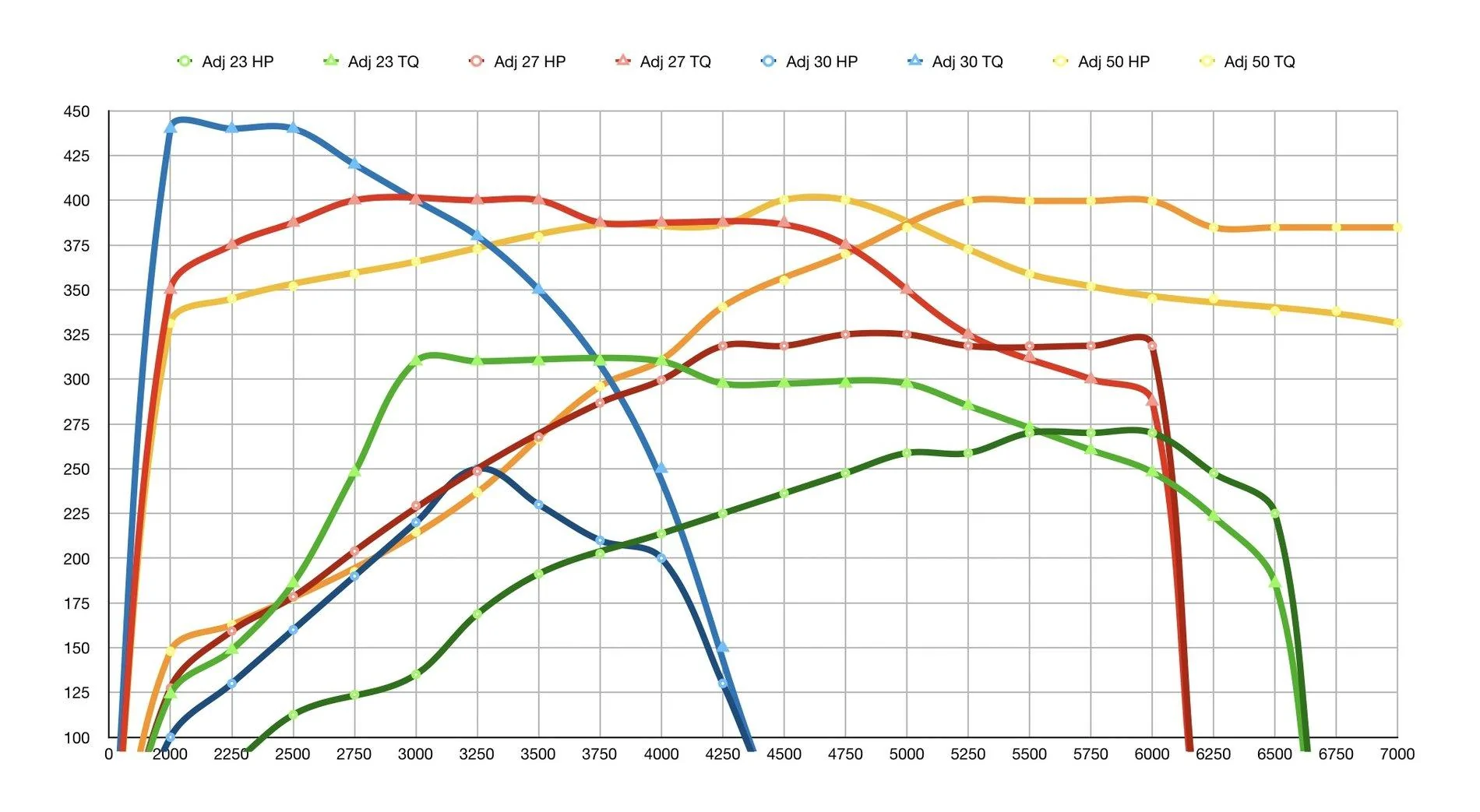

Ford Bronco 2.7 vs coyote power curve FCE65A40-6B71-402B-8025-092C883227ED
HP and Torque for the
2.3 Ecoboost (19+ Ranger)
2.7 EcoBoost (18+ F-150)
3.0 Powerstroke (18+ F-150)
5.0 Coyote (18+ F-150) ( Just as Reference)

Ugh, all I see are a bunch of colored lines with no distinction between who’s who.

top of the the graph. (Circles are hp triangles torque) Green 2.3. Red 2.7 Blue 3.0 Diesel Yellow 5.0
