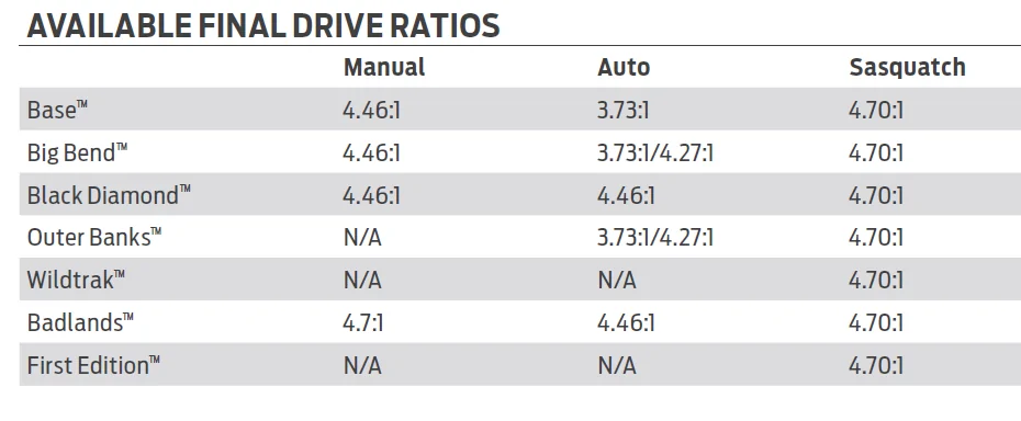

4.27 is very low. 4.10 used to pretty rare on the street. That was with 3 and 4-speed auto's. manuals will have crawl and auto's have 10 speeds.

Base is 3.73 with the auto, same as the Ranger and some F-150s.
I didn't realize there was a 3.73 offering. Still not going to affect reliability. Broken 2.3's are from early teething problems in 2015 and abused motors in later Mustangs. I think there is just a culture of V8 purists that cant stand for 4 cyl being an option trying to tarnish it.

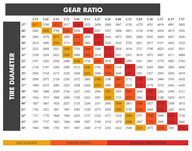

Tire size will reduce the ratio as well the F-150 with 3.73 runs a 31.5" tire not a 33" or 35"
Yeah, I didn't realize 3.73 was an option. It would be fine for a 30-32 inch tire, but if going 35" later, they should just consider Squatch. You get the bigger/cast front diff too.
It is not that I have seen, just using the F-150 example that @Haystack had used to get tires size and ratios in the same context..

if I’m reading the chart correctly, the 4.46 with aftermarket 35s should be around the “everyday driving” range.
