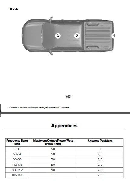

There's a recent thread here. Bottom line is that having an antenna giving off 50 watts right by the A-pillar can definitely cause interference with the vehicle's electronics. It also may be too close for electromagnetic safety.
OTOH, numerous people have a two-way radio in the front seat/dashboard area without causing interference. You do need to make sure the feed line is balanced so it doesn't itself radiate energy close to the electronics.

I would think that Ford anticopated two-way radios being installed in the Bronco. The design team joined Jeep clubs and went on outings with them. Jeep clubs also use two-way radios.
Public safety radios, (police, fire, ambulance, etc) can go up to 100 watts. No special precautions are taken with them other than proper fusing and grounding.
Within vehicle and equipment limitations antennas are usually mounted for optimum radiation patterns. The technician does check SWR.
Mobile radio designers realize their products will be installed in vehicles with a lot of electronics. In the case of public safety there may be a number of radios. When I worked for the State of Arizona, my truck had three radios in it on two bands.

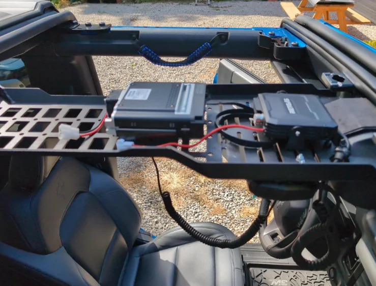

I also am running a 50W 2M/440 rig and GMRS in my Bronco. Of course, finding a place to mount this stuff is hard on the Bronco.
Overhead consoles in the tight Jeep Wranger JK/JL just didn't work for a guy my size. But this is not a problem with the Bronco: there is MUCH more headroom. Also, having a good overhead console can dramatically improve the supply and ground challenges. DV8 makes a good molle overhead panel, and that's what I opted for in mine. You can put there a USB hub, a hotspot for the digital modes, switches, etc. You end up with a solid mounting surface and VERY good grounding. You can route coax out the back over the top of the rear roll cage in a loom, if you like, and everything tucks up nicely. Best of luck!

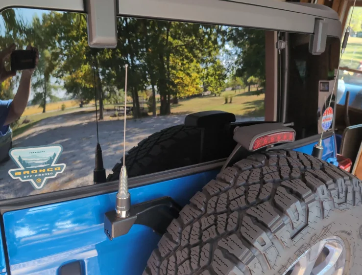

Also, I am not encountering any problems running 50W at all, with the antennas mounted as below. Since there is no RF ground plane on the MIC roofs, affixing (somehow) any transmitting antenna on these tops, running those frequencies at that power, would be "inadvisable." For the depraved hell-hole of CB, I just keep a little handheld nearby if needed.
