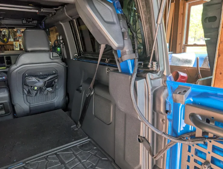

Yes, I routed the coax through the pressure relief opening in the tailgate. Just lifting one of the rubber flaps enabled me to route the two PL-259s without drama.
The trickiest part in implementing the two-antenna-either-side-of-the-spare option was locating a driver-side antenna mount. In the Jeep world, this is not a problem. But for the Bronco, I only found one source: MountainsToMetal:
https://www.amazon.com/dp/B0CV4L18G7?ref_=ppx_hzsearch_conn_dt_b_fed_asin_title_7
If you install a tailgate molle panel like the DV8 (below) you can zip tie and dress everything to the existing, OEM harness. The picture below show it BEFORE the cleanup.
