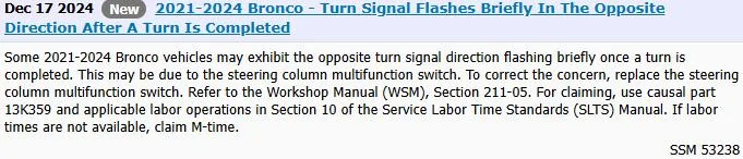

I have the same problem. Took it to the dealer and the service manager looked at it. According to this Ford is planning a fix.

It's awesome there is finally an official fix for this now! Thanks for the information @Ducati1098
