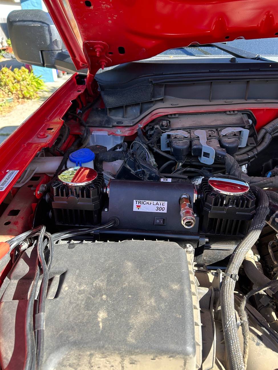

I thought about hard wiring mine mounted under the hood to the battery but it really isn’t a big deal to connect the alligator clips…would just need a 100 amp fuse inline and maybe a battery switch/relay…would not work with the 110v outlet…

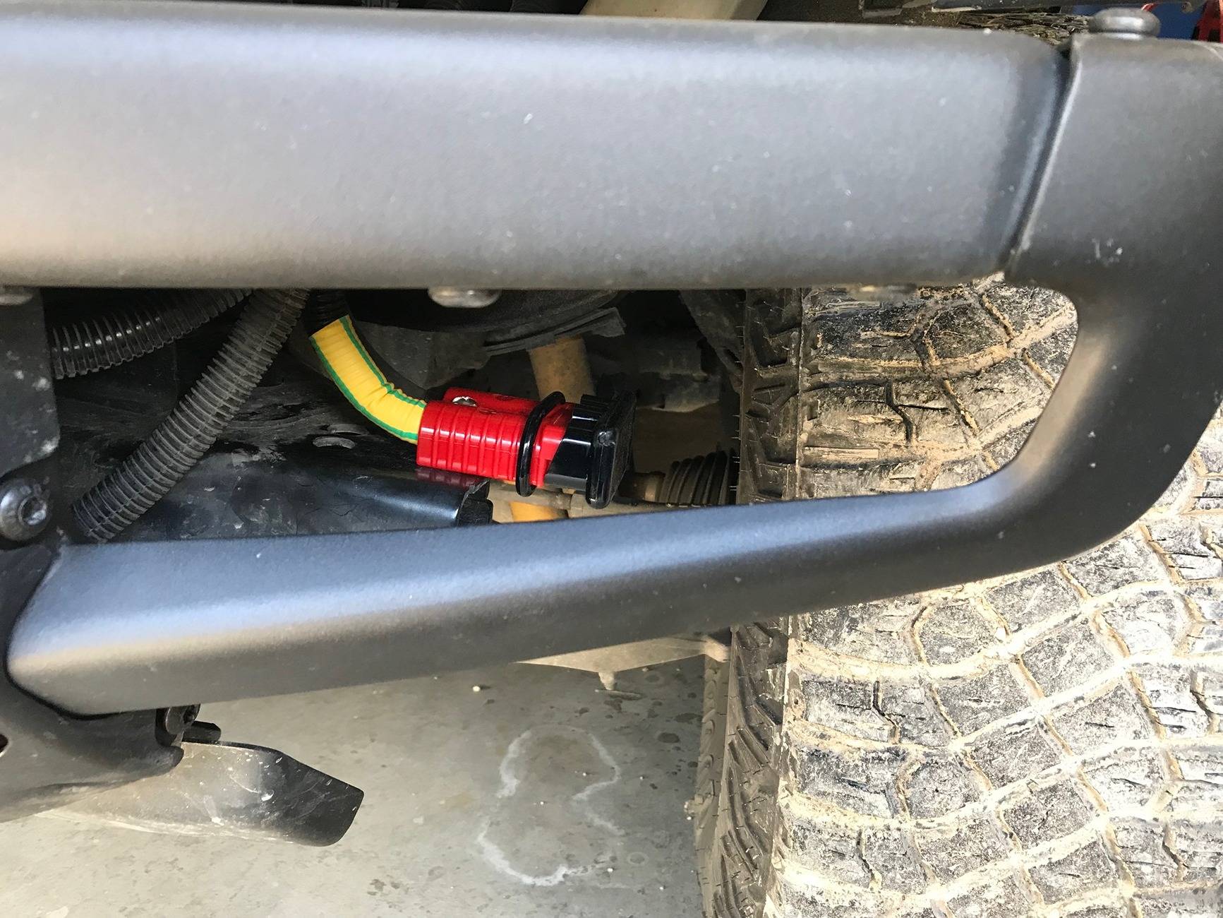

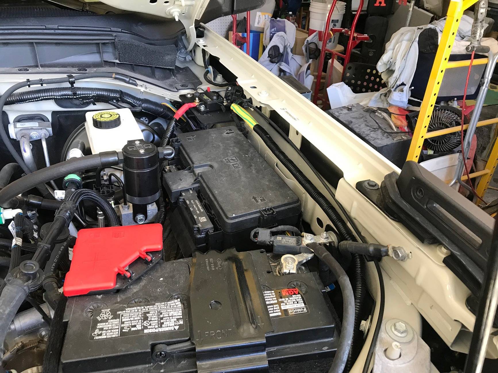

I removed the Alligator clips on my Trickflate and added an Anderson connector then attached the other side to the broncos crash bar mount behind the bumper I ran that through a 150A breaker. now I can fill my tires without lifting the hood.
This is the way. Technically you should be using the 100A ones but I use the 50s and it's been fine.
Yeah they only had the 50A or the 150A, I was afraid the 50A would keep tripping also I wanted to be able to use this connection for Jumper cables if needed, used them on our last beach run a couple with two small kids flagged us down and needed a jump. worked like a dream.
