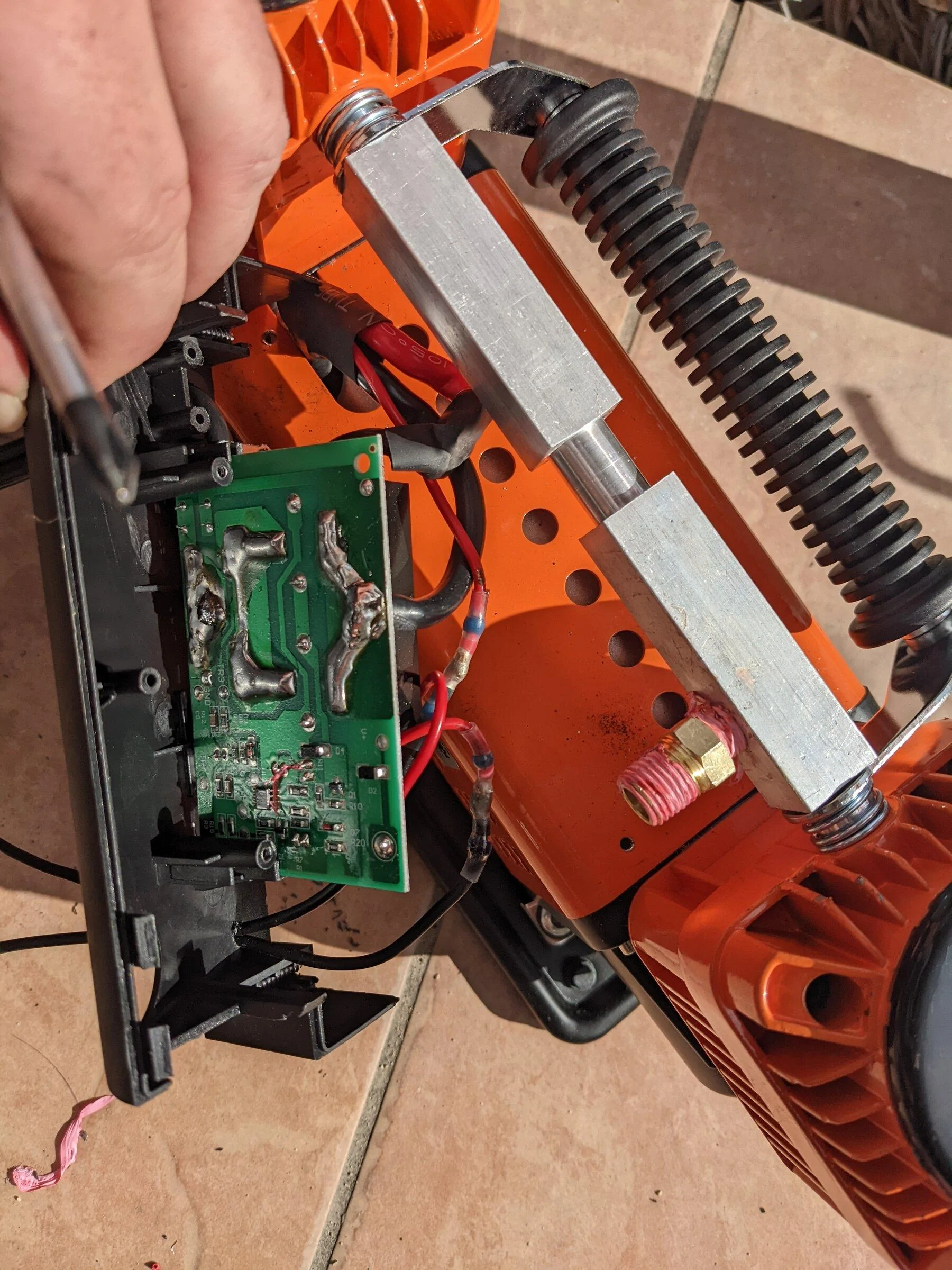

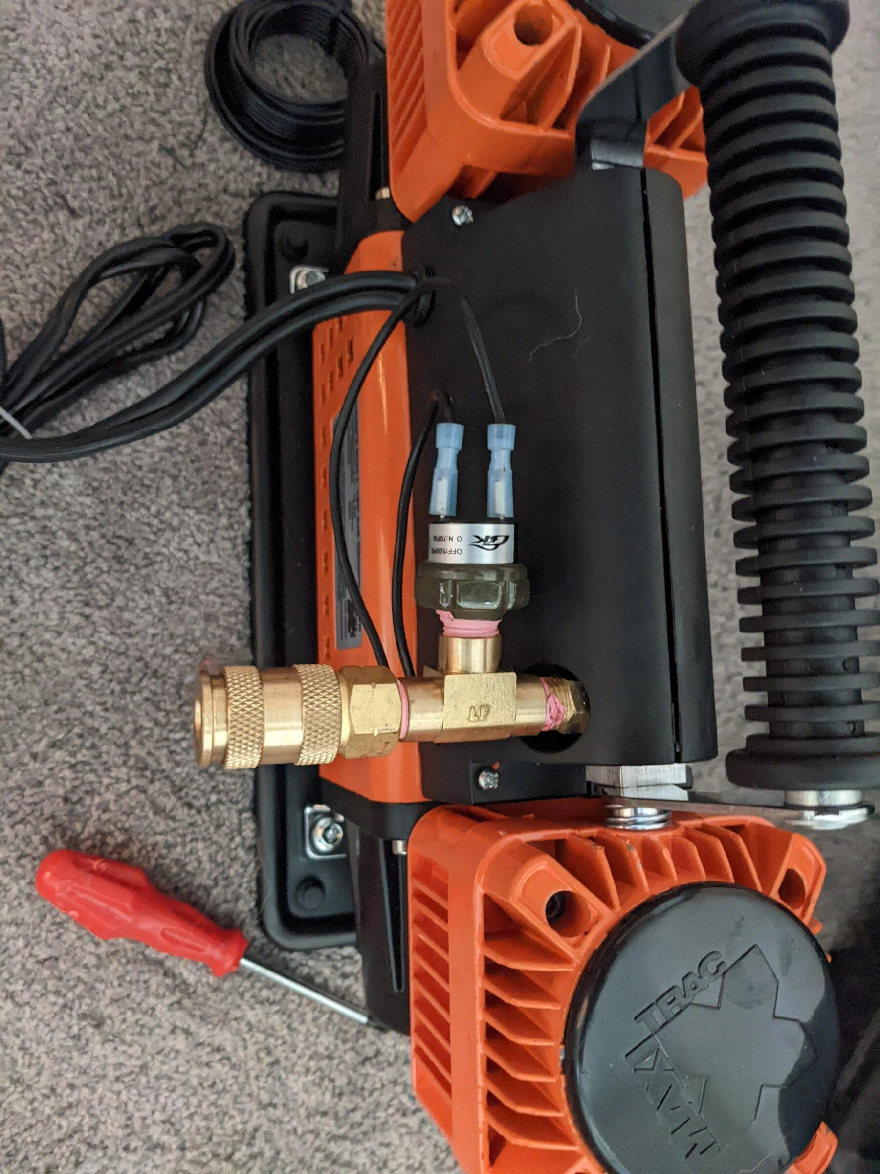

Wired a 70 psi pressure shutoff and put a standard Milton coupler so I could use my own air lines vs theirs (I guess is a Japanese style?). We'll see how it holds up. Noticed the stock electrical had some exposed wire strands....
