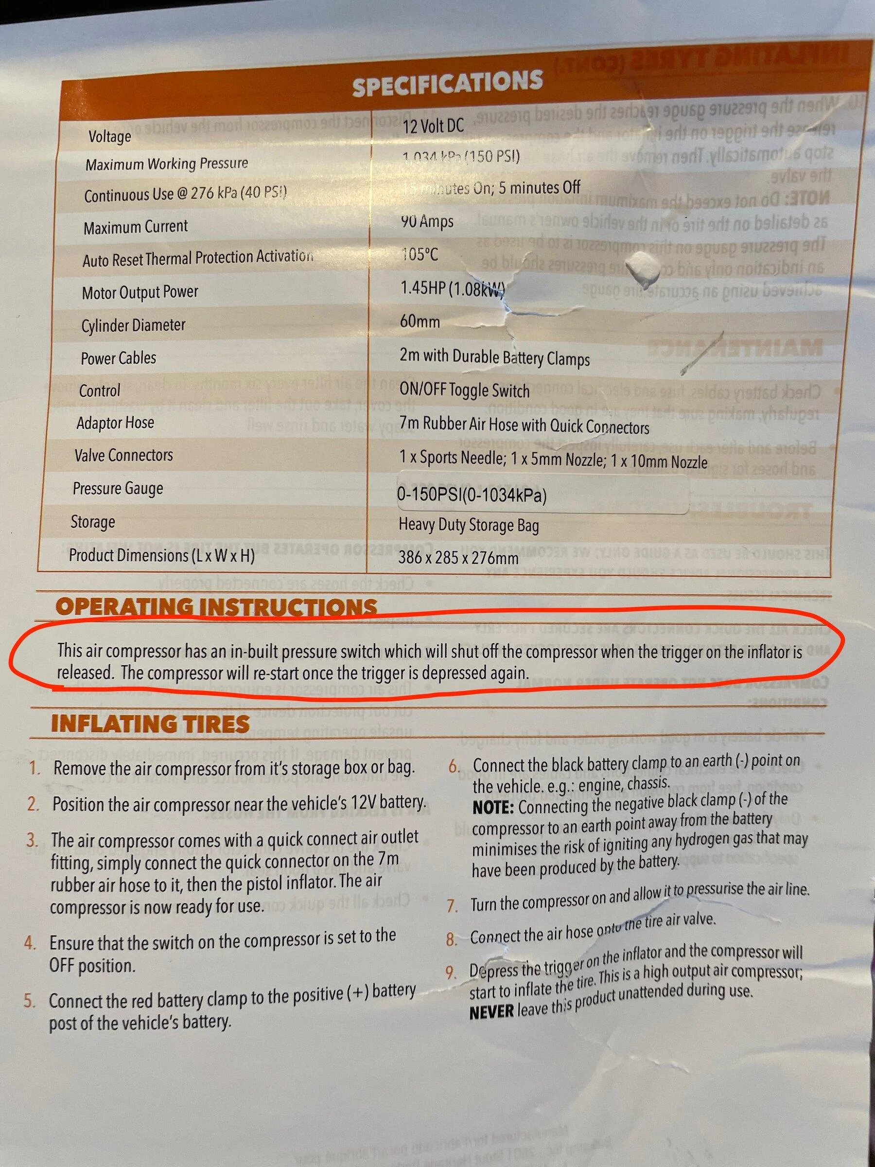

You had me scared, but it showed up 2 days ago. Also, found an oddity in the included spec sheet. Was this language in yours? I was about to do the modifications for the pressure switch (already bought the switch) when I found this language, but I haven't had a chance to run any tests.

awesome! glad you got it - and I didn't look at the instructions - not sure if it has that was on there or not

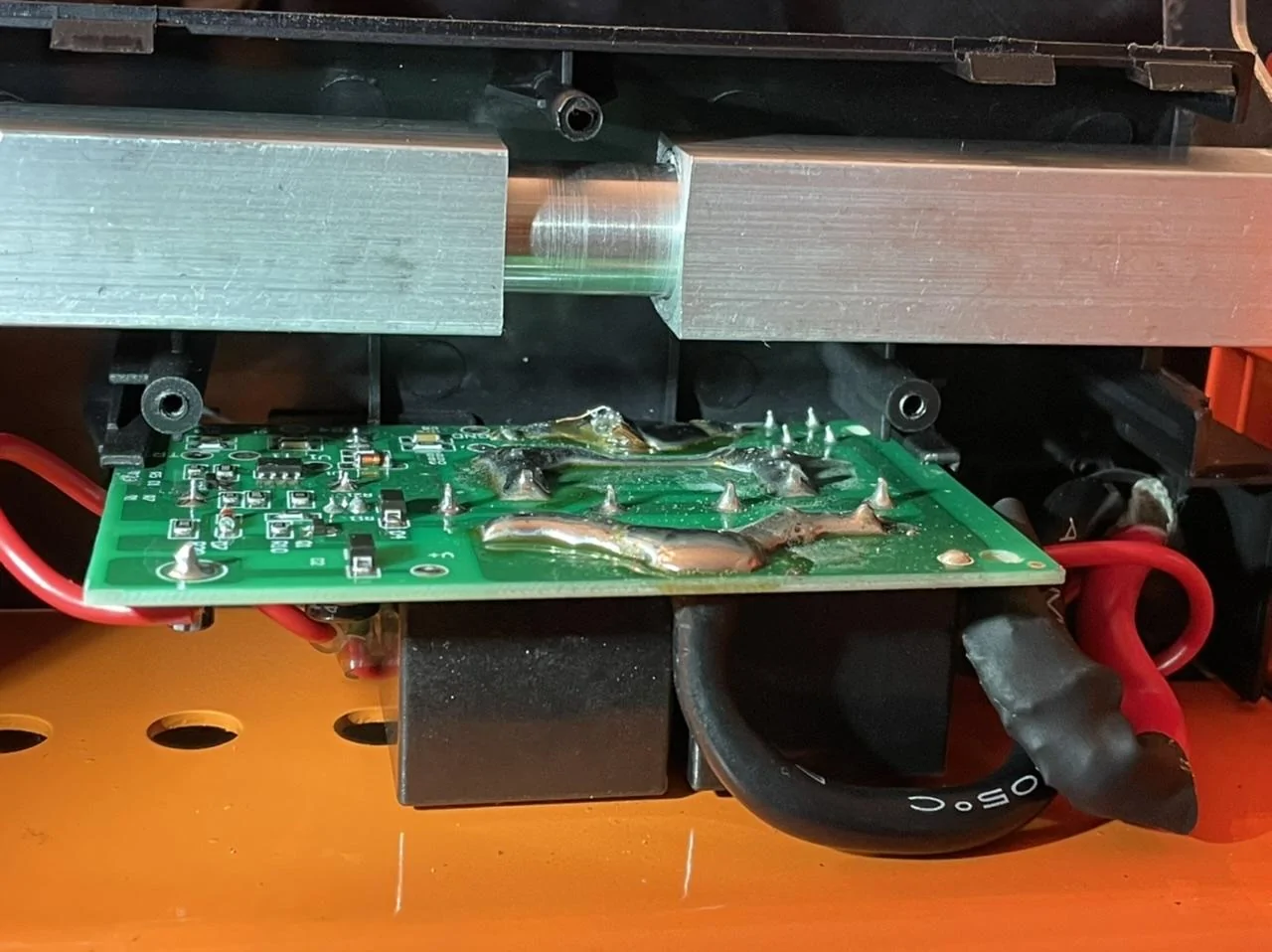

I opened up my brand new maxi trac today to double check wiring and this is what I found. Notice the poorly soldered stack of wires in the back. Assuming this isn’t normal. I don’t think I’m going to mess with it and will be returning to NAPA.
edit: the Facebook forum is telling me it’s no big deal. maybe I will give it a shot
If you decide not to keep it, shoot me a message and I’ll buy it.
