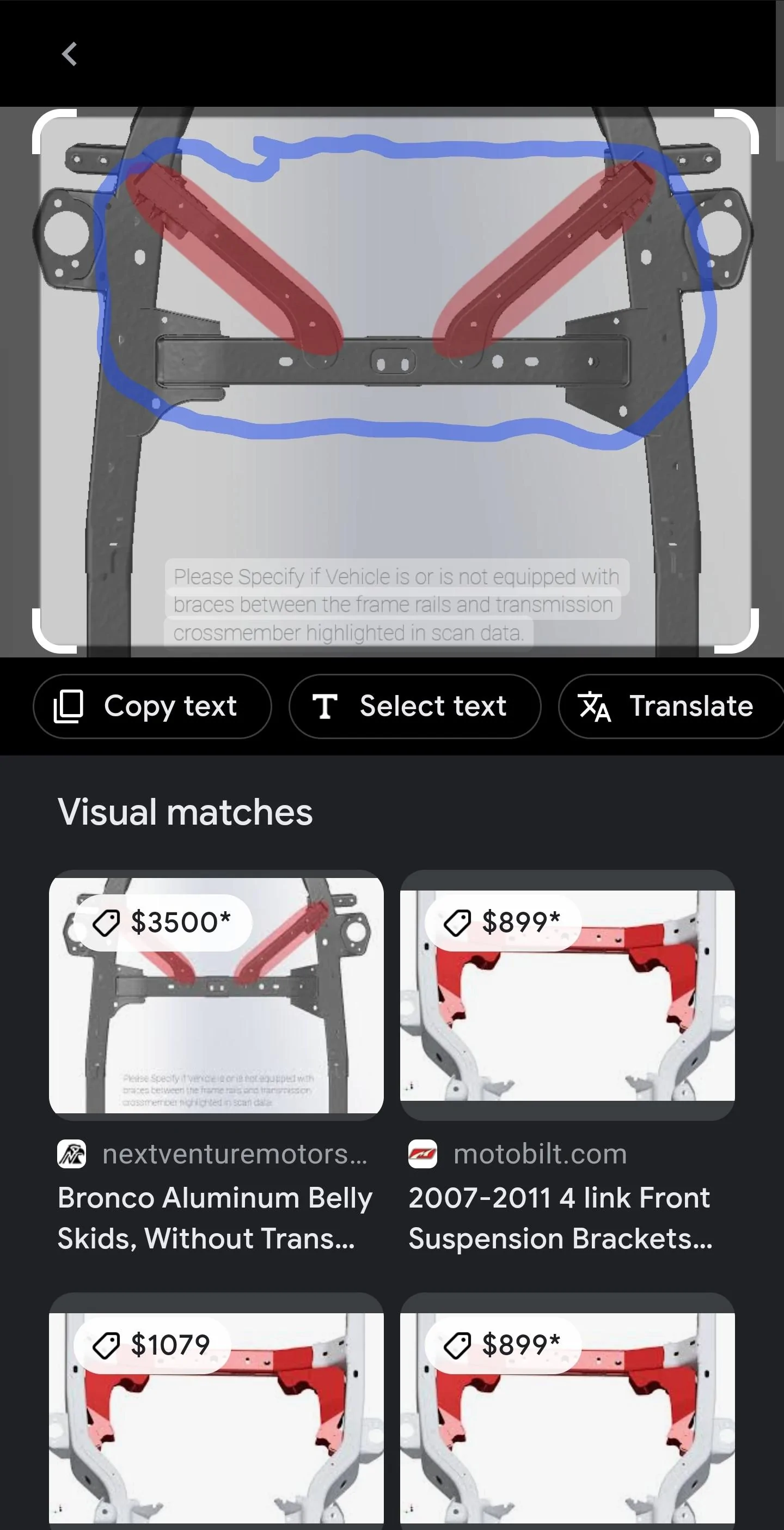

Hello!
I'm trying to find the part number for the above part-- but for the 2.7 engine. The parts website has #3 different options, all say it's the frame assembly.
Thank you!
From what I gather this is not really a part that you can order by itself, it would come as part of an assembly if at all.
Are you looking to get a set for a replacement or for retrofitting? Unless you're wanting to keep it in factory configuration there are better alternatives to bracing the crossmember without losing a lot of ground clearance. A local offroad shop will likely have the facilities to fab up something out of tubing that's stronger and won't snag on rocks, and they'd probably be able to incorporate a skidplate for the transmission pan at the same time.

Hello!
Thank you!
As others have stated, the "kickers" are only available as part of the entire frame assembly. Ford may decide to offer them as stand alone repair sections at some point but they haven't as of now.

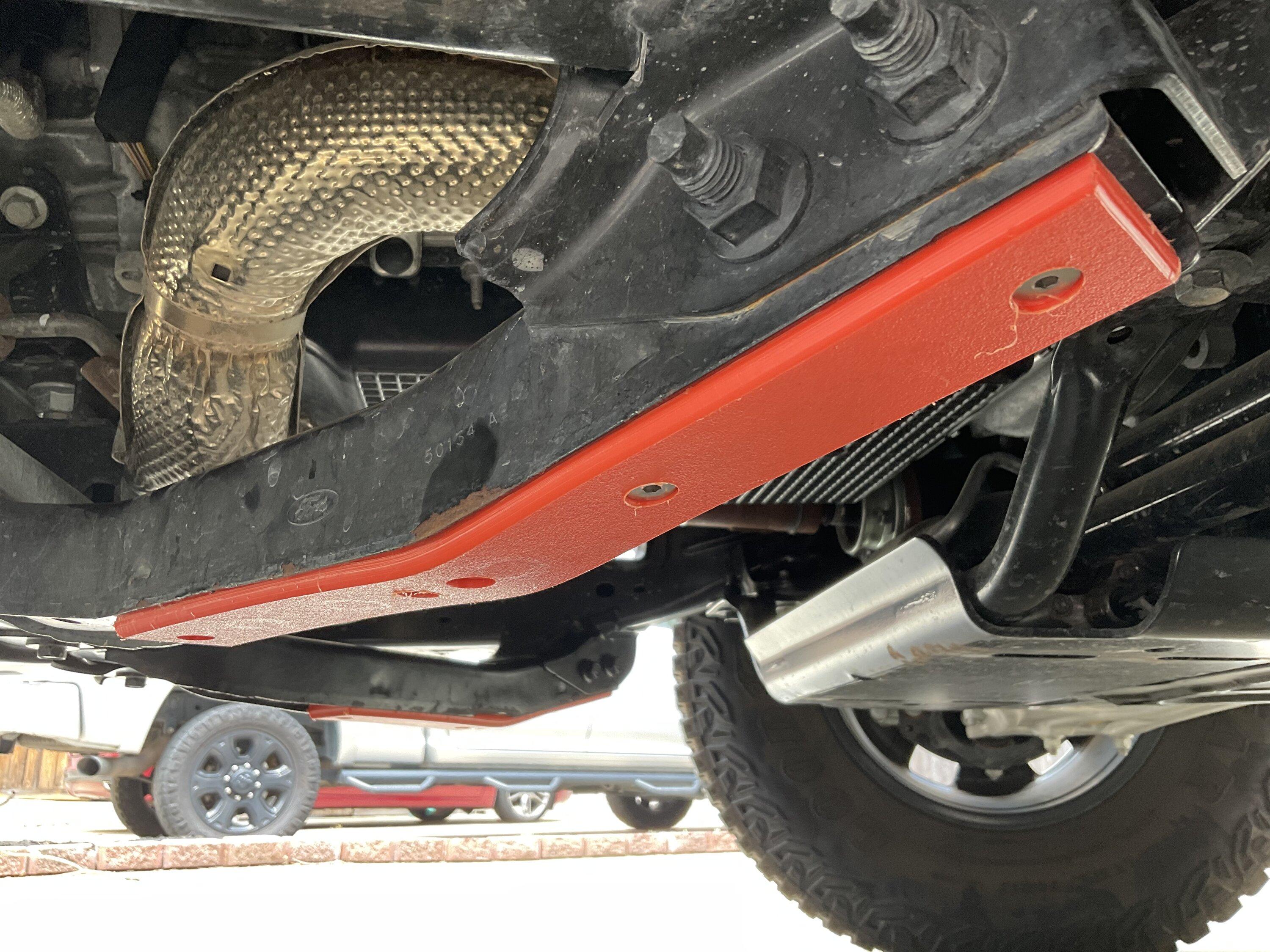

Thank you all for posting your installations. All very helpful. Completed mine this morning.
I was able to find UHMW in “Badlands orange” (well, almost). Used 1/4-20 (Mercian) hex socket flat head machine screws, drilled and tapped the cross braces. Countersunk the fasteners. Had to do some minor grinding to remove the rolled edges. Even drilled a drain hole in the plastic to match the cross brace.
