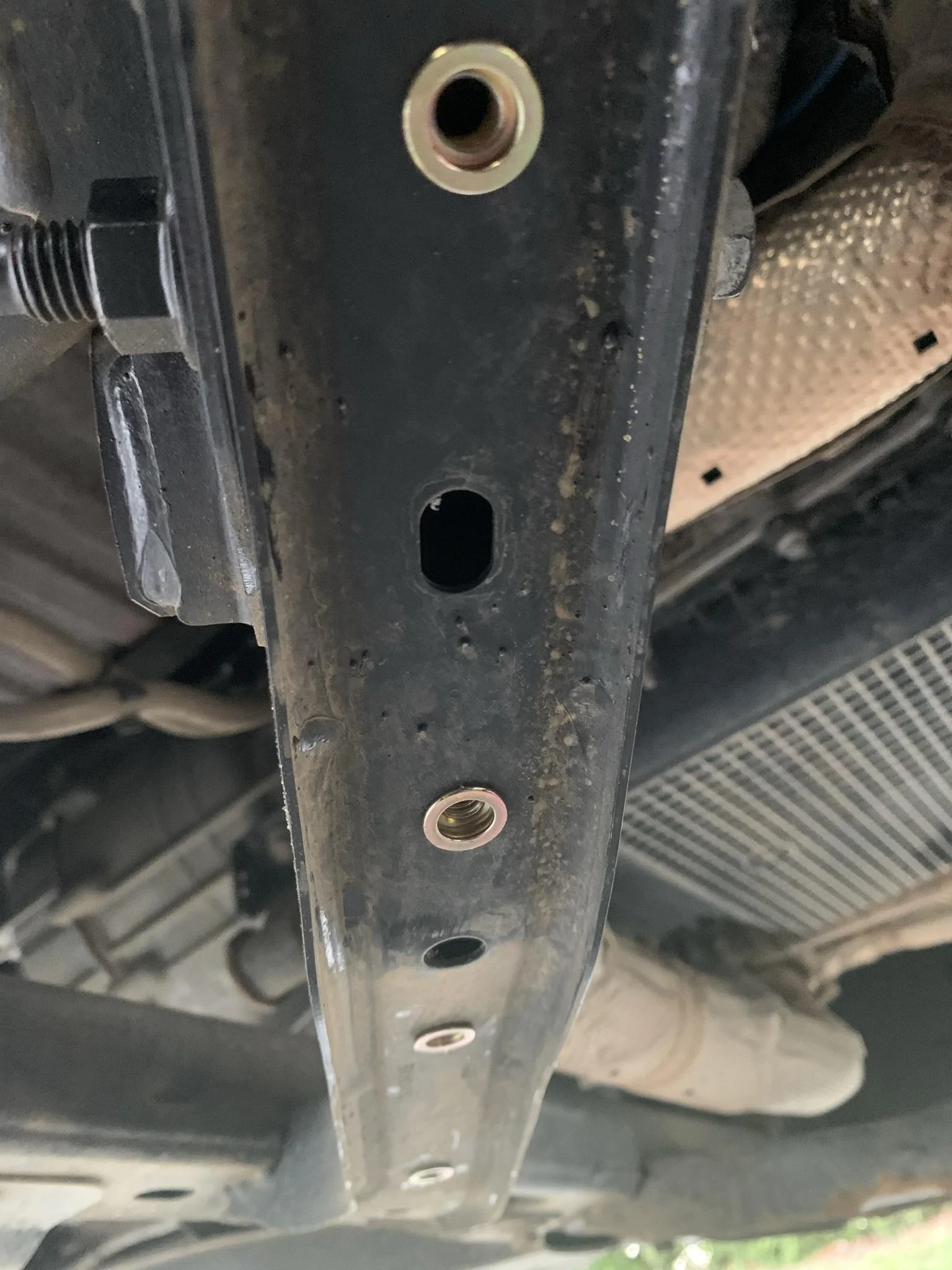

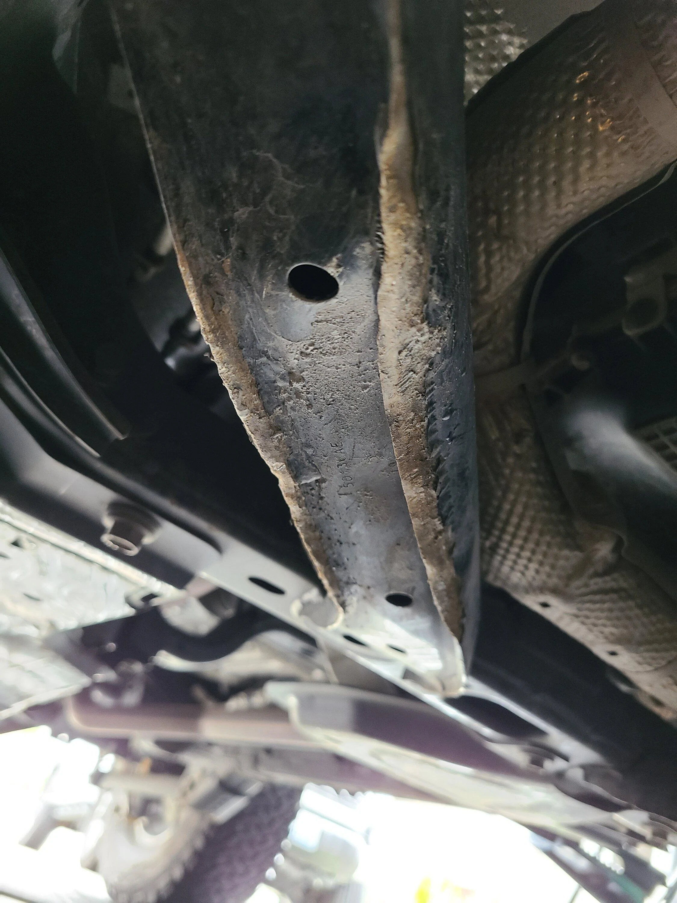

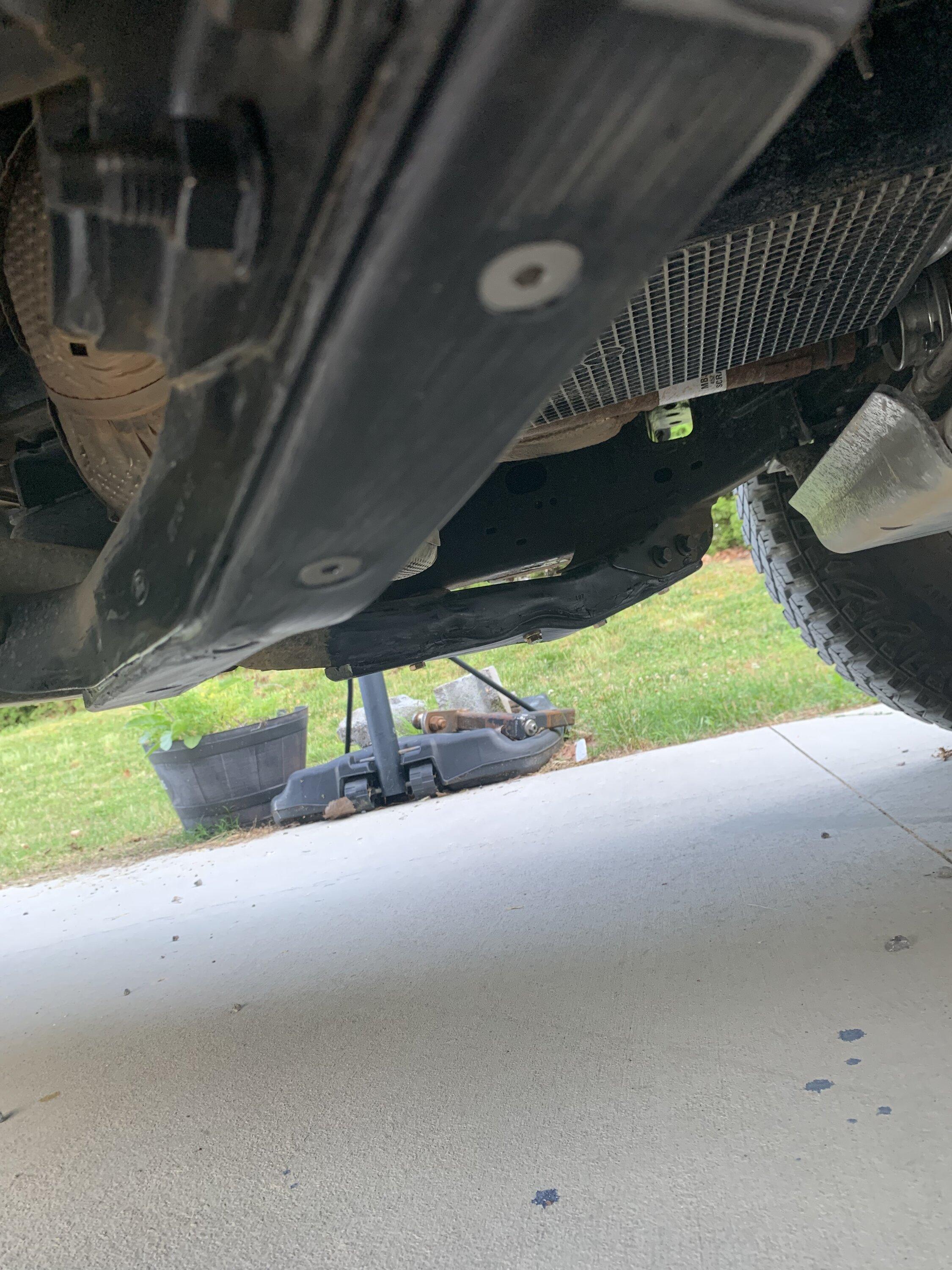

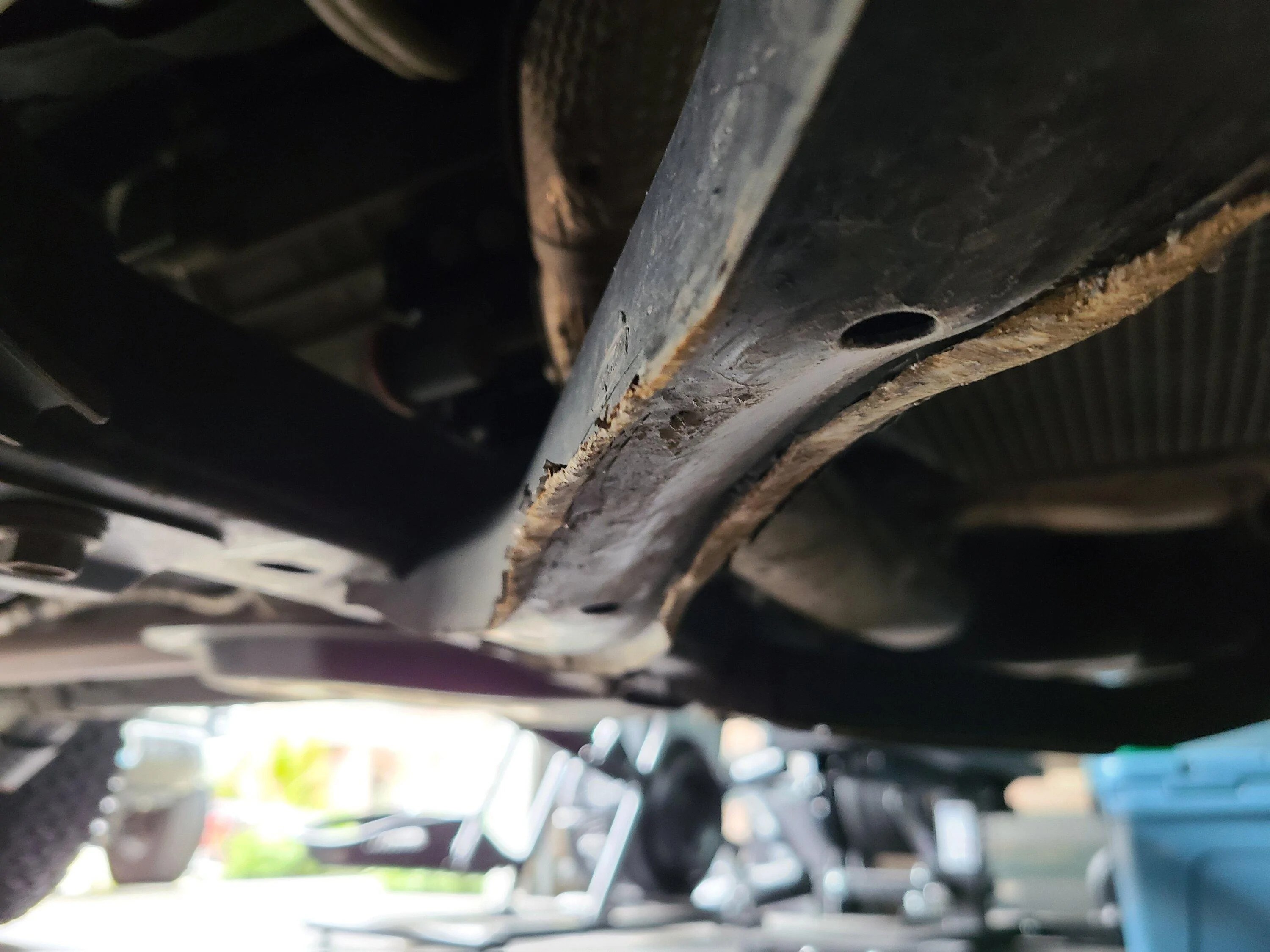

I should have gone the skid route when I first hit the cross-members months ago (only lip damage at that point). I banged the passenger side hard over the weekend. I'm going to clean and paint and hide with the RCI cross and trans skids.
Crossing my fingers no significant consequences...
Pretty much confirms I'm going to add the plastic skids before hitting the rocks.

Plastic ordered. I went with metric hardware because the rest of the rig is metric. Plus I have some metric rivnuts.

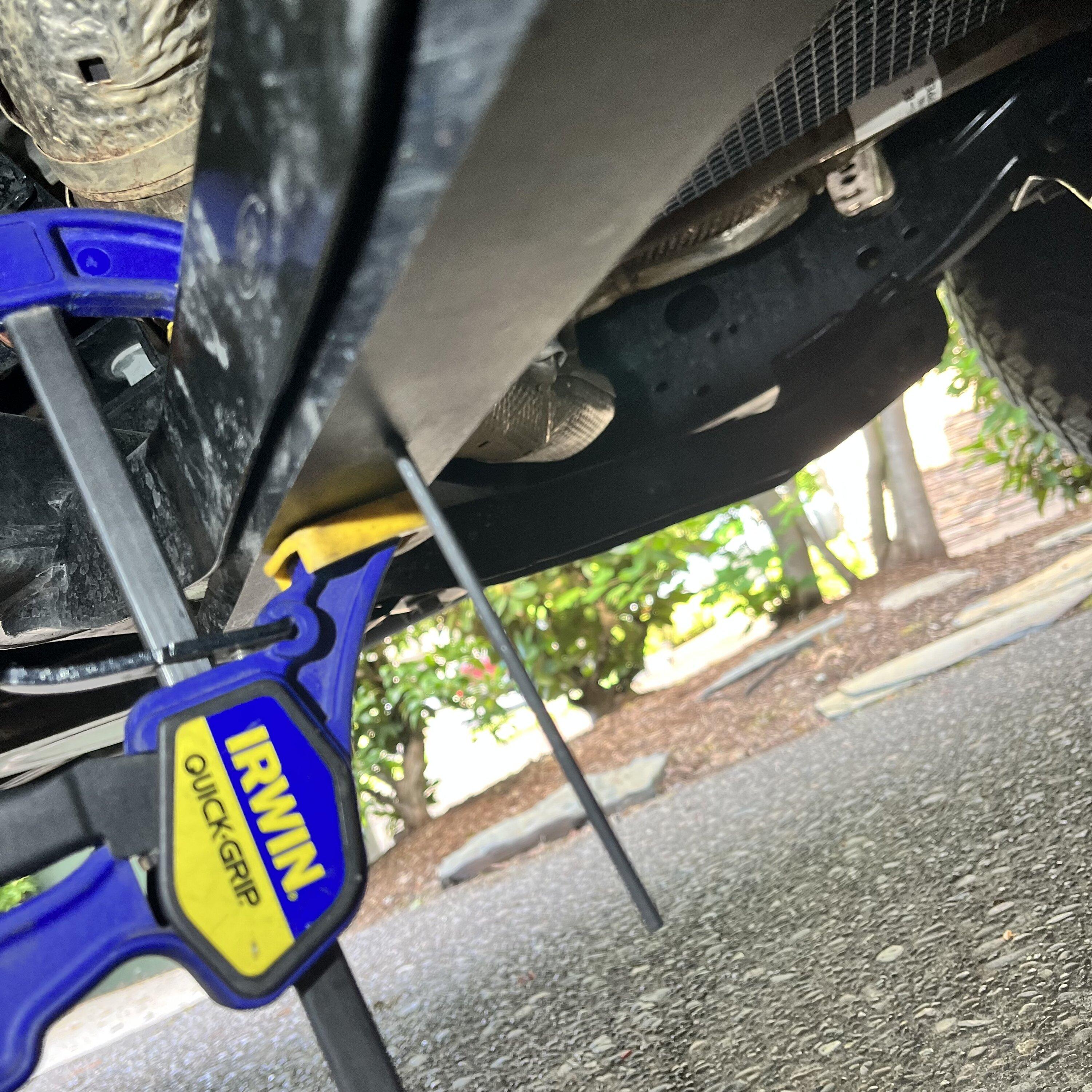

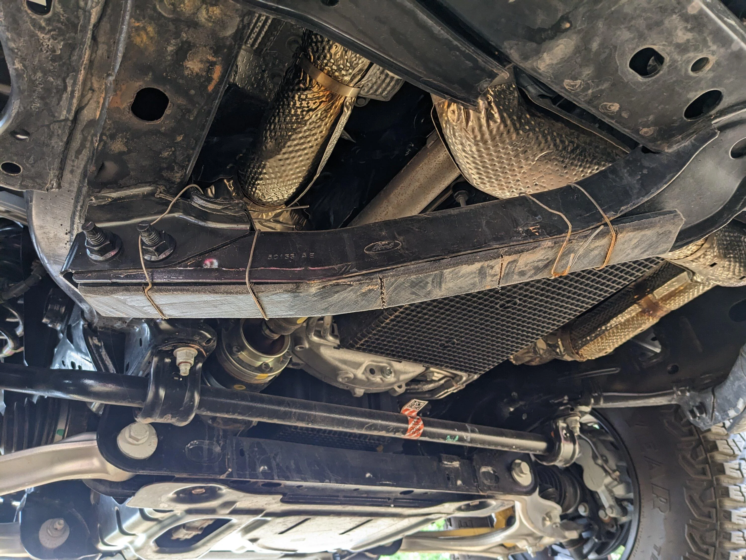

I did a quick fix at my Moab Airbnb and it seems to have helped. I undersized mine a bit but I would make them as wide as you
Ford Bronco Transmission crossmember braces - improve or remove? PXL_20230510_224116903
can cram in there to prevent any folding.

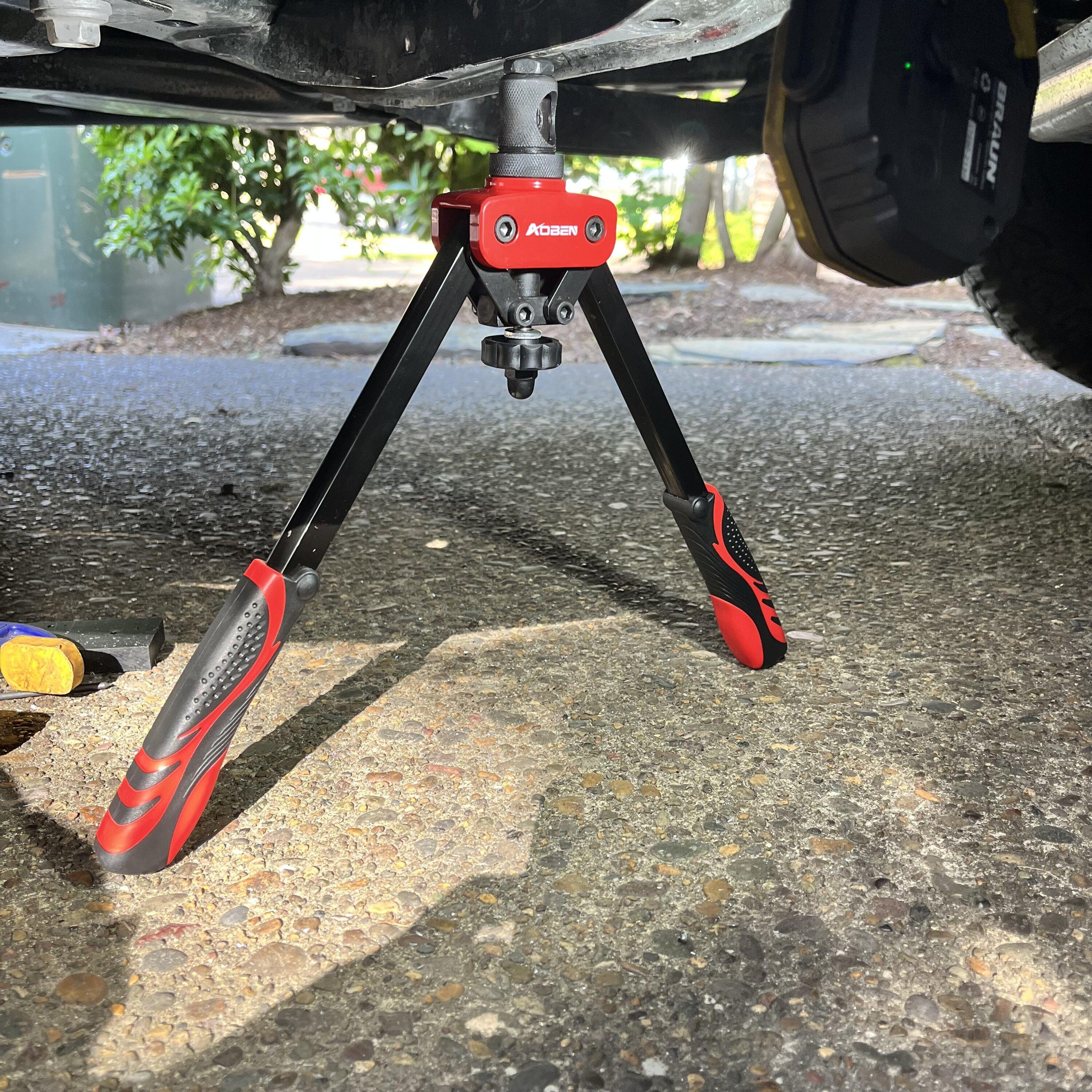

Rivnuts can technically be installed with just a nut and bolt, though using the intended tool is way easier. You would thread a nut on the bolt all the way to the hex, then install the rivnut on the bolt until threads are showing on the other side. Turn the nut down until it contacts the rivnut, place the assembly in the hole you want it in, and while holding the bolt stationary with a wrench, tighten the nut in a clockwise direction with another. It helps if you have a washer between the nut and rivnut and some thread oil, but it's not necessary. Keep tightening until you feel it start to bottom out, that's when you know you've fully deformed the rivnut. Loosen the nut, and the bolt should still be hand tight or close to it...your rivnut is ready to use.
I've found that when installing a rivnut, it's good to have a hole that isn't perfectly smooth and round. Take a small chisel and tap some locking "teeth" into the ID of the hole, so that when you go to loosen a tight bolt, the rivnut is less likely to spin. If you notice, the shank of the rivnut that mushrooms out has some splines on it, that's to help grip the hole when you install it...the teeth marks you put on the hole will help those splines grip better. Nothing sucks worse than a rivnut that lost its grip, you gotta drill that puppy out. Hexagonal rivnuts do exist that eliminate spinning entirely, but you have to make a hexagonal hole in your stuff too...not something most people can do at home. However you go about it, rivnuts are super useful and you'll wonder why you didn't start using these things years ago.

I see you did not use the existing holes. My M8 nutsert is just a little too loose in those holes to make me comfortable so I’ll drill new ones too.
Yeah same here plus the spacing didn’t satisfy my OCD enough.

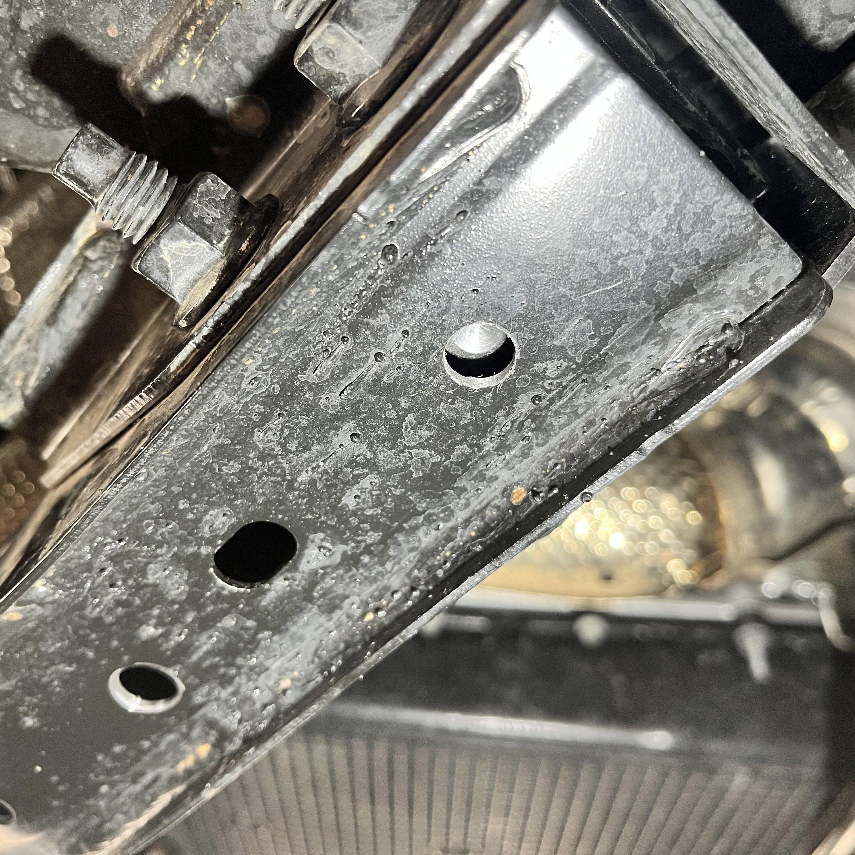

The furthest forward (and outside) is giving be grief. I went between the two bolts expecting a void. Didn’t find one.
Ford Bronco Transmission crossmember braces - improve or remove? IMG_0457
Bearcat1
Travis
Oct 20, 2021
283
387
45244
2017 Expedition Limited, 2006 BMW 330xi
I had the same issue, no void. I ended up just using the preexisting hole. It feels sturdy even without a bolt at the end. I would be surprised to see if rip off

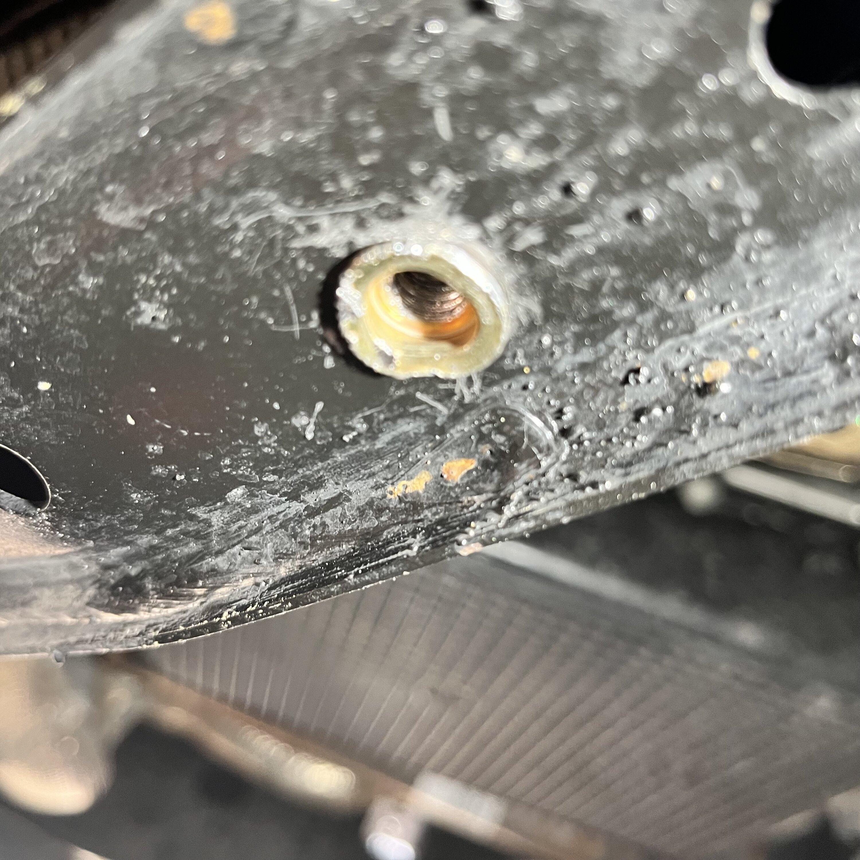

Nothing will ruin your day like a spun nutsert.:mad:
I’m going to give up and just be dainty in the rocks.
Hammer it flat and weld that puppy in.
I've had to do that a time or two because I couldn't get a grinder into a confined space to remove it.
broadicustomworks
Aug 25, 2020
42
4,112
16,725
Hanging Rock, North Carolina
I slightly undersized my holes by a 32nd vs the correct bit and they drew up nice and tight. Broke the rivet tool bolt off in one but it backed out easily enough, ordered a replacement insert for the next time.

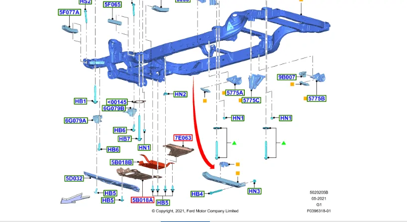

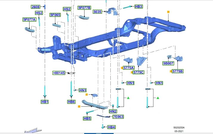

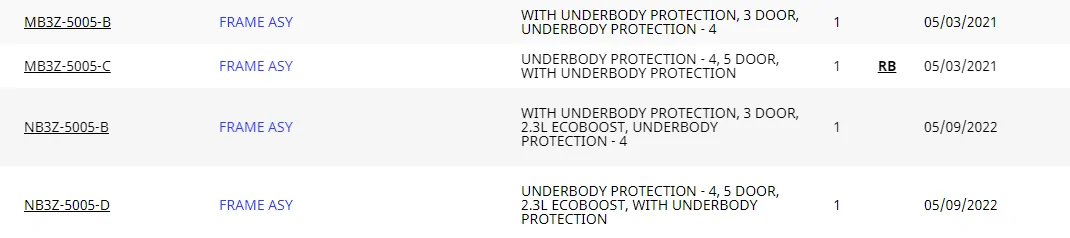

Only serviced with the whole frame assembly.
RB goes to MB3Z-5005-BN
Hello!
I'm trying to find the part number for the above part-- but for the 2.7 engine. The parts website has #3 different options, all say it's the frame assembly.
Thank you!
