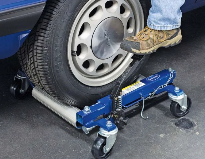

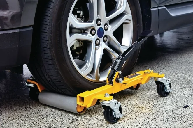

For removing the wheels/tires if needed for adjusting the shocks or rotating the tires get a set of 2 wheel dollys. Makes removing and installing the wheel easier. The yellow ones shown below are mechanical from Harbor Freight, The Blues one is hydraulic from Eastwood. I have two of each, I like the Eastwood version better as the height is easier to adjust. The exact same lifts are sold under various brand names, assume they all come out of the same factory in China. Your back will thank you.
Ford Bronco Adjust ICON Coilovers while installed, or remove & adjust? 1761184257349-24
Ford Bronco Adjust ICON Coilovers while installed, or remove & adjust? 1761184288326-6x
