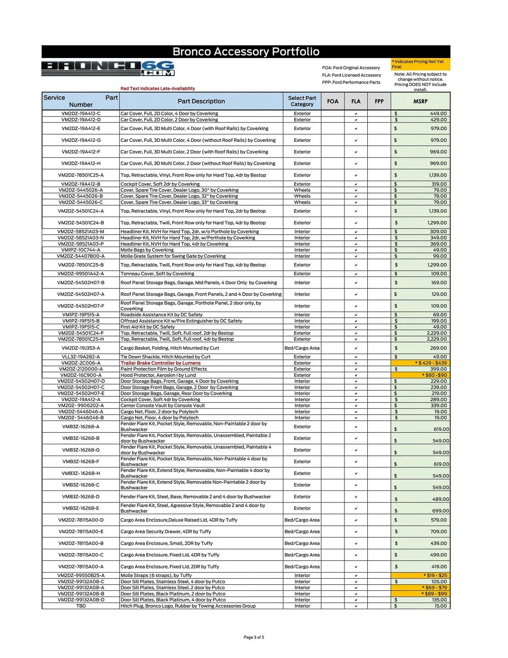

Not sure yet... but the tow package has a 7-pin connector and there is a brake controller listed in the accessory list that recently came out.
I’ll see if I can find it..
::EDIT::
In red for late availability. A little further than halfway down:
I suspect it’s this: https://accessories.ford.com/module-trailer-brake-12688.html
Of note, the product page for that says it requires factory tow package.
429 seems like an absolute rip off. I feel like they are around 50 bucks at the parts store.

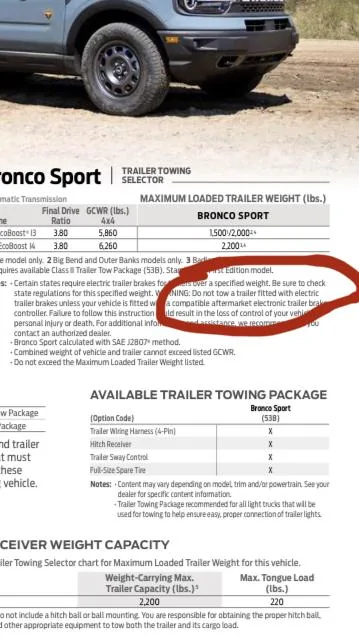

1000% People will be sorely disappointed when they can't actuate the trailer brakes if they are expecting some Bronco magic. The F trucks can order a trailer hitch/wiring without the brake controller- looks like the Bronco is the exact same, except NO WHERE has there been shown a built in brake controller like the F150-Superdutys.
You can "wish" it all you want, but as someone who has managed a fleet of over 3000 vehicles, you will need an additional brake controller on the Bronco. I have built multiple triple axle 21k electric over hydraulic boat trailers and am well versed in how trailer brakes work.

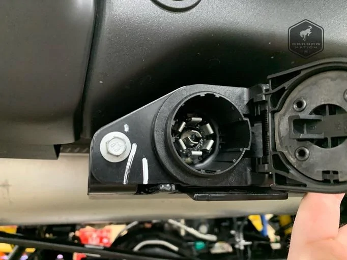

As pointed out, it has a 7-pin connector with the factory tow package... and the factory accessory brake controller states it requires the tow package... so that to me suggests at least *some* prewiring is done with the tow package.
