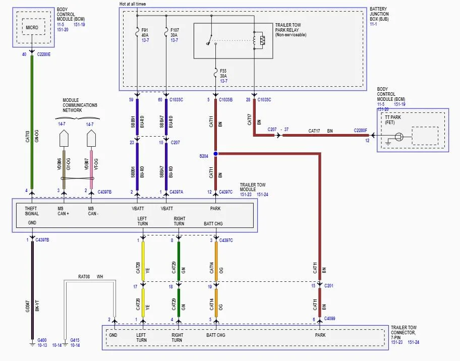

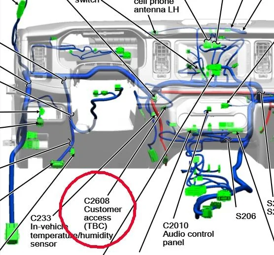

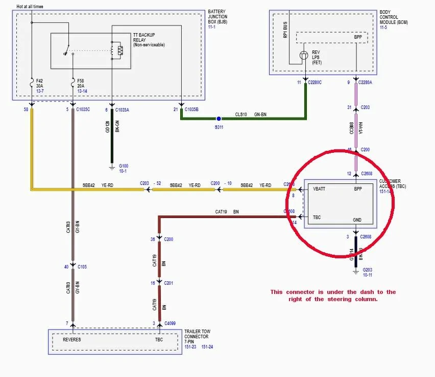

Ok, this is the best I'll seen yet, straight from the Ford 2021 Bronco wiring diagrams. For sure with the towing package they will be wires for the brake controller. There are other components that are also included as you can see in the drawings. Don't know what wiring will be there if you do not order the towing package.

Excellent post. Thanks for sharing. I had hoped that Ford would offer an integrated brake controller, but I understand why they don't. But at least this is in place to make adding one a cinch.

You won't even have to do that - if its prewired, then you just need an adapter to go from the controller to the pre-existing plug under the dash, and you won't have to tie up a 12V port. But even then, aftermarket controllers don't have the benefit of the OEM integration. The later is seamless in my experience.

I think if you order the tow pkg the wiring is installed for the controller to plug into
