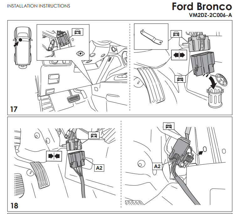

There is a plug on to the right of the steering column, if you have tow package.

It's under the steering column to the RH side.

When I got my Bronco it did not have a tow package or a brake controller. I added the tow package and the factory wiring for it. I also bought the brake controller from Ford and it was all plug and play. Instructions came with it and it wasn't too bad.
