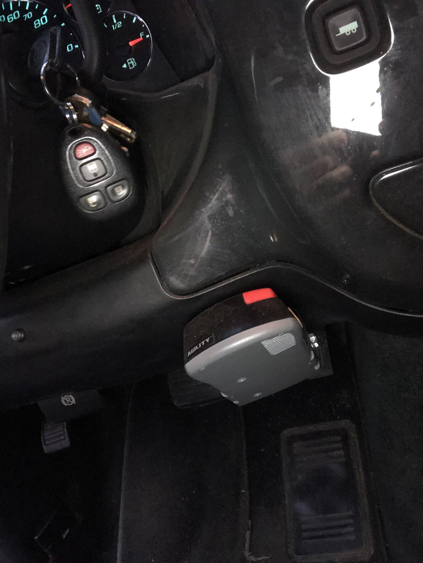

Definition of prewired: My Silverado was ordered with a tow package. Under the dash was a “prewired “ connector that plugged directly into the brake controller that I added. Does that come with the tow package on the Bronco like my Silverado did?
Hitting the nail on the head--
I have not seen that answer anywhere yet...Hoping so! I want to add a brake controller, but I would spend far less than that factory option hopefully and get a much better product. If its not prewired, I intend to use this

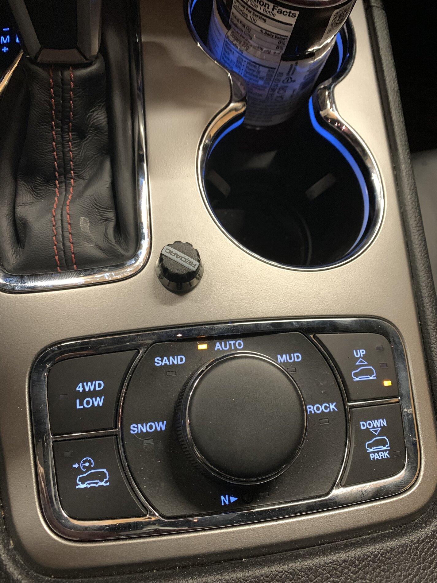

If they’re anything like Jeep, Ford SHOULD offer a brake controller accessory option for purchase from the dealership.
I mentioned it before, I love the redarc tow pro product. Was a simple plug and play harness on my wife’s grand cherokee that came from the factory with the tow package and 7/4 pin connections at the bumper.
