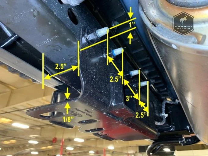

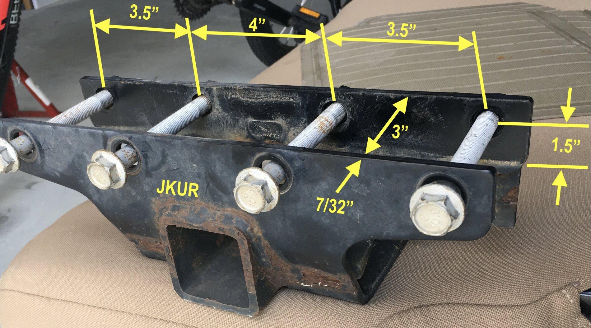

Went and looked real close at the hitch receiver at the Crossroads Apex dealer event today: I am pretty underwhelmed - and think even 3500lbs is questionable with the thin thing they have on there.
So my JK receiver rated for 3500 bolts 1-1/2” up into a 3” thick frame, with four bolts across 10”. It is ” thick.
The Bronco one bolts 1” up into a 2-1/2” frame with four bolts across 8”. It is 1/8” thick. It literally looks like a whimpy 3/4 scale version of the JKs; not something designed to tow off road.
The bare frame demo pictures looks ok: the frame even looked reinforced. But after seeing it in person, I am seriously second guessing. This may not work at all for me, and definitely needs a more rugged option.
So my JK receiver rated for 3500 bolts 1-1/2” up into a 3” thick frame, with four bolts across 10”. It is 3/16” thick.
That's very disappointing, since you'd think the 3500lb limit was specifically in place with the idea that you would be towing little teardrops on trails. If it's only suitable for that silly tow cap in good driving conditions then they really really missed the mark.

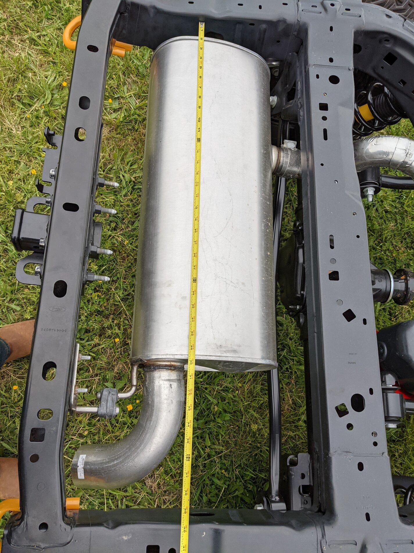

You have a pretty good idea of what the specs are. Maybe the next time someone has access to the demo frame, we can amplify the hitch pictures and measurements. Still scratching my head on why this is constrained unless the trailer brake wiring or circuitry is the culprit.
