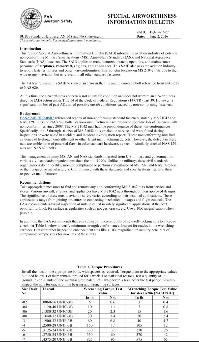

Don't worry, even real aircraft fasteners aren't real. FAA released this a couple days ago.

That does not sound like it's going to be cheap to rectify due to the hours spent on the scavenger hunt multiplied by size of fleet. Then add the variable of the size of stores (stock) of suspect hardware is on hand in need of replacement :unsure:

Thankfully it isn't mandatory or regulatory, and the FAA isn't considering it a safety of flight issue. Out of curiosity, I looked up one of those part numbers and we have several thousand on each of our planes. We also use reputable distributors (not Amazon or military-fasteners.com) so I'm not too concerned.
