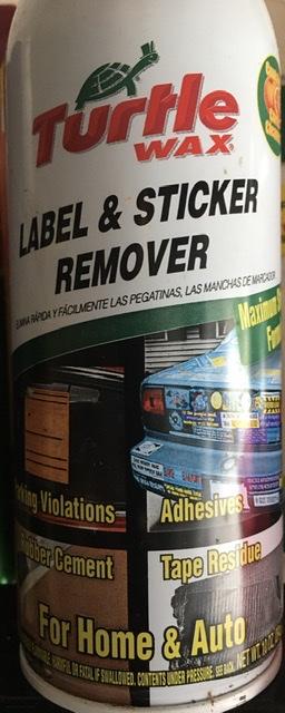

Every car I have ever bought I have insisted on no dealer advertising. Almost every time the car was delivered with it on, and I have forced them to remove it before signing the final deal. Takes about 15 mins in the detailing shop. There is a specific TurtleWax remover they used. Works when you need to remove your RUBICON decals that are starting to peel and replace them, etc. as well.
Ford Bronco Debadging Question 6752B64A-39A9-4F92-BA95-9FBE41D453EA
