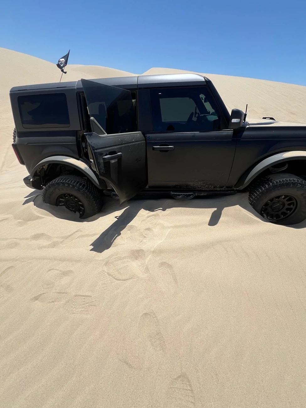

I tend to lower mine to 20-22 psi anytime I’m off road. I don’t know how much it helps with grip vs the 35 psi I run on road, but definitely more comfortable. And one exception: if I’m in the sand dunes, I’ll go as low as 10 psi after learning a very hard lesson…
If only you had remembered to take off the removable steps from your rails I'm sure that would have never happened :ROFLMAO:
