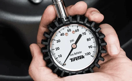

I use my Air gauge and make sure that I have it up to 100%.
Ford Bronco PSI tire pressure on 35's? 1714403621545-fd
