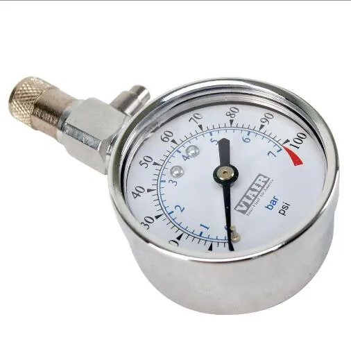

I've been told that you just need one of these to be sure you're at 100% full.

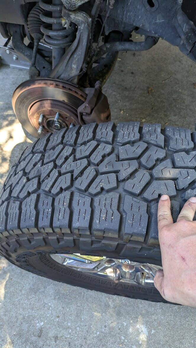

37 to 42lbs depending on the season if you want a long tire life. These are my 285/75R18 Falken AT3 with 60k miles on them off my F150. I find that a slightly higher pressure gets me a bit better tire life and better fuel economy. These also have an Iowa winter at 20psi on them.
Those pressures may work for your F-150, but running 37 psi on my Bronco wore the centers of my tires badly. Ford recommends 39, but that's definitely way too high and severely shortened the life of my tires. That is fine since I want to get rid of the GYs anyway, but I won't be running anywhere near that high on new tires.
