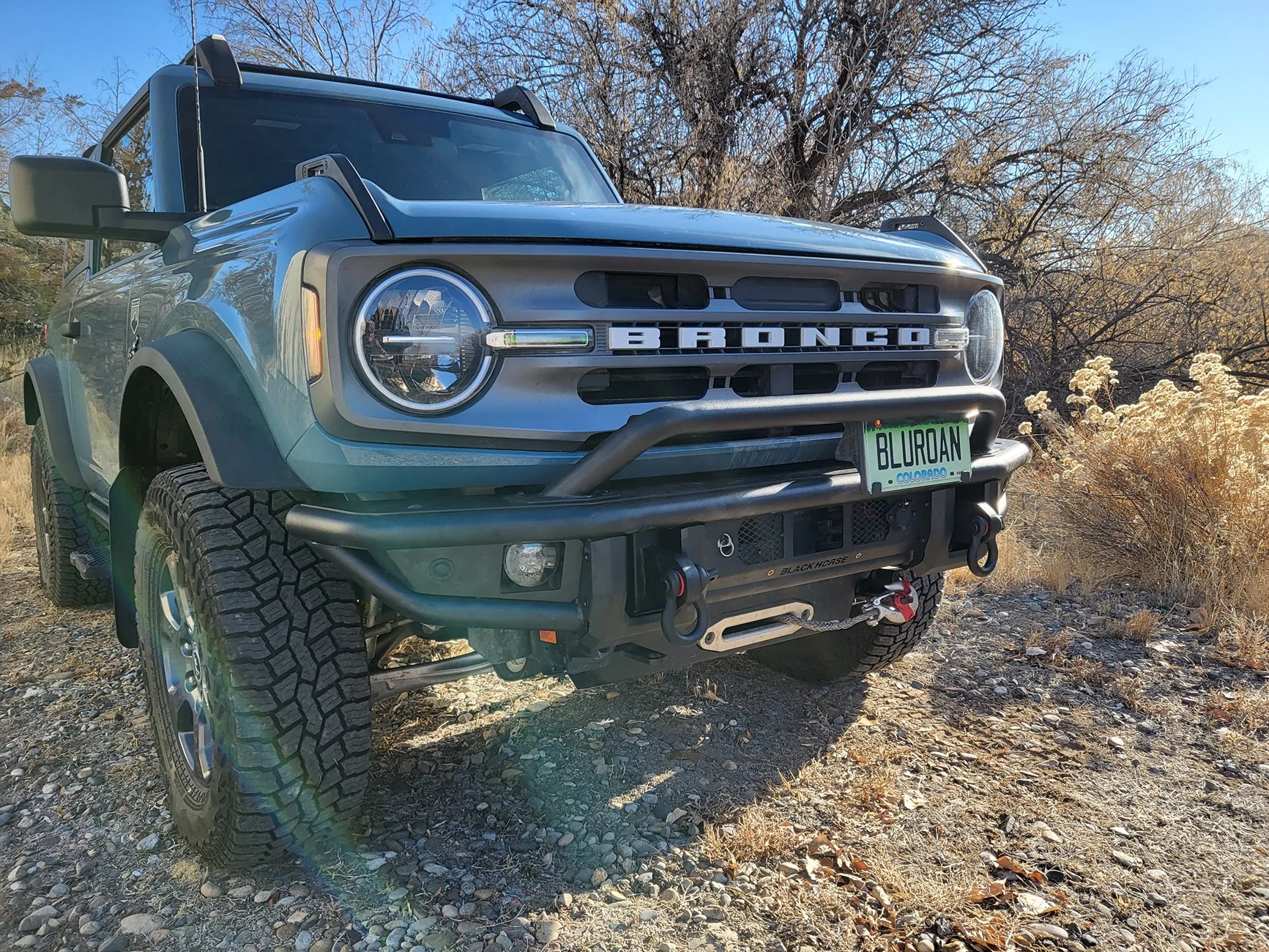

This. Lot's of nose dive, somewhat less with Bilstein 5100s but still there. Really it's the only annoying driving characteristic of the Bronco.
And the dive hasn't changed appreciably, with shock, bumper or winch install.
Ford Bronco Suspension Advice and Education needed 20240101_142454
