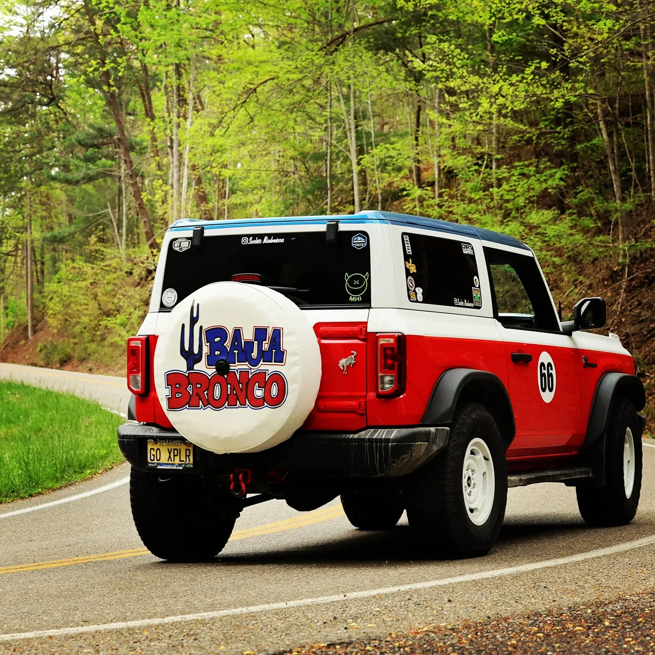

You can find Hoss 2.0 takeoffs at a reasonable price. They firm up the suspension while also offering a more comfortable ride.
I feel that they have the least nosedive of all the factory suspensions.
The tires on yours are undersized for the weight of the vehicle.
When set up better, you can actually hustle these things thru the curves.
Ford Bronco Suspension Advice and Education needed IMG_20240423_211244_082
