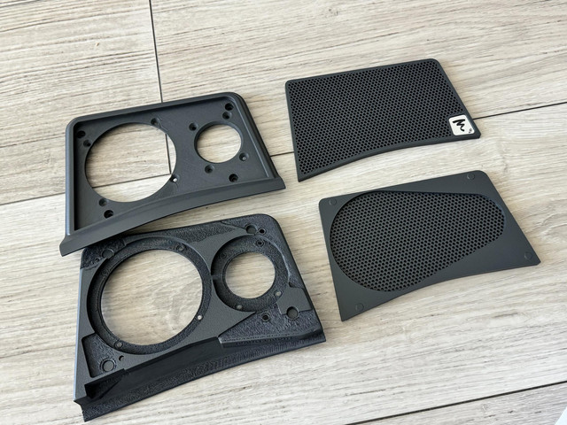

Personally, I would rather talk about sound deadening, integration, installation, headroom, phase, time alignment, proper gain structure, tuning, etc., but here's some older pictures:
Amps are Helix P Six Ultimate, Helix P Two, Helix P One MKII. Subs are Focal SUB 30 KXE's.
Where did you have your kick panel grills made? That is the next thing I need.

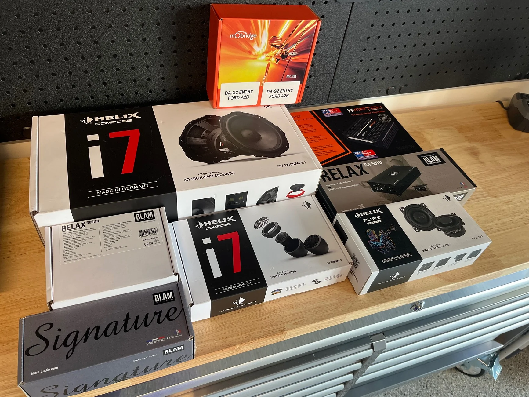

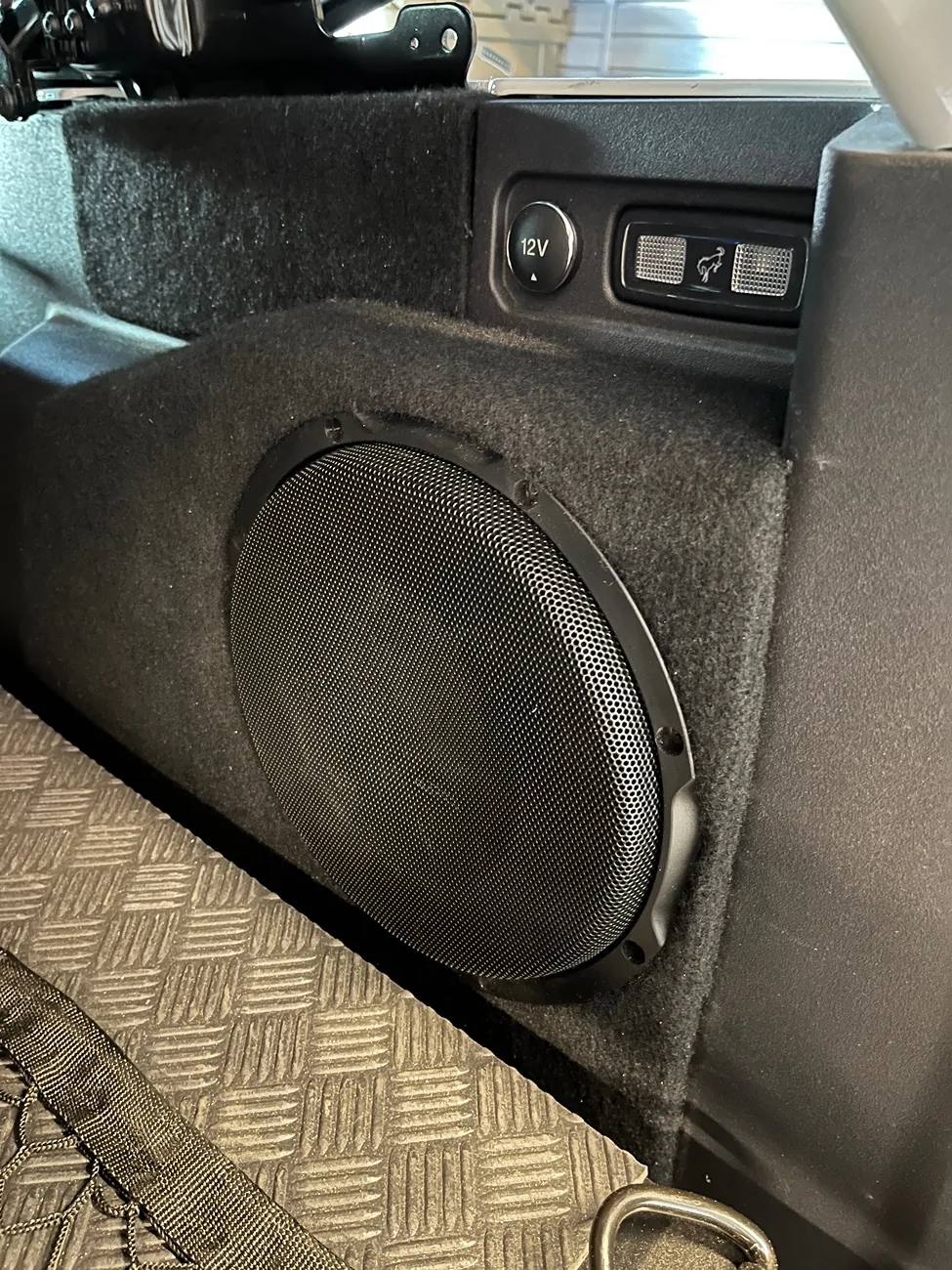

I don’t have my Bronco anymore, but I did have a decent sound system upgrade installed.
I thought I did a write-up on it but I can’t find it on here so maybe I didn’t. I do have a couple pictures of the upgrade and what was installed though. Hopefully it helps.

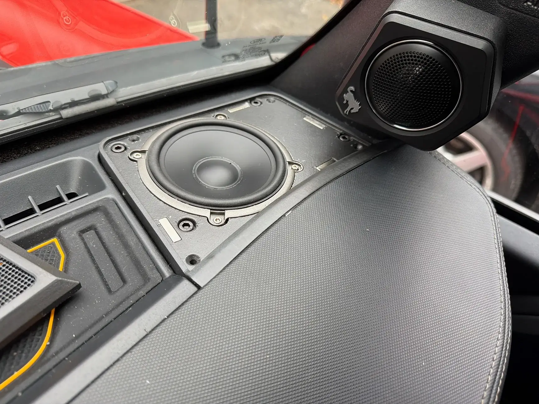

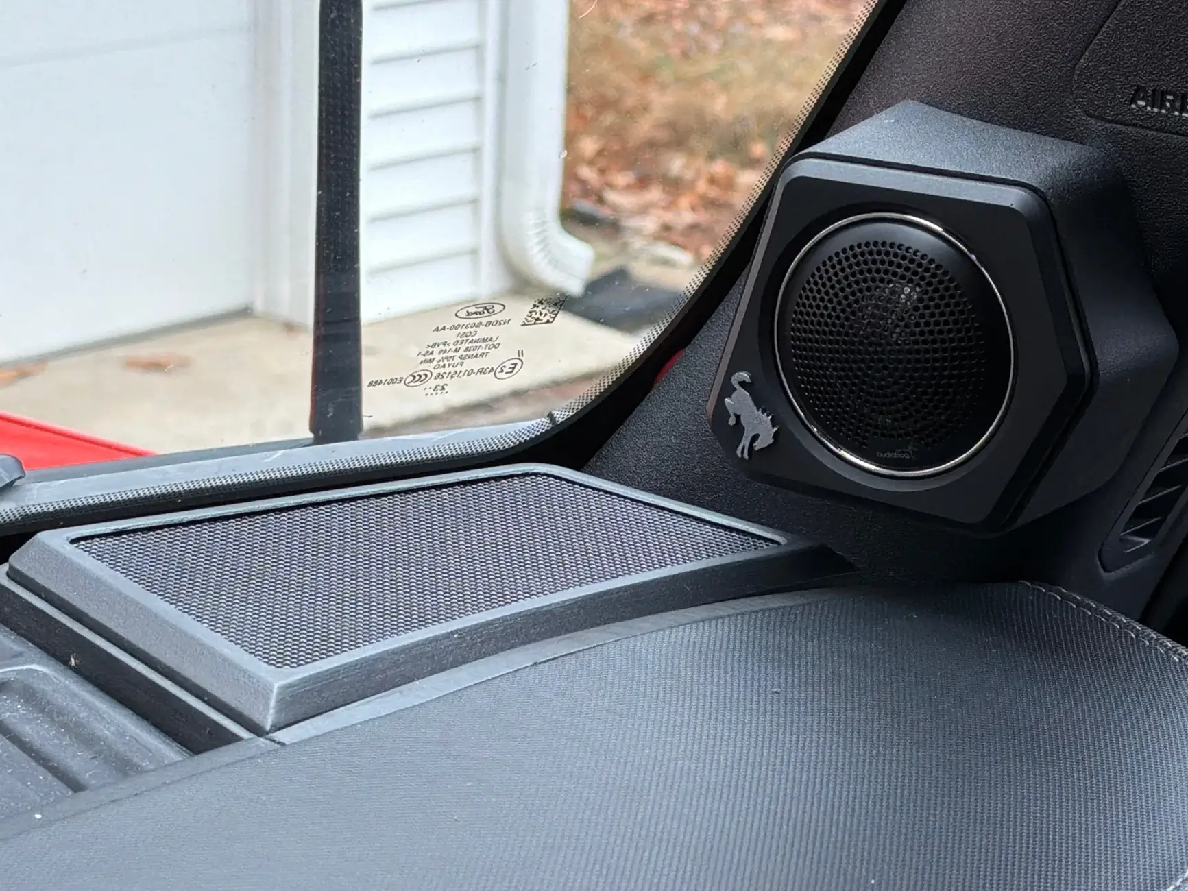

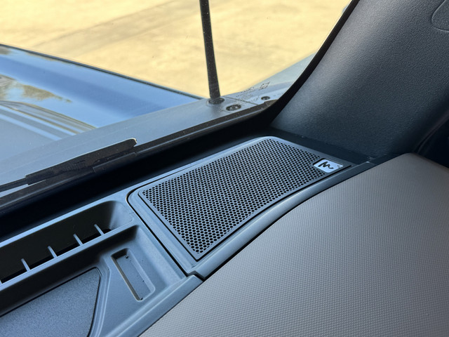

Area51BS
Ron
Sep 20, 2022
237
3,194
5,172
Badlands non SAS 4dr 2.3
I went with pods to stop the glass reflection on my tweeters
Nice. I spent some time in the DSP from 3-6KHz and really tamed the windshield effect down. Staging improved quite a bit and the piercing vocals now sound real. Sometimes you have to just tune by ear.
Do you have any more pics of the sub box
do you have any more pics of the sub box install?
