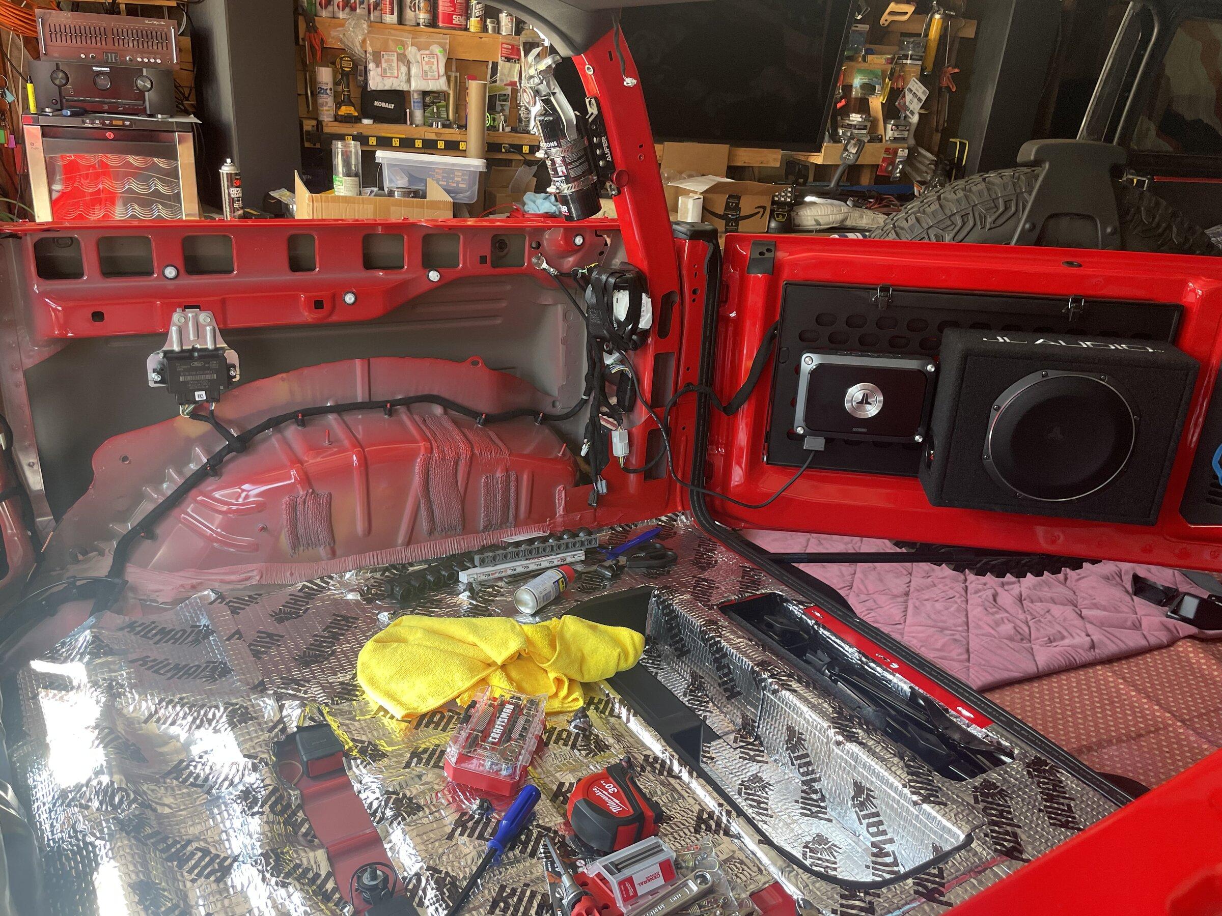

Comes in right at the 3k mark. I also added killmat for sound deadening while I had the rear apart. Takes 3 18sqft kits. Can also add some of this inside all the speaker housings with some floss too. Really helps the sound out. My usual is mat on whats flat I can reach. Floss tight around the sides, then some loose in the middle.

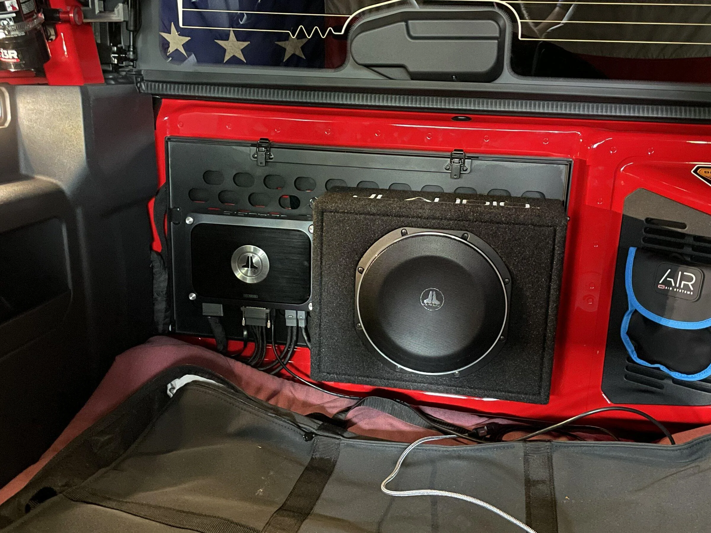

I mounted my amp and sub on the rear tailgate so wire length may very. I mounted both to the tail gate table. Reason I did this is so it can be removed in 5 minutes if wanted. Plus with the amp as far back as can be relocating will require cutting no wires. If I decide I want to drop it behind a panel
I ran individual new wires to all speakers installed. Bypassed all of fords wiring.
To start, strip the interior from kick panels to Ass end both sides. Pretty easy to do. Takes about 20 minutes.
To wire the rears I pulled the plastic air bag curtain covers off, then the rear bar plastic. I then ran new wire across the cage and drilled a 1/2” hole in the side, metals thick, will take a minute. Then dropped both those down so they popped out by the tail light. On the speaker housing itself I removed fords wiring harness. Cut the cone shaped rubber plug down the side to remove the original wire. Then tied a knot in the speaker cable, sat that back into the grommet and reinstalled that back into the rear housings.
Audio frogs were installed in fronts and rears. Front and backs tied together. So that cover 4 speakers on channel 1 and 2. Had to use clips to mount the 4” properly. Channel 3 and 4 will be run to the morels in the kick panels. When mounting the morels you will need to trim the circle plastic on the back of the grill covers. It trims right off with a razor knife, 5 and 6 to the sub.

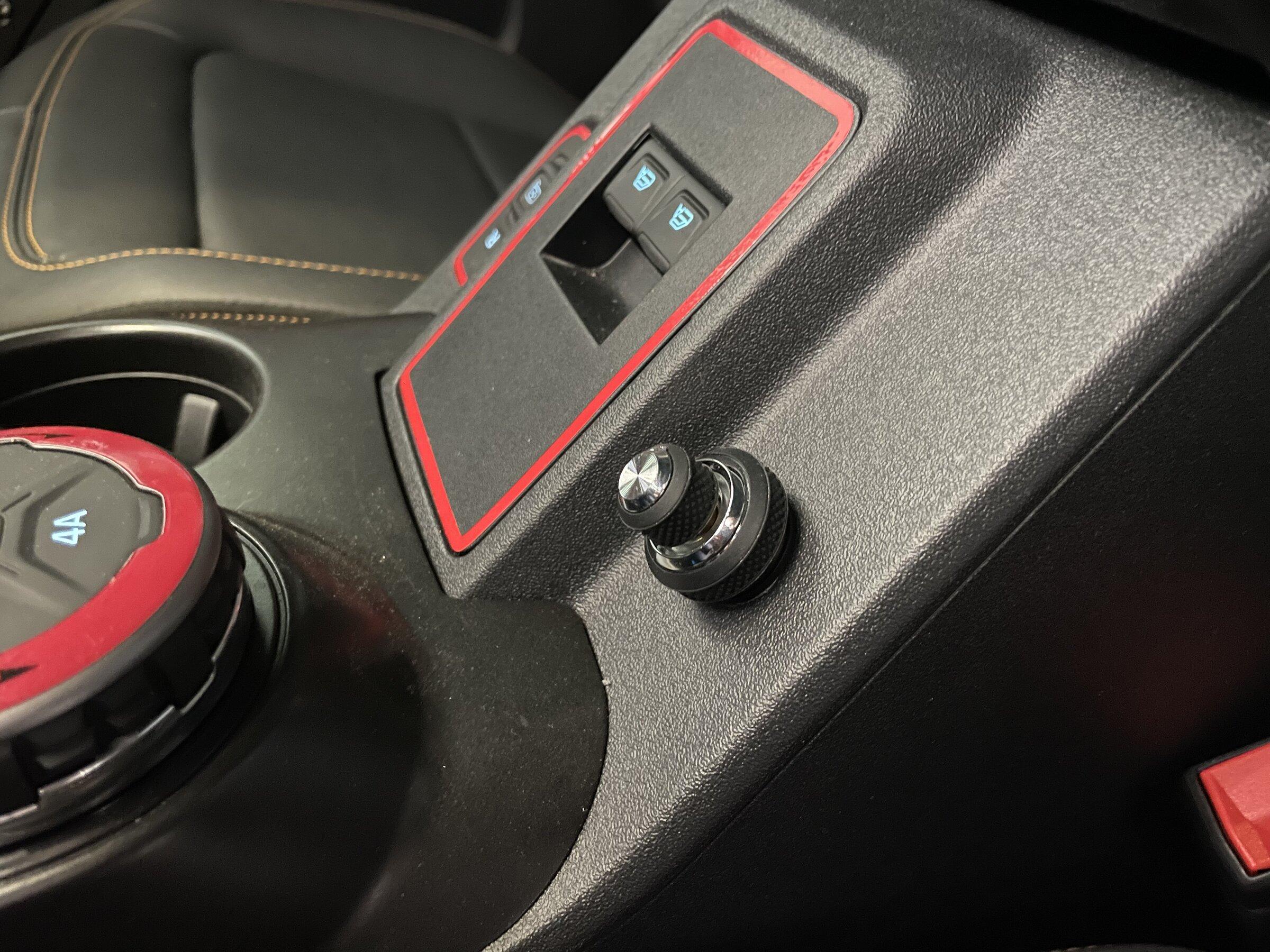

205 (amp remote) is highly recommended to adjust base on the fly. For that I pulled the window switches out, drilled a 5/8 hole then brought the wire in under the rubber flooring into the rear of the console, it’s open under it.

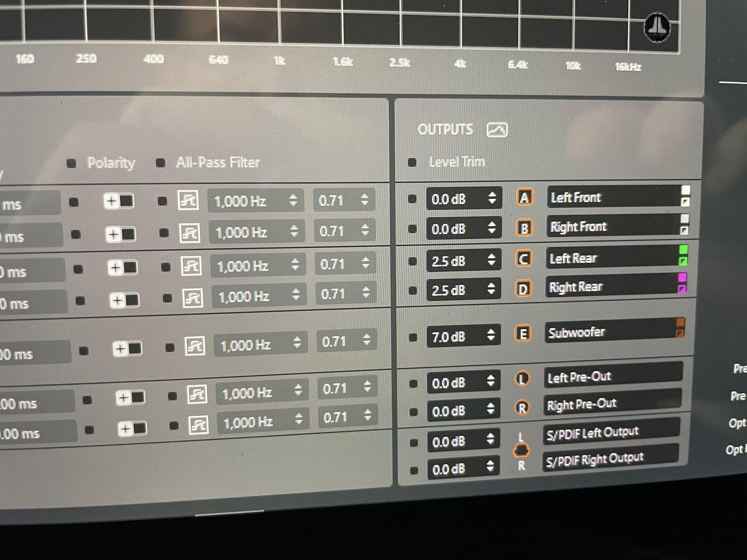

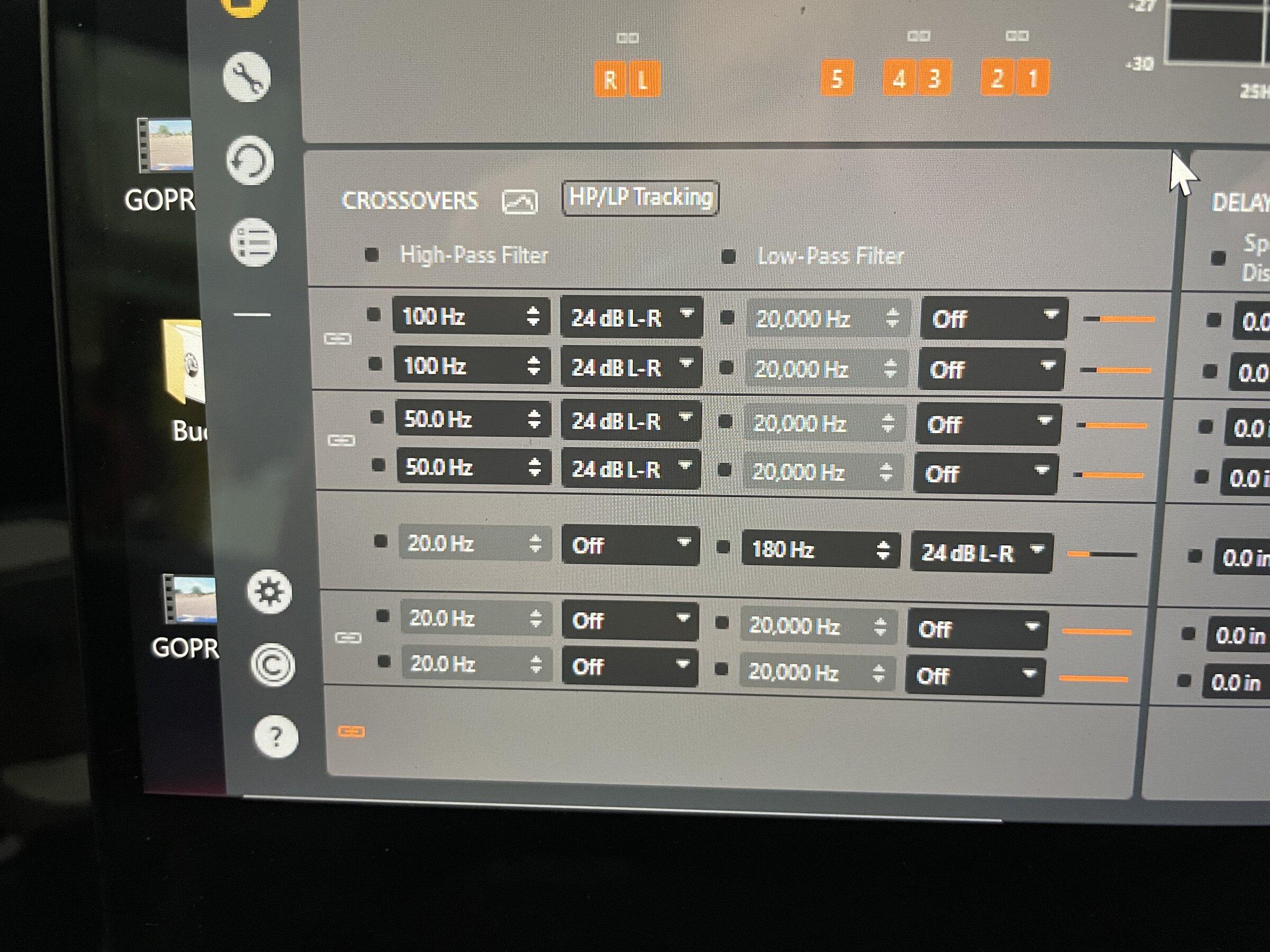

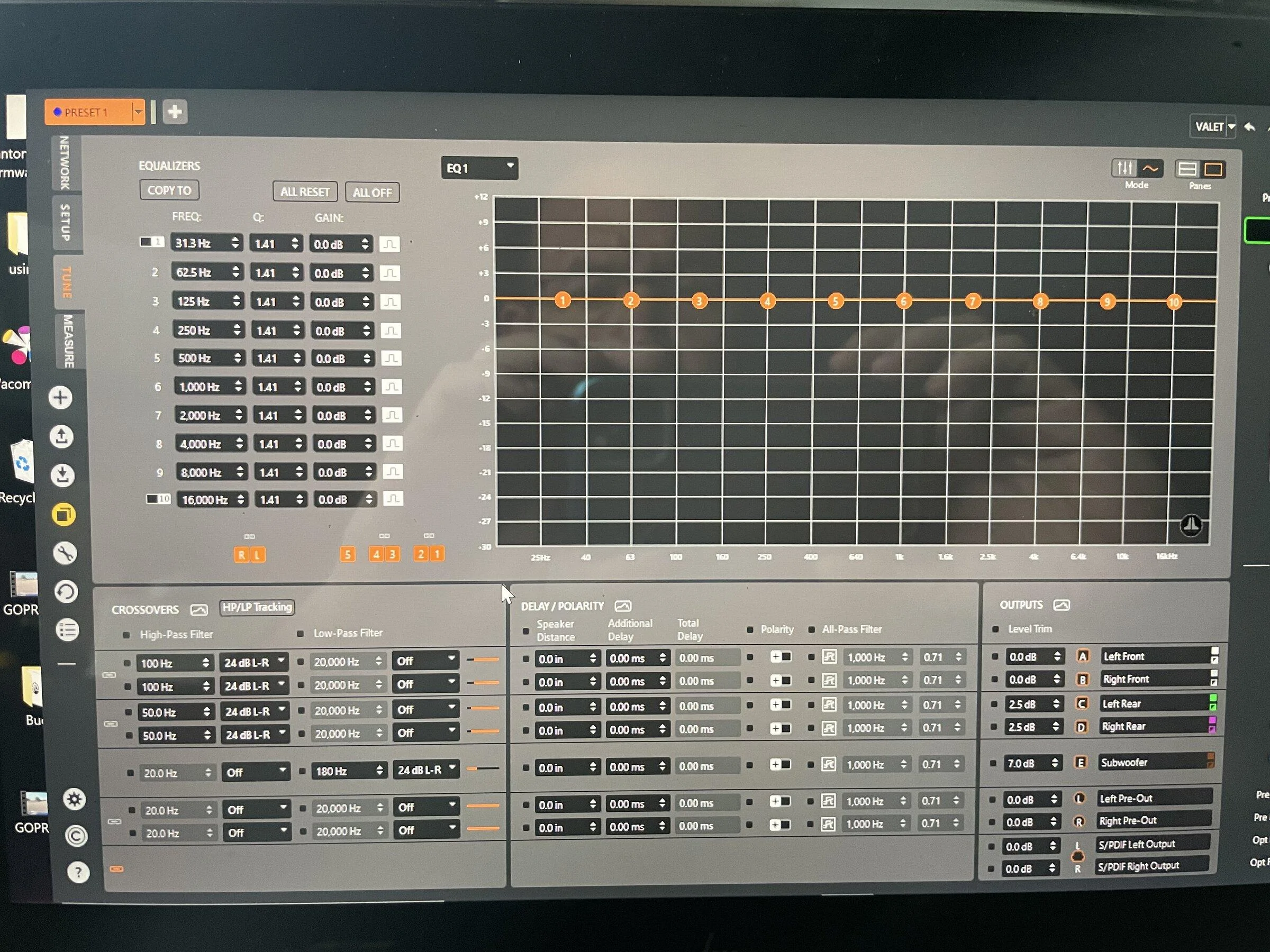

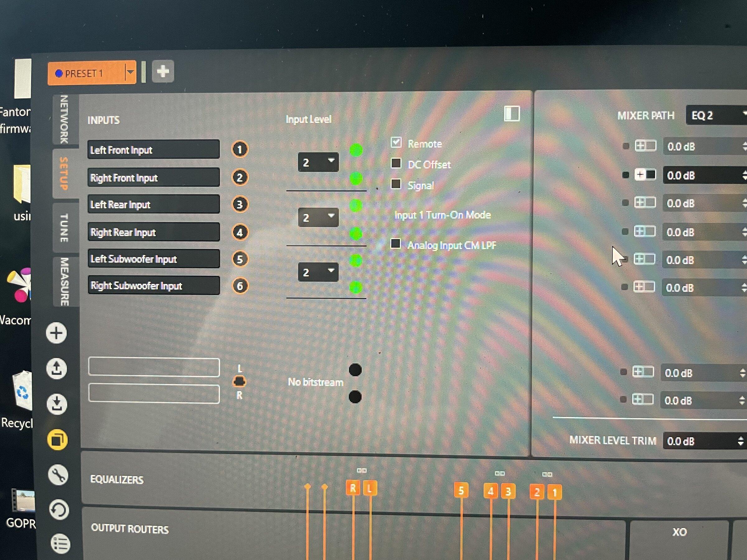

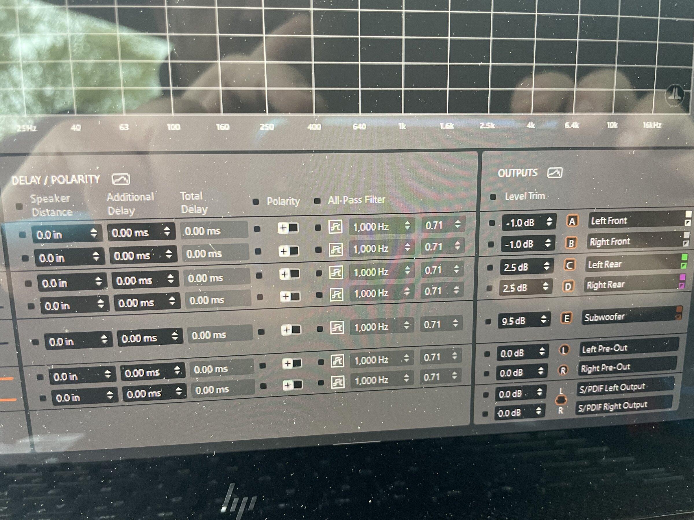

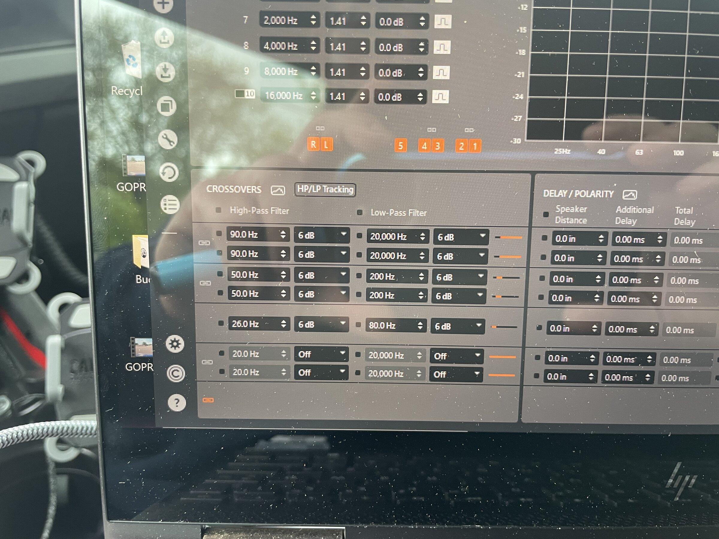

Once that done we’re gonna grab the computer and set the amp up. When it asks select 5/1 mode. In inputs set them at 2 for all 3. Default is 7. This is the strength of the incoming signal. Then match gains and cross over setting in the pics and you should be good to go. Specifically looking at cross over frequency and gain adjustments in the pics.
Also the 205 remote ring color is changed thru the preset button in the top left corner in the tun 4 program. Default is red, select a different preset color to change the ring color. Remember to save to amp after that.
