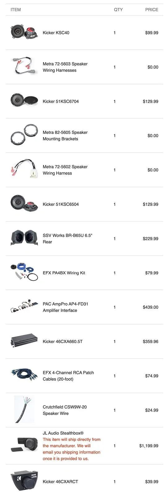

@maricard I'm not sure if this will help you or not, but I recently upgraded my stereo at Crutchfield in Virginia. The new system sounds amazing. These are all of the parts that were used, please keep in mind I have a 2 door so it may be slightly different for you.
Ford Bronco JL Audio amplifier question (high level input) items
